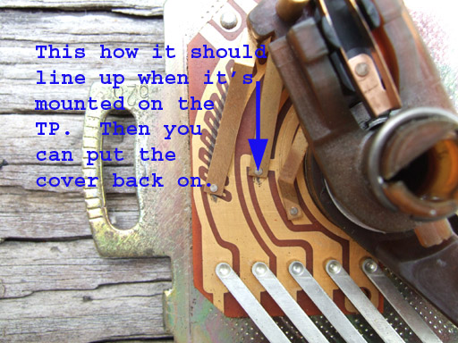

TPS setup...use the pic below to set it correctly at idle.
Idle circuit is special in Djet and you need to activate it by setting the TPS correctly...its a no adjustable thing...basically there is only one right way to set it...its not a variable...use the picture below.
