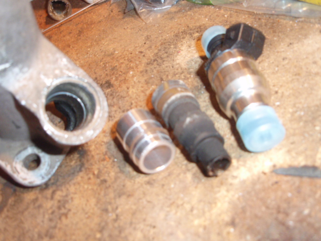

Finally got some time to work on this. One of the first tasks is to remove the old injector bung and change it to one from the kit that is designed for the Accel EFI injectors...
Here's a picture showing the manifold with the old bung removed. You can see the new bung next to it and the old bung. I included the EFI injector to show all the pieces. I need to clean all the pieces before installng the bung.
This weekend, I will have the bungs installed, and will get the fuel rails together..

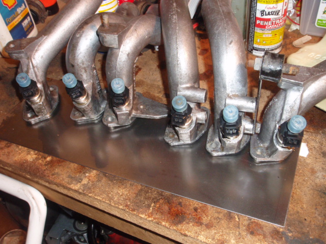

Made some more progress. This conversion should take about 10 -20 hours. It would be quicker if it was a 911 as the conversion is for that. The 914 is somewhat different, and some of the conversion manual does not match.
Besides, I am slow. (IMG:style_emoticons/default/smile.gif)
So, I have all the mechanical injectors removed and the new Accel injectors installed, as seen in the picture.
Next, I need to modify the CIS airbox and install a backfire valve. In addition, I am going to be using a cone type air filter and not the stock filter, so, I need to cut up the box.
-- brett

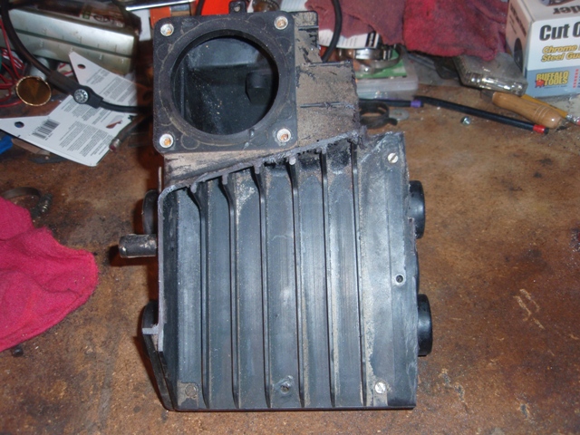

Still making slow progress. Here's the cutup airbox. (I have a spare one, if I mess this one up.) I need to clean up the edges, and general de-grease.
I am worried that the box is airtight. I have a popoff valve to install also.
I have already assembled the fuel rails, and I am going to do a mock up on the bench before I tear the carb off the running motor.
Should be able to make some more progress tomorrow.

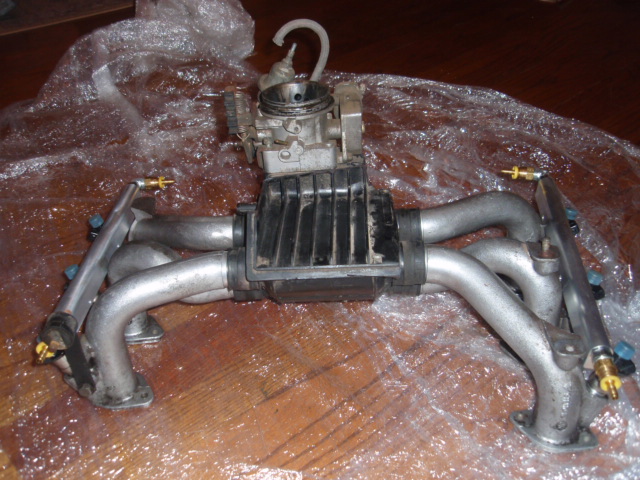

Made some more progress today. (Still need to do the cleaning, etc.) This is a very basic mock-up of what it will look like. I placed the fuel rails near the injectors to give a general view. (Carb will need some major cleaning.)
So, next step is cleaning, and then I can assemble everything prior to going into the 914. I will do the fuel lines once the EFI is in the car.
I am working on pulling the seat out now, to put the control module inside the cab.
