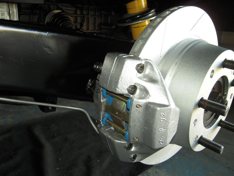

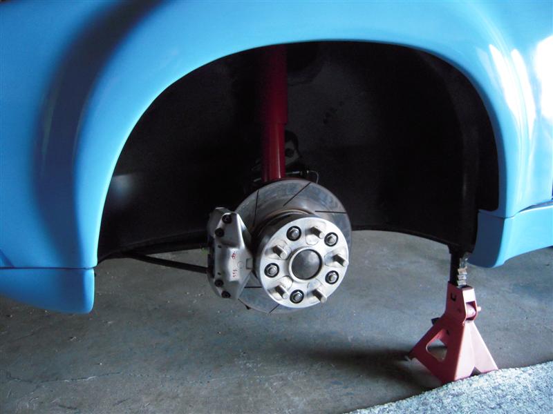

Brake Update Pictures of the front and rears, thanks for all your advice. Wide A calipers in the front, M calipers in the rear (38mm), with T installed and adjustable proportioning valve.
steve
Racing916
post Dec 4 2009, 06:59 PM
Post #29
Posts: 341
Joined: 16-October 04
From: Binghamton, NY
Member No.: 2,959
front
Racing916
post Dec 4 2009, 07:00 PM
Post #30
Posts: 341
Member No.: 2,959
rear

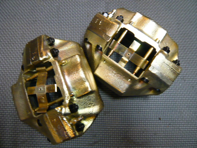

So is it worth it, and is it possible to get the rear m calipers & remove the spacers and make them "non vented" and use 914/6 solid rotors? Minimizing weight and keeping correct bias with front A calipers.
Eric_Shea
post Feb 24 2010, 09:44 AM
Post #35
PMB Performance
Posts: 19,304
Joined: 3-September 03
From: Salt Lake City, UT
Member No.: 1,110
So is it worth it
Andy, in Steve's situation... maybe. In most, no.
I agree with your 914-6 rear rotor assesment. And yes, you can take the spacers out and have them fit on a 914. Very nice set-up for a track car that doesn't need a handbrake or, a street car with a different handbrake solution.
You get:
38mm pistons - Same as the 911, 911RS, 930 (early), 914-6 and 914-6/GT. These bias well with any 48mm front pistons (M-Calipers, A-Calipers, S-Calipers, Brembo 3")
Large #31 pad size - Same as the 911, 911RS, 930 (early), 914-6 and 914-6/GT. Again, these balance well with any of the following fronts - M-Calipers, A-Calipers, S-Calipers, Brembo 3"
Slightly less rotating mass with the solid rotor in the back (as you mentioned).
Biases well with the A-Calipers (as you mentioned).
I have a set of those exact calipers sitting on the bench right now.
