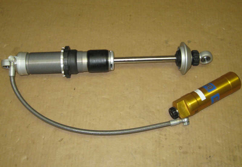

QUOTE(Phoenix 914-6GT @ Oct 20 2009, 05:35 AM) *
QUOTE(Racer Chris @ Oct 19 2009, 08:16 PM) *
I'm going to install Ohlins LMJ 7" stroke shocks at the rear of my 914.
And just how are you planning on doing this (IMG:style_emoticons/default/idea.gif) . Love to see that Chris. (IMG:style_emoticons/default/aktion035.gif)
Here's one of my new rear shocks,
and a lower mounting bolt. Its a stock unit, modified to fit the 1/2" monoball in the Ohlins shock.

Chris I just love the way you fixed the rear shock bolt. That's some spiffy machining considering how hard them bolts are.
ChrisFoley
post Dec 13 2009, 06:19 PM
Post #48
I am Tangerine Racing
Posts: 8,019
Joined: 29-January 03
From: Bolton, CT
Member No.: 209
They machined nicely. I used my old worn out P&W lathe (which chatters real easily) that was built sometime around WWII and took only about .030" off the dia. per cut with a carbide insert.
I had originally designed them a little more ruggedly and was planning to have them made them from scratch using 42L40 or the same pre-hardened stock I use for trailing arm pivot shafts. When I realized that I could simply modify the stock bolts it became a lot easier to accomplish on my own.
The sleeve I welded on came from the bottom of a KYB shock that we cut up for the lower perches.

(IMG:style_emoticons/default/popcorn[1].gif) ...Chris ...I have a set of CARRERA shocks very similar to the ohlins. There is a "srader valve", air inflator valve at the bottom of the shock absorber, where your pressure line is. They have a 5.5'' stroke......my question is , how will you adapt the top mounting heim-joint to the O.E.M. top shock mount...and where do you "recharge "the cannister, I don't see a fitting....a suggestion as to springs/ rate would be appreciated..( stock street 914 about 2100 lbs.1973..2.o)....murray... (IMG:style_emoticons/default/popcorn[1].gif)

QUOTE(ME733 @ Dec 14 2009, 10:17 AM) *
similar in that they have a threaded body and are nitrogen charged...
You can but adaptors for about $200 from The Racers Group, Rebel Racing, and probably others. I don't have oem shock towers so I will be making something myself.
There is a fill valve on the end of the canister that you can't see in the pic.
140-150 lb

QUOTE(Racer Chris @ Dec 12 2009, 01:18 AM) *
Those look great Chris, but what shocks will need to be run on the front? I'm currently running Koni yellows, but haven't changed anything else other than the sway bar (smart racing). Have the Koni's revalved or what do you think?
