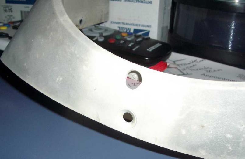

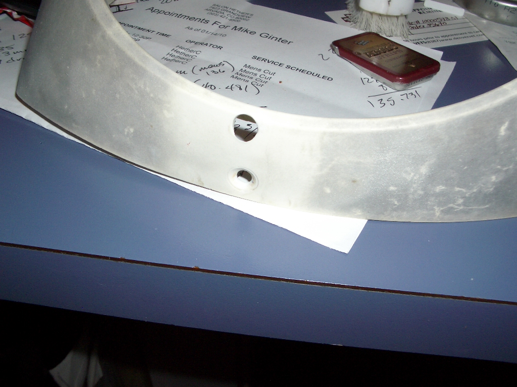

This actually took 5 minutes or so. Plain old Costco baking soda. I had to turn the pressure up to 60 psi as my soda has absorbed a little moisture and didn't really want to come up the tube. Food grade baking soda is actually a little too light for this application I think. Although it removed the discoloration, there are a couple of little marks that you can see it didn't remove. The blasted area is really very smooth, although I can feel a little... tooth. Not much though. Like 600 grit sandpaper tooth. Give or take.

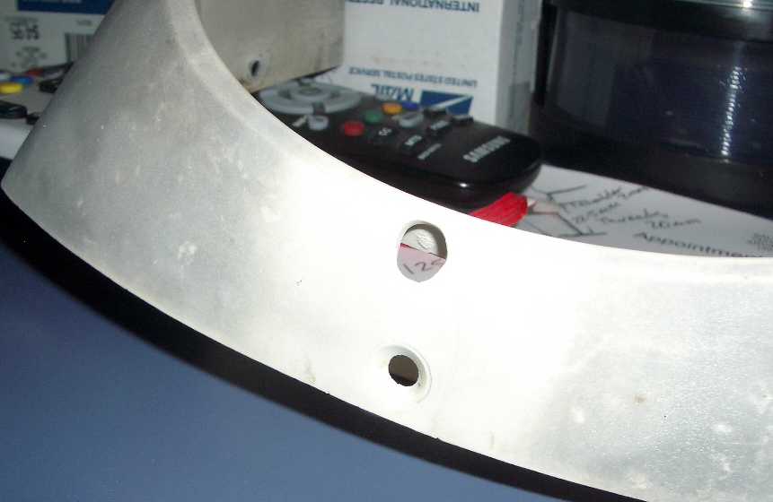

Better pic?

Usually when you abrade flexible plastic, it gets "fuzzy"
That is , the ends of the long chain molecules in the plastic become broken and loose.
