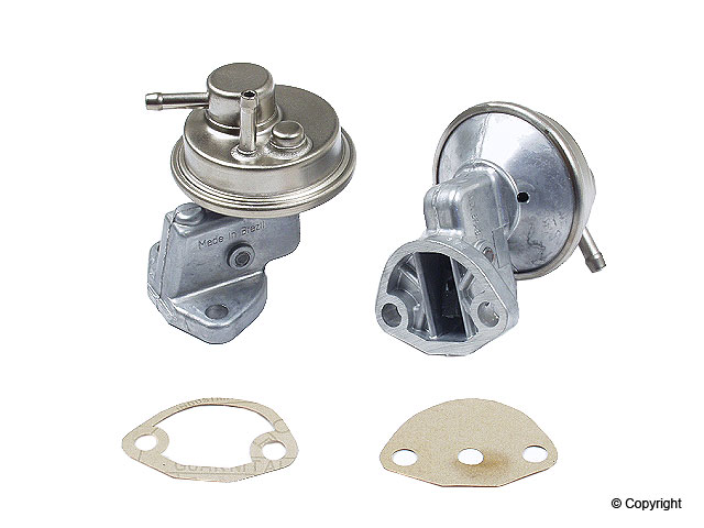

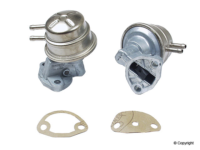

The generator pump (below) requires the longer push rod. Note the actuating lever is higher up inside the pump body (on the bottom)
The alternator style pump uses the shorter push rod. As the Cap't mentioned, you use the long rod with this pump and you'll get one good pump and it'll break on you. Note how the actuating lever actually comes below the base of the pump body. On this pump the upper nipple is the INLET and the bottom nipple is the OUTLET (it's the opposite of how you would logically think they should go).

Actually, there are early and late "generator" pumps. Early ones take the long pushrod, later ones the short one. The "alternator" pumps are canted over like the one pictured, and they always use the short one.
Another thing to look for is whether opr not the pivot pin is locked into place. The old pumps had circlips, the late manufactured ones don't, and the pin slides right out after a few weeks or months. Bad news. The last one I bought had a "fix" designed. Unfortunately, I forget what it looked like ................. I've been hitting the ends of the pin with the mig welder.
