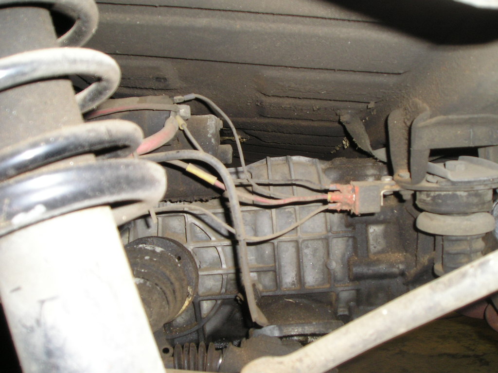

You can see where it is bolted to the underside of the trunk floor in this picture. Upper right corner of the picture. (ignore the relay)Attached Image

No pic right now (i'm at work) but one end goes to one of the bolts on the end cover and the other to a stud on the bottom of the trunk floor.
The stud is above the center of the tranny towards the rear end cover. The strap is pretty short, 5" maybe ...

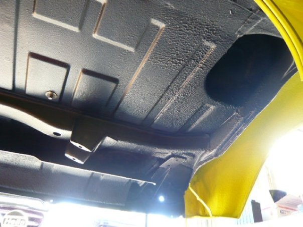

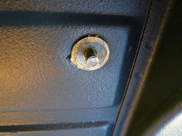

I went crazy with mine and cleaned it and taped it off before I shot the Wurth. This has to be a good ground:
(IMG:http://www.914world.com/bbs2/uploads_offsite/sphotos.ak.fbcdn.net-1110-1271799276.1.jpg)
You can see the stud in relation to the tranny mounts better here:
