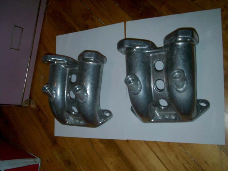

No experience with this kit but i would think the injectors are in the wrong spot. They should be on the bottom of the intake runners and squirt directly on the back of the valves.
I had these made by Staggs Racing:
(IMG:http://www.914world.com/bbs2/uploads/post-18-1144130834.jpg)

QUOTE(SirAndy @ Apr 21 2010, 03:17 PM) *
QUOTE(Root_Werks @ Apr 21 2010, 02:56 PM) *
Worth anything? $1800 seems spendy, but you get modern tune-able FI with 4x48mm throttle bodies. That seems cool. Plus it's all done, not much farting around with looking for parts.
Thats what I want, with the GXR throttle bodies!

I thought the same thing, even the factory FI has the injectors pointing directly at the intake valves.
I guess keeping the injectors in the TB's keeps the parts a little more universal?
When are you going to ship those to me?

QUOTE(Gint @ Apr 21 2010, 03:45 PM) *
I knew you were going to say that! (IMG:style_emoticons/default/biggrin.gif)
I just came across them in my closet this weekend and realized i had forgotten about sending them to you ...
(IMG:style_emoticons/default/rolleyes.gif) Andy

48's seem awfully big. I've got 45's on mine and it is just shy of 2.4 liters. Get them too big and throttle response will be poor and it will be hard to tune. My injectors are in the throttle bodies and it seems fine to me.
The old stock injectors ran at 30 psi and the pintels didn't vaporize the fuel as well which certainly would favor pointing them right at the intake valve.
Dave
