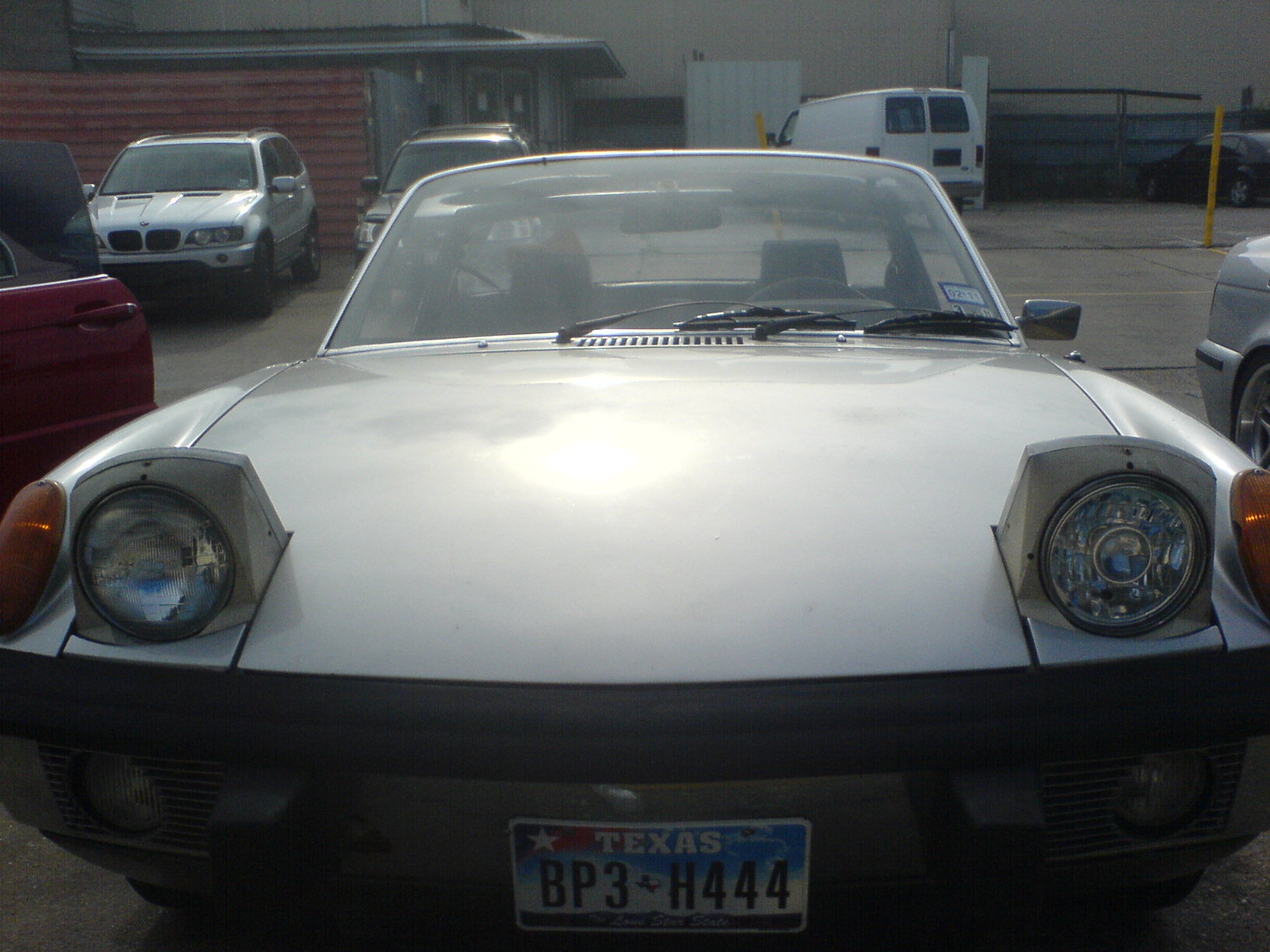

Hey guys, i was at my friends shop and i was talking to him about HID's and how i couldn't put them on my car and then he introduced me to these headlights. They have a projector, and he said i can pop the bulb out and put HID's in it. What do you guys think about these? I put a LED in the engine bay and the interior lamp in between the seats. I have the Sylvania headlamp on the left and the projector on the right.
Mike Bellis
post Apr 18 2010, 01:58 AM
Resident Electrician
Posts: 8,348
Joined: 22-June 09
From: Midlothian TX
Member No.: 10,496
You can put HID's in your car without the projector. You need an H4 lamp assembly. I had them in my 911. You can even find High/Low HID's to fit the H4 style bulb.
I dont really care for the projector you have pictured.

Running HID bulbs without a correct projector like you said you have done on your 911 is down right dangerous to other drivers. (IMG:style_emoticons/default/mad.gif)
I think the projector installed in the 7" round light is legit. Just aim it right and you get 100x better night vision.
Nice work!

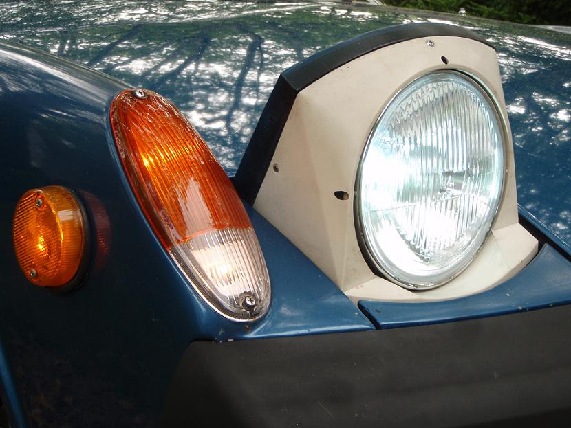

Actually if the HID unit is set up correctly, it should be no more dangerous in a stock H4 than a projector. I have a similar (if not the same) projector lens like you have on your rig on my 951, I like it. The stock was a sealed beam and I picked up a pair on EBay for $30. The only thing with that type of lens is that it's not a true projector lens. You get refracted light out the sides of the lens that goes out in a larger cone. You can see the edges of the lens "cone" way outside the projected beam.
The issues with the HID units I have found is that some only have HID on the low beam (stay away from this) as you'll never use your high beams and if someone flashes you, you look like a chump for turning on your high beams, that seem much less bright, but now are higher.
If you get the high / low HID units, the HID slides up and down simulating the angle for the high and low beams. This is the best as it will not hit the oncoming driver with the "high" beam, that's really not as bright.
I had brought in a few of these with the idea of reselling them, but the problem was they are kind of a pain to instal, and the flickering issue. You have to allow for the wires to the ballast, and mount the ballast. I also found in my testing that over time and with moisture you will get "flickering" I have found this with 3 different manufacturers.All of them clained to be water tight, with pictures of thier units operating under water and impressive tests to suport the claims, but they all performed simularly. This is probably more a function of the moving bucket assembly in our car and the 951. The good news is that it will fault out and can be reset.
Don't get me wrong, I liked them on my 951, but they're not real easy to mount. They are pretty inexpensive, the hi / lows can me gotten in the $65 range. And they do typically run on 35w, so no need to rewire for additional wattage.

I disagree. My HID's are brighter, not dangerous. If you don't know how to aim headlights they may be too bright for oncoming traffic. I do know how to aim head lights by following factory specs. If the light still looks to high, I can lower it again. The lamp light angle will change by installing different lamps as the length from the rear of the lense to the filiment is different. Any time you change a headlamp they need to be re-aimed. If a person does not know how to aim, there could be a problem. Most aftermarket projector lenses have very poor optics. They will not necessarily give you any better light. the only consistancy between them is the light shield that gives you that "line" of light on the horizon.

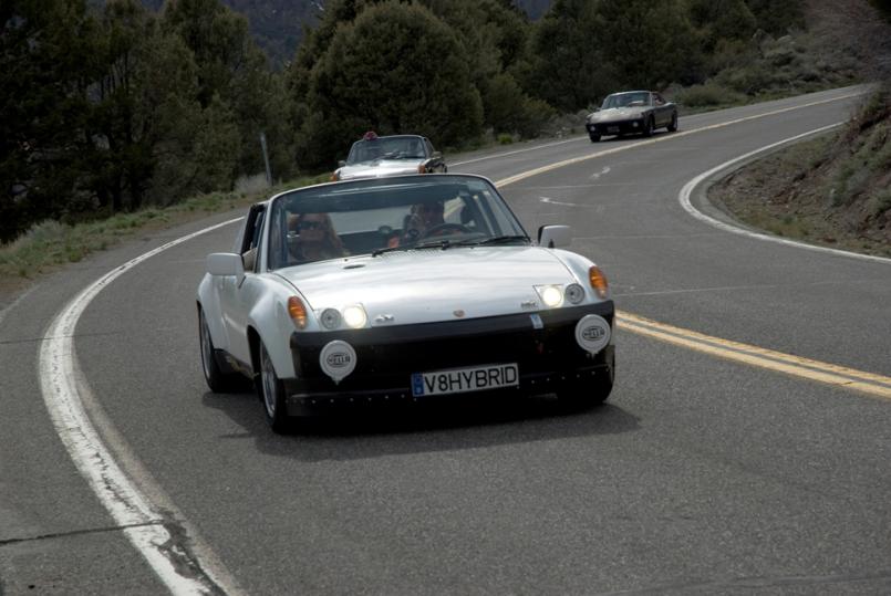

I like them, Stock lights suck, anything brighter is an improvement.
I have the camp 914 fog lights and they are 10 times brighter than the stock headlights. I use them for the head lights most of the time.
Where are the kits avail?

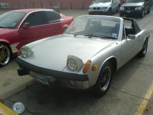

Here is Acura TL Bi-xenon projector output on my 914.
Click link--> 914 TL projectors
This video is not the best as you can't see the real world driving improvement, however you get the picture.
My 914 came with no headlights, so these were a "fill in" while I figure out what to do as a final solution.
Matt

I have a complete 914 headlamp system if you need it. Not sure what its worth. I removed mine to install custom headlamps. I'll have to bring it by so you can see it. If you find the thread "lets see your 914 headlights on" or what ever it was called. you will see multiple posts by me of my new headlights. Here's one of my fovorite pics..

Do yourself a favor and buy the Bosch H4 headlamps from Bus Depot, they are made in Germany/Sweeden and a CRAZY good deal while they're still on sale at less than $50.00 I just swapped mine out 2 weeks ago and they are much brighter, look better because of the almost flat glass (hence the reason they're referred to as "flat" 7" headlamps) and because they're technically a DOT approved motorcycle headlamp the spread of light is wider. The bulbs are also only $4 each and made in Germany! (IMG:style_emoticons/default/biggrin.gif)
LINK: http://www.busdepot.com/
Also, compared to other H4 headlight assemblies I've handled the Bosch units were sturdier than Hella, and had a much tighter rubber boot sealing the back of the headlamp.
