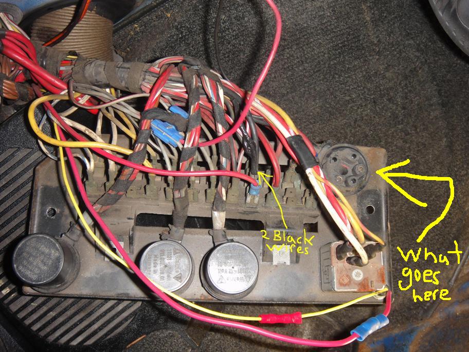

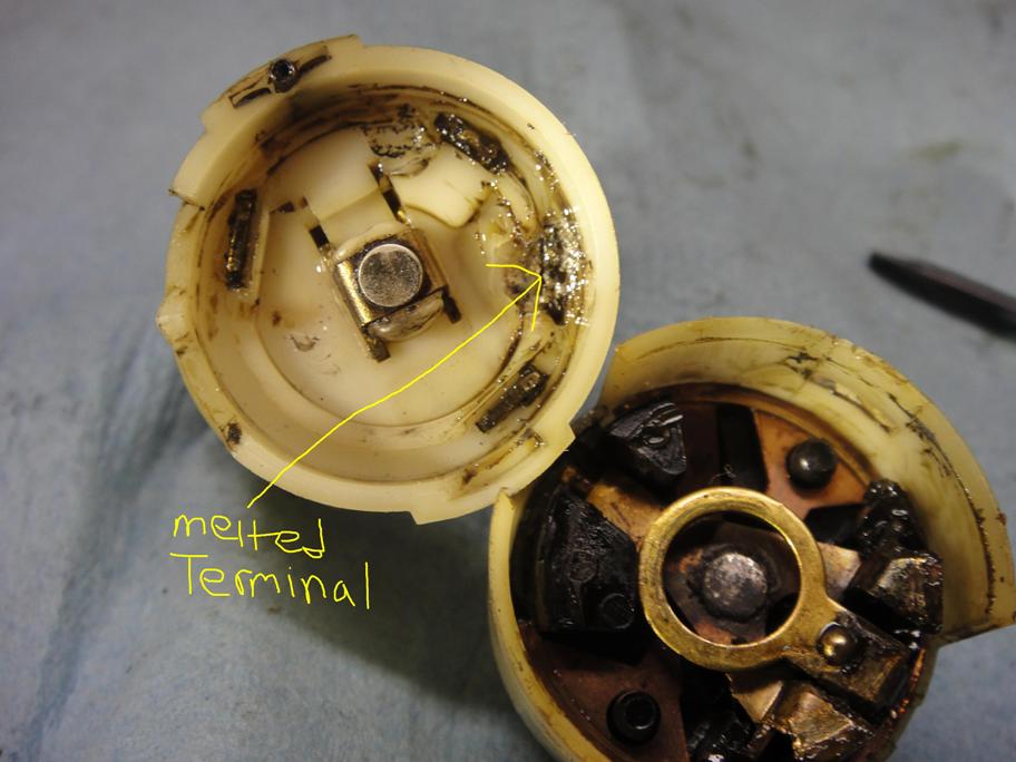

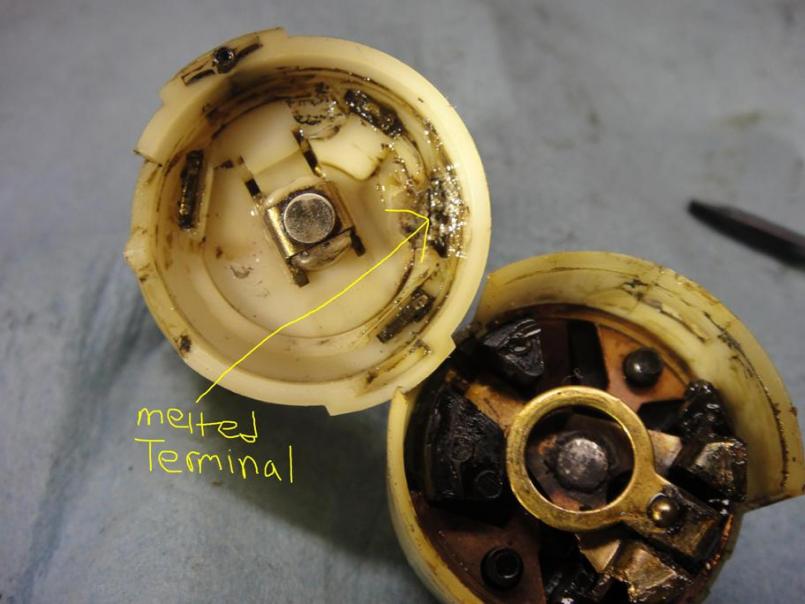

Well, last night i was able to find the problem in my wiring. Actually it was in the ignition switch not the wiring, although I do need to replace several wires as well. All of the wires checked out good up to the fuse board, but i wasnt getting any power to the 2 black wires on fuse ""8"" when turning the key on. Testing each wire individually i determined that they were all good, but i was getting no power from after the ignition switch. I decided i had to pull the steering wheel and get the ignition switch out, so i did. I disasembled the switch and was able to see where the contact had gotten so hot it melted back into the plastic and away from the contact. Attached Image
One thing that i was quite confused by is that the 2 black wires that are supposed to be running to the hot side of fuse 8 are going to fuse 9. I was able to pick up 12v on fuse 8 when i turned the igniton on, but the 2 black wires have always been atatched to fuse 9 since i have owned the car. You may be able to make this out in the picture. Also, what is the empty relay port for?? Can anyone make out any other wiring oddities on my fuse board? There have definatly been wires added in the past. Attached ImageThanks
