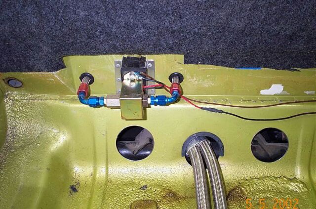

Here is the front location of a Facet pump. Eventually changed to a rotary. Needs to be mounted with rubber insulators. I used a pair of 914 fuel pump insulator rubbers.

I also found a fitting for the Facet to take the loop out and have it run straight back. No pic of that.

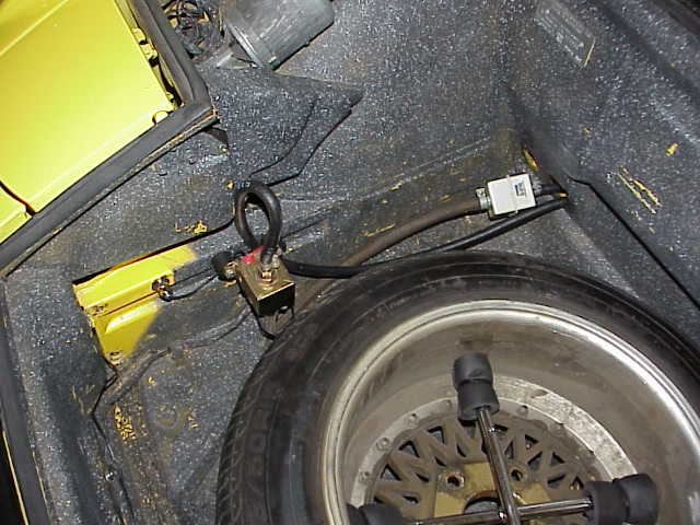

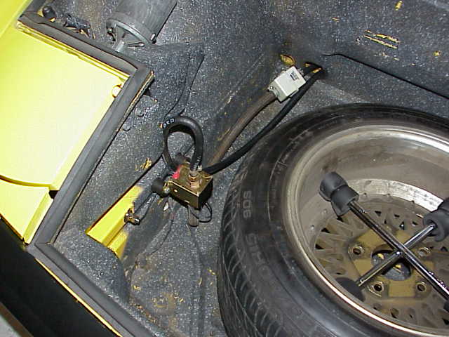

A facet should fit real nice right here (stock location for a 75/76 fuel pump) even with a bar -- note the brake lines for a reference point -- this is on the drivers side fo the car. The bar is above the hole.

Next to the spare tire is enough out of the way. There's enough room even with a stock spare held in place. The extra line is not a problem with performance, etc. While moving the pump is not necessary. I like the fact that when my lines were lose, it shot fuel out of a place I could easily get to. (IMG:style_emoticons/default/wink.gif)

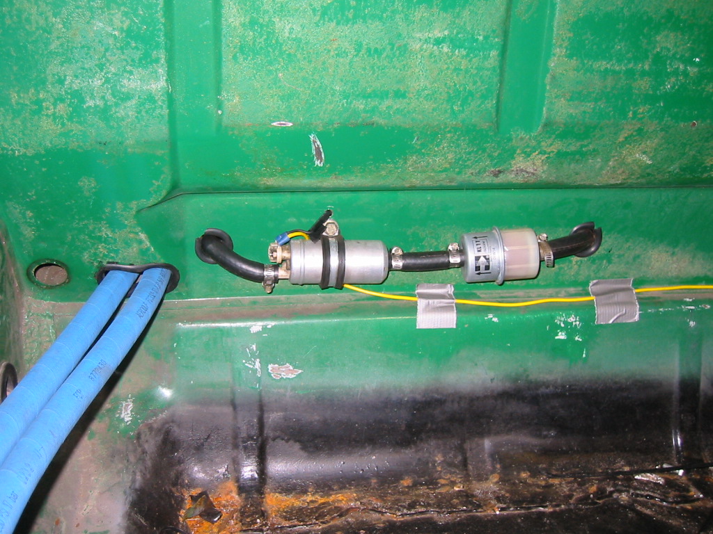

Here is how I did mine:
(IMG:http://www.914world.com/bbs2/uploads/post-2-1070519251.jpg)
Its a low psi rotary pump for my carbs.

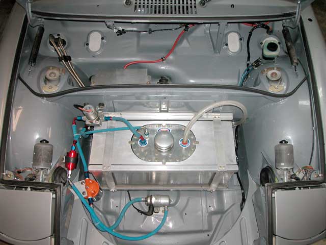

Here's mine.

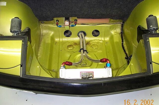

We gots coolers too
