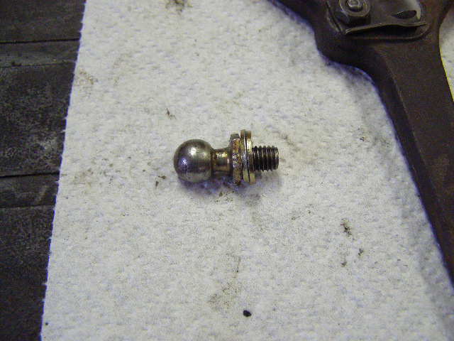

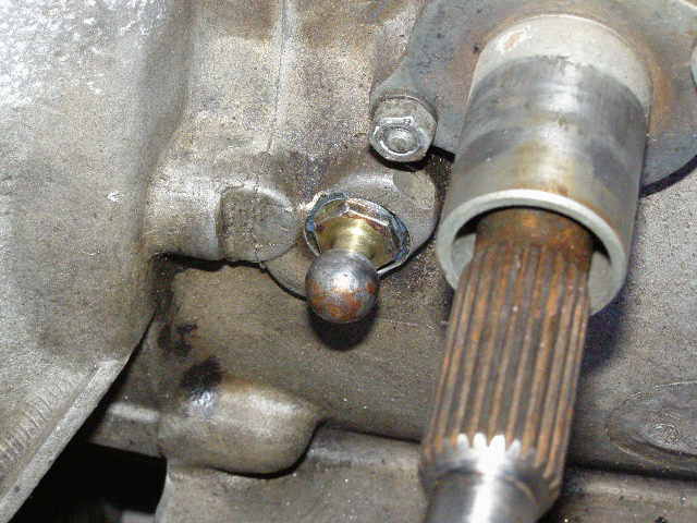

i think it's to put a washer between the pivot ball and the tranny case to get the fork clearance.

The fork pivots on a ball and there's a bushing that goes in the fork lever. Did you change the bushing? I think this is where the washer goes, behind the bushing. If this is incorrect, hopefully someone will chime in.

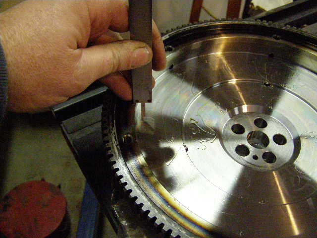

You bought the flywheel from AA. Did they bother to give you the measurement of how much the flywheel was cut? If it is to deep, it won't work (they should know that). It also needs to be step cut to maintain cover / disk relationship. I don't have the specifications anymore.
I have seen them cut to the point where the flywheel bolts had to be ground to clear the friction disk.

Still sounds like the clutch fork to me. Did you get a washer behind the ball it sits on? It is basically a little bolt with a ball on it. You just unscrew it & put a washer behind it. Then screw it back in. You just aren't getting enough movement. Unfortunately you do have to have the tranny off to do it. Unless you have some amazing tools I haven't seen. Sounds like you are used to pulling it though. Just pull your tranny again & pull the clutch fork off. Then pull the ball & add a washer behind. Have a few different thicknesses available. Seems like it is a 13mm bolt but I'm not positive on that. Takes a wrench as the ball keep you from using a socket. Start small & work your way up as needed. Doesn't take much to get the clutch fork out so it can pivot without running out of room. Hope that makes sense (IMG:style_emoticons/default/huh.gif)

Ah, the washer goes BEHIND the ball, in the tranny housing!
that soundsgood to me, I'm having trouble getting the ball out, cant get a grip in the flat surfaces, and havent got a tool that would fit around it in that tight of space.
and, yes. My old flywheel was pretty well blued, scored... so new one is probably staying. and I dont recall a measurement.

Like others say you need to put a washer under the pivot ball. A thin wall socket is needed to remove the pivot ball. I have a "special" socket that I ground down to fit.

I had a problem with the clutch not wanting to disengage, it was the fly wheel depth. Measure the depth of your old fly wheel compared to the new one. I don't remember what the maximum depth is before you loose the ability to disengage the clutch. I also shimmed the ball with a washer. I had to take a socket and grind down the outside diameter to get it to fit.

I think normally you shim under the bushing that presses in to the case. I could be wrong, but that's what works for me.
