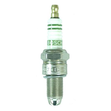

I gave part numbers, if you like Bosch coppers, you'll love these:
http://shop.advanceautoparts.com/webapp/wc...ci_sku=25964618
You can get them in 7's or 8's depending on FI, carbs and driving habbits. I've run them for 20+ years, love them.
