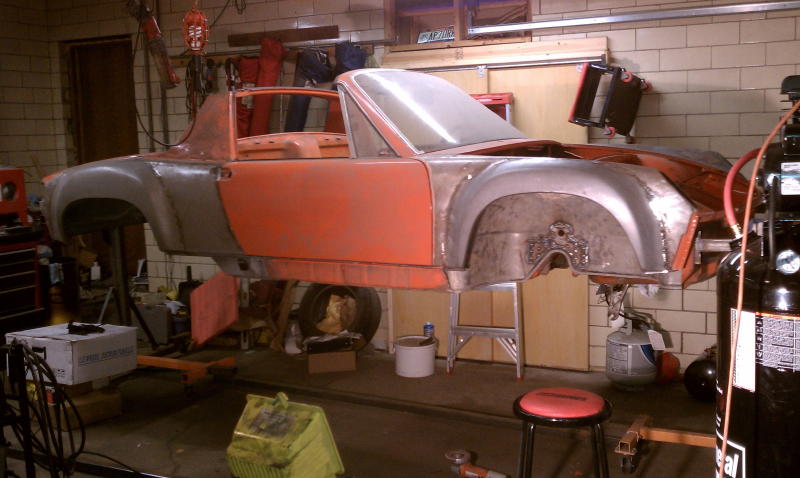

I am working on building a 914 GT conversion. I am trying to duplicate the front GT oil cooler sheet metal ducting. I am considering buying a low cost fiberglass replica to use to make a steel version of it. Does anyone a better idea of how to approach this?
