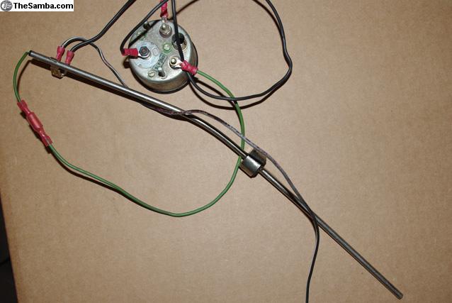

Sorry, I do not know if there is another super cheap way, maybe the dipstick temp. thngys i see time to time..

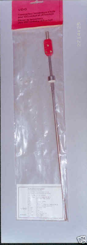

Here is the $13 answer.. found what I said VDO DIPSTICK SENDER..

detoxcowboy

QUOTE(detoxcowboy @ Jan 28 2011, 08:23 PM) *
http://cgi.ebay.com/ebaymotors/RARE-VDO-Oi...sQ5fAccessories
So much for $13 answer, check the shipping on that first..$19 shipping /.

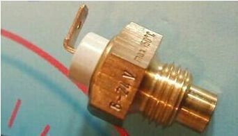

Here is another one, maybe they will sell it to you without the gauge..
plus you can ask them questions while deleting the gauge from the sale..
appear to be 150c/300deg. temp range again..
http://www.thesamba.com/vw/classifieds/detail.php?id=1081580

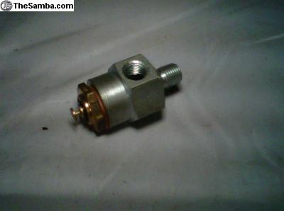

And and interesting combo that appears to retain your pressure sensor but add the temp sender?? ask alot of question, included thread size.. m10x1.0 for that location
http://www.thesamba.com/vw/classifieds/detail.php?id=1076158

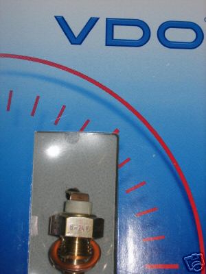

missed the obvious fit for the drain plug..
http://cgi.ebay.com/ebaymotors/VDO-oil-Tem...=item43a458ed28

I did a little more research on the drain plugs. All the plugs you linked are for M14 x 1.5 size/pitch. I found out Type IV uses a M12 x 1.5.
They make a sender (part #323-092) that has the M12x1.5 and looks identical to your pics. The info on the temp rating is 300deg. I did not know what temp values were needed for my gauge, so thanks again for your help.
Looks like 20-30 bucks and some wiring and I'm good!

The drain plug sender will read lower than reality because it's out in the airflow and being cooled off. Just mentally compensate.

I'm just going to say that I bought two of those drain plug senders, and neither of them actually fit the drain pug threads on my case. They did fit the taco plate threads. I am currently using one in my taco plate off a different engine.
For what its worth, my case was a bus case, so the drain plug may be different, but I doubt it.
