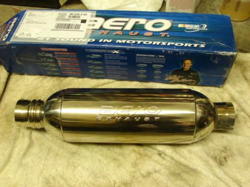

I had "Thrush" typs mufflers at first, I got way more HP on my V8 when I switched to glass packs. But it got way loud!
These mufflers are the best I've seen. I plan on using the 4" version on my turbo.
http://cgi.ebay.com/ebaymotors/Aero-Turbin...sQ5fAccessories

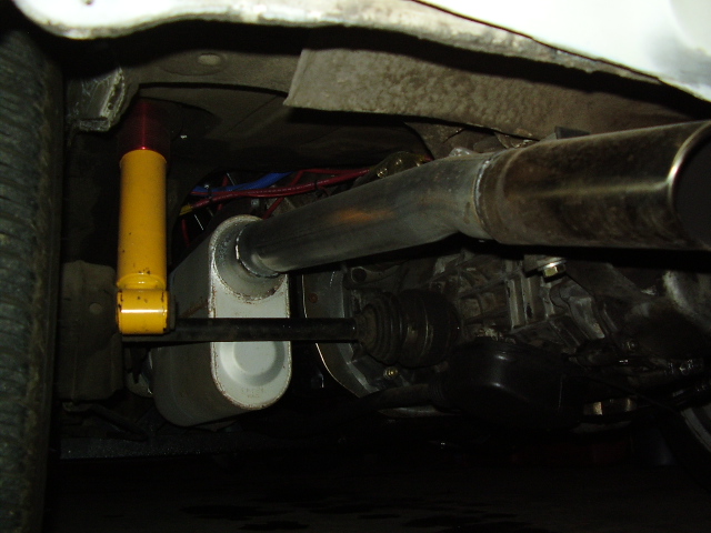

I have hugger headers on my 350 and I ran series 40 Flowmaster mufflers upright and in front of the axles. Haven't had any problems with it for four years now. Seems to flow well and sounds great without being too loud. (IMG:style_emoticons/default/biggrin.gif)
This probably won't be the general consensus. (IMG:style_emoticons/default/confused24.gif)
I would like to hear what those Aero cans sound like though! (IMG:style_emoticons/default/aktion035.gif)
Good luck! Paul
Ya, it's dirty under there and leaks stuff (IMG:style_emoticons/default/blink.gif) It's on my shit to do list.

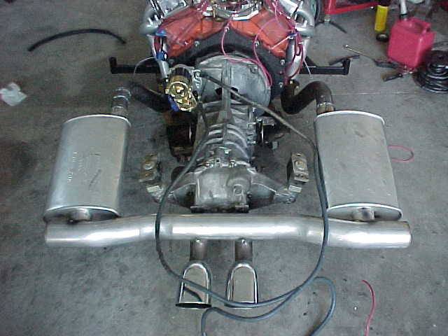

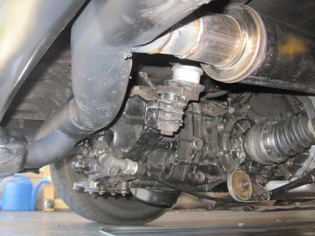

Here is a pic of my first exhaust. Renegade Hybrids prototype... Matthepcat owns it now with different mufflers...

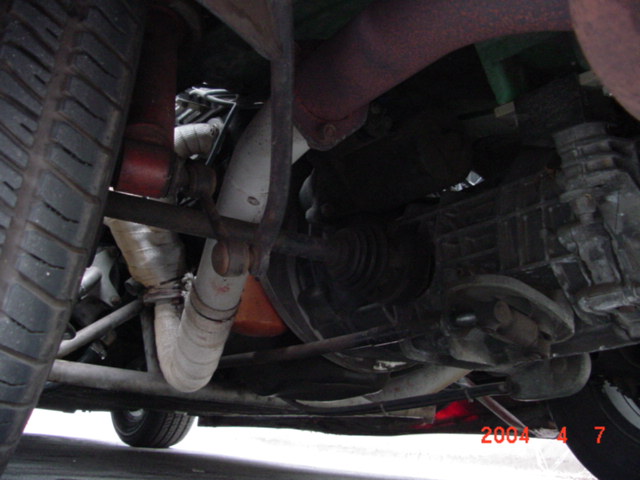

There are lots of options. The huggers give you more than I.... I used the early corvette headers that end just infront of the axles so all my muffler has to go behind and there's not much room for a crossover which is a good thing to consider. With out the crossover you can get some pretty nasty harmonics which makes it much louder particularly at certain rpms depending on size of pipes.
I used two systems in the past, one was no crossover with thrush turbos and then followed by Ansa double resonator tips. Really nice, but a resonate sound around 2000-2500 RPM that can get pretty tireing puttsing around town. Then I went to a camarro dual outlet and dual inlet can mounted cross wise behind the tailcone and that works pretty well, sounds like a big block boat.
You'll have lots of options.

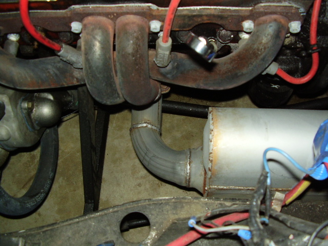

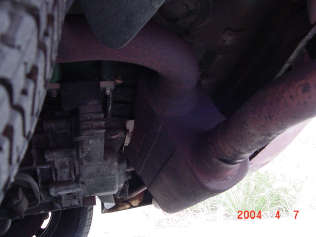

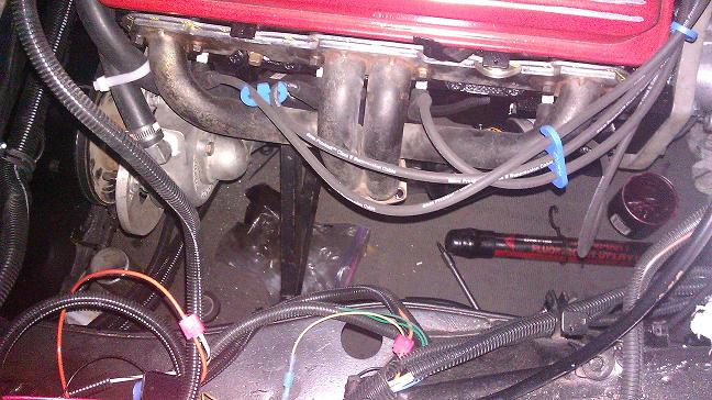

You can see from these pictures why block hugger headers dont work well. They take a very quick turn from the left header to clear the shifter. IMHO get some s10 or so sbc headers. They are short, put the exhaust right where you need it, and will flow well.
I have magnaflow mufflers and like the sound. I put on resinating tips and it quited it down some. Has a good sound (Might be some sound clips in my sig..). Almost a sporty sound..

I was going to ask what the difference was between "shortie" and "hugger" headers. Then I took a closer look at what I have and figured out that they are the shortie headers which sounds like the preferred choice. Will I need to replace my oil filter adapter (made for an oil cooler setup with lines capped off) in order to get correct clearances for over the axle pipes and shifter bar etc... You can make out part of the filter sitting just below the right side header.
So far, I like the idea of using the F body/Camaro muffler setup. Looks like the cross flow part ("H" / "X") is already built-in within the muffler!

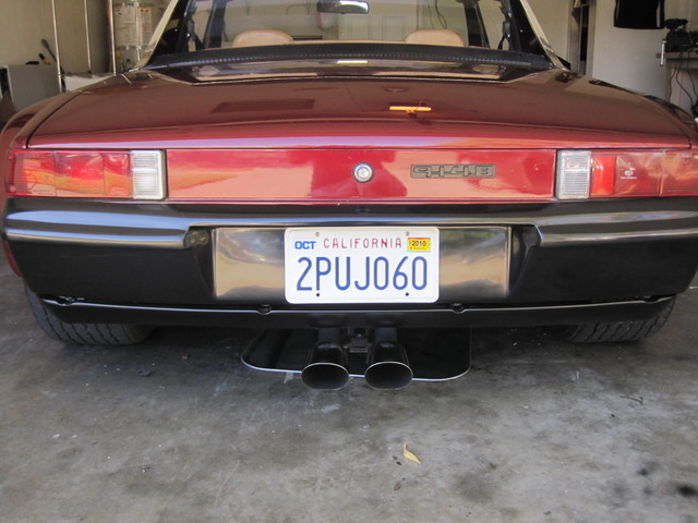

Here is kg6dxn exhaust now on my car (now with magnaflow mufflers).
(IMG:http://www.914world.com/bbs2/uploads_offsite/img691.imageshack.us-11125-1297732202.1.jpg)
(IMG:http://www.914world.com/bbs2/uploads_offsite/img87.imageshack.us-11125-1297732202.2.jpg)
I also installed drag sound traps at the header/exhaust union. Now no drone!

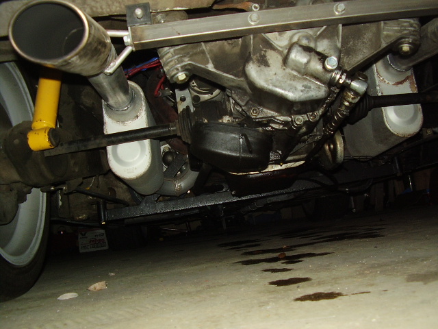

I went with the dual turbos and a crossover pipe...very happy with the results.
(IMG:http://www.914world.com/bbs2/uploads/post-4253-1233890821.jpg)
(IMG:http://www.914world.com/bbs2/uploads/post-4253-1235879612.jpg)
