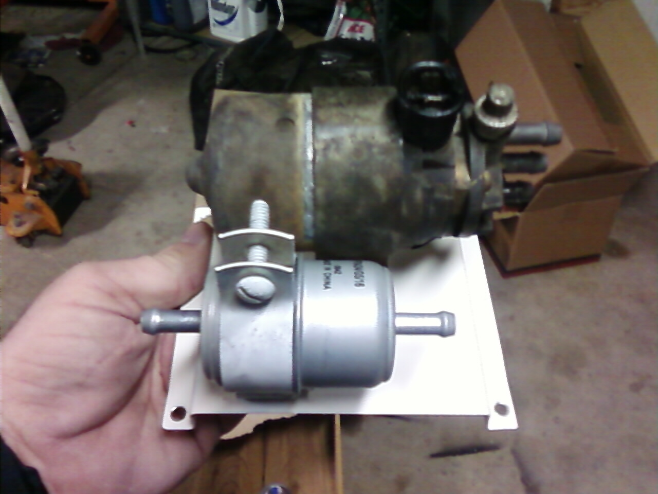

QUOTE(tod914 @ Mar 5 2011, 07:13 AM) *
Jeff, could post a shot of your pump set up if you have one. Would love to see how you did it (especially the pump mount).
Thanks, Tod
I don't have a picture of the current (new) pump. Same set-up as this one, but I used a coil bracket to hold the new pump on same as the old one. Did not have to re-space the pump bracket at all, so it would for sure go on the stock isolators. This panel was made up and attached to the firewall, I didn't like the stock location since it's rusted away. The filter is a 3/8 in 3/8 out now, but same filter. Clamp on that is actually a rigid conduit clamp. Works perfect!
