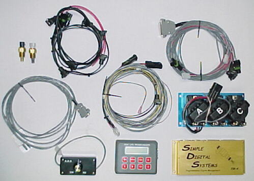

Oh yeah, it's a 3.0 no mo'. I rebuilt it about 3 years ago right before I had to ship off to Japan. It's now a 3.3 and has been sitting in my garage just waiting for me to get around to installing these:
(IMG:http://iesforums.org/cool.jpg)
mated with this:
(IMG:http://www.sdsefi.com/web6f.jpg)
