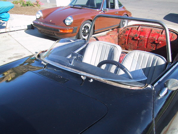

Not having welded anything in my life before, what are the odds I could become "productive" on small jobs (like dzus fastener plates etc) right away if I went and picked up a welder today, for instance??? Is the learning curve steep enough where I should stay the hell away from the teener for a while?
I'm not looking at anything "structural" at this point...
Joe Bob
post Apr 10 2004, 10:23 AM
Post #32
Posts: 17,427
Joined: 24-December 02
From: Boulder CO
Member No.: 5
Yeah....cutting the roof of a rusty 356 AND adding HP is not a good idea...Frank is gonna get a tube frame....so this is a timely thread.
