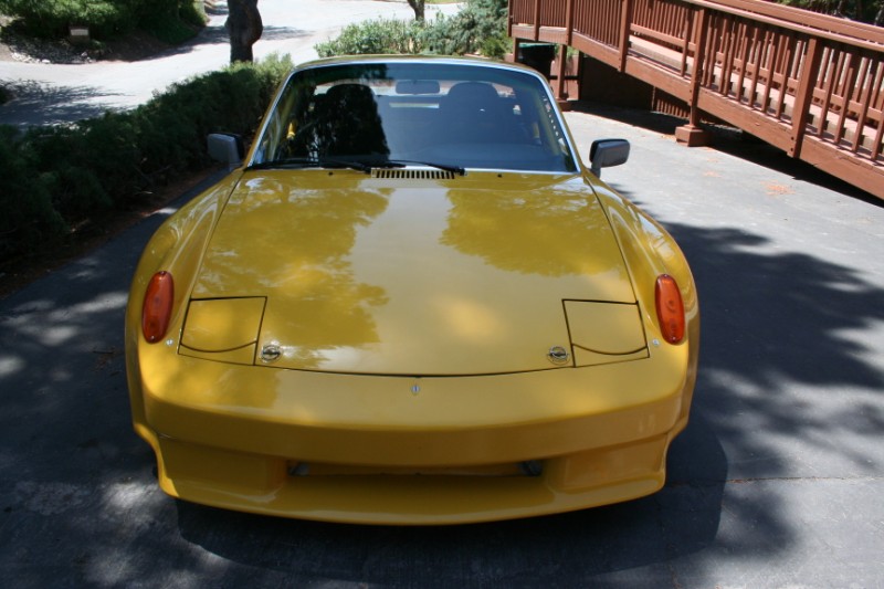

I put the hood pins and fuel door on this winter.
dflesburg
post May 4 2011, 01:14 PM
Posts: 1,722
Joined: 6-April 04
From: Warm and Cheerful Centerville Ohio
Member No.: 1,896
Yup.

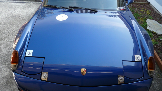

pcar916
post May 4 2011, 01:36 PM
Is that a Lola?
Posts: 1,524
Joined: 2-June 05
From: Little Rock, AR
Member No.: 4,188
Here be mine...
Haven't needed the front two even at Texas Motor Speedway or Mid Ohio... or on the road either.
Good luck

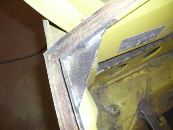

Gussets are good.

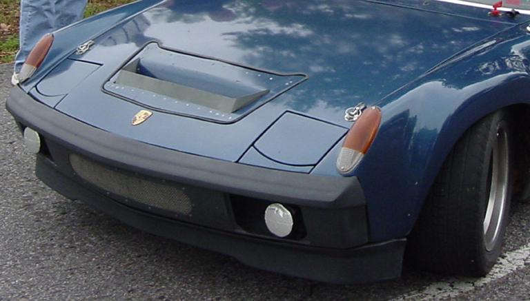

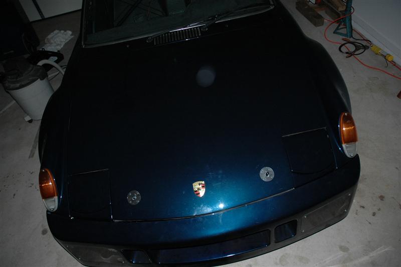

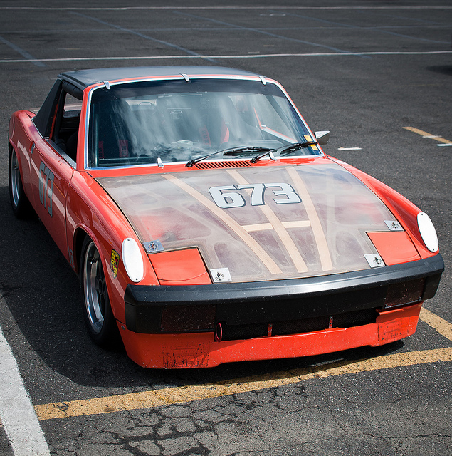

I did the 4 pins GT-style with the thin Getty lid and no stock latch. With the steel lid I used 2 pins plus the stock latch.
(IMG:http://www.914world.com/bbs2/uploads_offsite/farm6.static.flickr.com-21-1304570933.1.jpg)
914R at Pomona by cjcam, on Flickr

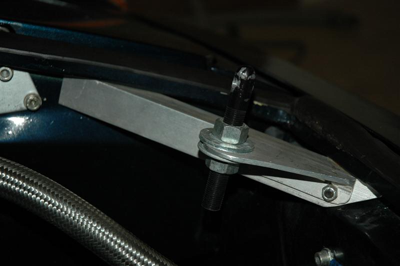

Anyone that have closeup pictures?
I also want to look inside the hood.

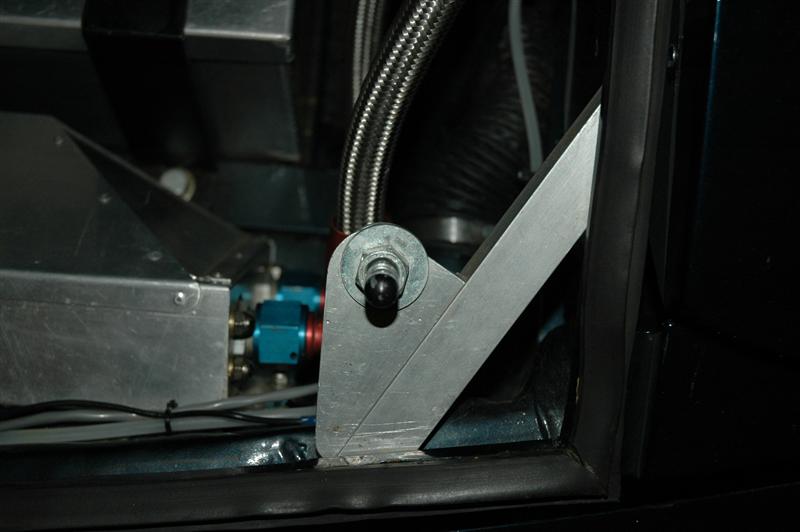

Here's how mine is....hope this helps some....steel hood, factory catch, hood pins....street/track car...I need to lock the front when needed....

QUOTE(Niklas @ May 5 2011, 02:06 PM) *
Niklas

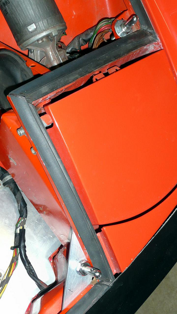

This may help. For the outer/rear one, the pin can go directly in the location where the rubber stop normally resides. For the inner/front one, I fabricated a simple aluminum bracket and riveted it in place.
(IMG:http://www.914world.com/bbs2/uploads_offsite/farm4.static.flickr.com-21-1304631544.1.jpg)
914R hood pins and brackets by cjcam, on Flickr

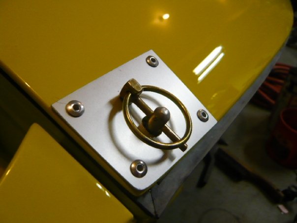

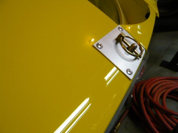

(IMG:http://www.914world.com/bbs2/uploads_offsite/fbcdn-sphotos-a.akamaihd.net-1110-1304659091.1.jpg)
(IMG:http://www.914world.com/bbs2/uploads_offsite/fbcdn-sphotos-a.akamaihd.net-1110-1304659092.2.jpg)
(IMG:http://www.914world.com/bbs2/uploads_offsite/fbcdn-sphotos-a.akamaihd.net-1110-1304659092.3.jpg)
Niklas
post May 6 2011, 01:21 AM
Porsche 914 Sweden
Posts: 368
Joined: 20-June 09
From: Sweden - Skivarp
Member No.: 10,488
Hello!
Thank you everbody.
Perfect pictures.
Niklas
