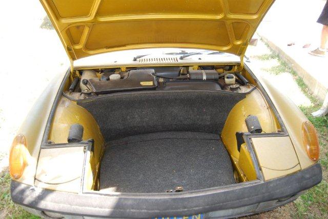

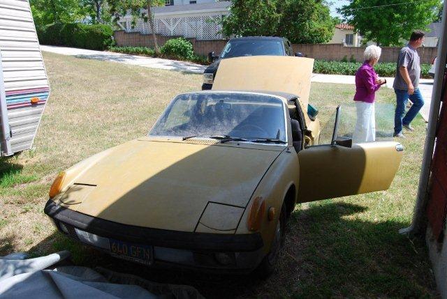

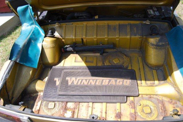

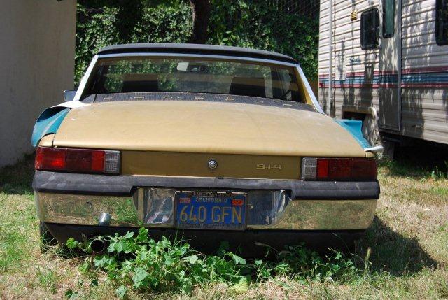

Previous Porsche owner - my first car I bought when I turned 16 was a used 1985.5 944. I loved it.
I now have an opportunity to acquire another porsche from a family member who is the original owner. I'm expecting a ton of work to get it in working order. The car is in Los Angeles, I'm in San Diego so I can't see it in person, just photos that I've attached.
Here's the deal:
-1972 1.7l
-VIN 4722913284
-OD says "01187" (I'm assuming that's 101,187 (IMG:style_emoticons/default/smile.gif) )
-It's been sitting covered for 15+ years
-Interior appears to be in decent condition
-Exterior is in good shape, paint looks to be fading
-I was told it was a custom color... gold?
-Some rust in the trunk and up the driver's side *post*
-Was running when last driven but was having a carburetor/fuel issue

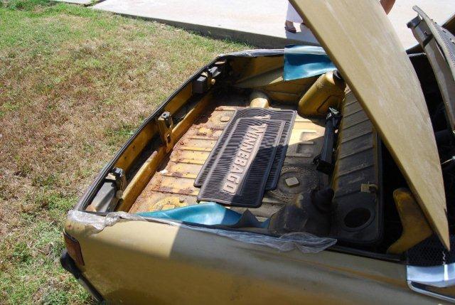

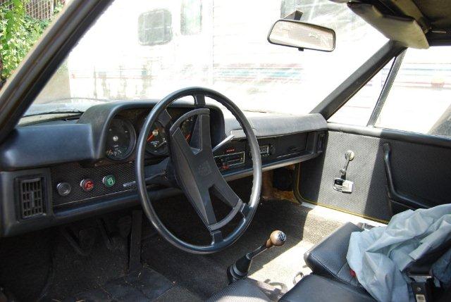

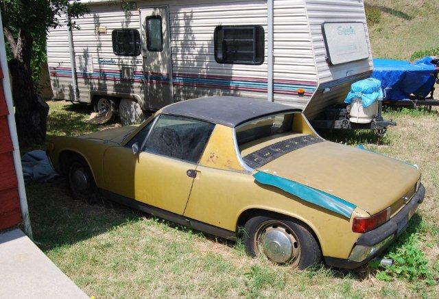

Based on the attach photos, can anyone give me more info about it? Also, the driver's side post (sorry, don't know what its called - the side of car that support the roof behind the driver) is painted. I normally see this with black vinyl or something similar in other photos.
Like I said everything is original. The family member who owned it is too old to do anything with it and looking to pass it on to someone else in the family. I'm thinking of acquiring it and trailering it to San Diego and see what it would take to get it running. If it's too much I'll probably sell it for parts.
Any info would be great.
Scott
Attached Image Attached Image Attached Image Attached Image Attached Image Attached Image Attached Image Attached Image

Poke around under the battery and check for rust. If it's cheap enough, buy it. It has some good parts. Rust repair can be expensive.

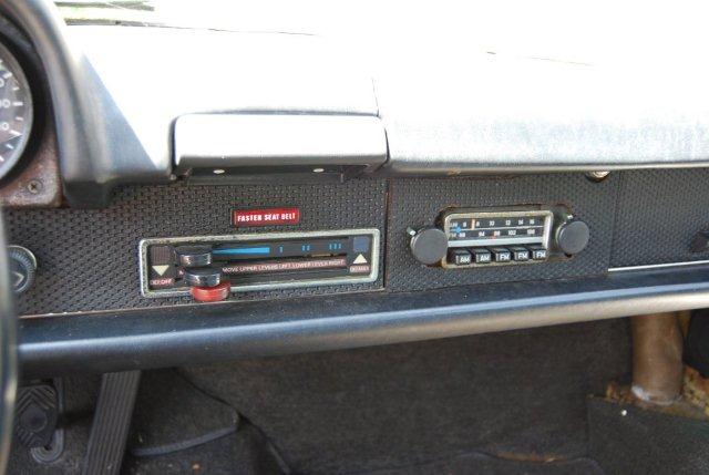

Cool radio. What dealership is the license plate frame from? It looks like San Francisco but I guess it could be San Fernando if the car is in LA.

QUOTE(skaufmann @ May 26 2011, 05:27 PM) *
There are 3 major problems with 914s:
1. The rust they left the factory with
2. The rust you can see now
3. The rust you haven't found yet
I'd be most worried about 3. (IMG:style_emoticons/default/bye1.gif)
From the pictures, it looks to be in decent shape for having sat so long.
However, you will have to carefully check for rust inside the engine bay under the battery tray. Also called the "hell hole". Do a search here for that term to see some examples of how bad that can get.
Then you need to remove the passenger side rocker panel and poke for rust behind that.
And then you need to move both seats forward, remove the carpet behind the seats and poke around the floor pan. Don't let the looks of the floor pan fool you, the factory painted over the sound deadening material and what often looks like a solid floorpan is in fact the (nicely painted) sound deadening holding the rust together ...
Good luck and (IMG:style_emoticons/default/welcome.png)

(IMG:style_emoticons/default/welcome.png) That looks to be a very complete original car. Good on you.
Learn to look for the danger areas:
1. Look underneath the side rockers at the jack post area. Those longitudinals are the backbone of the car.
2. As Mike mentioned, poke around the battery tray area. If the battery tray is rotted it will point to more rot in what we call the "hell hole". Look down beyond the battery tray where that engine shelf dips into the longitudinal and meets up with the firewall. Rain can wash in and pull battery acid over this area. Leaves often block the drain holes and... the hell hole is born. There's another one on the other side as well... check there.
As you can see from the trunk photo, there's usually a foam pad in there resting in the back 1/2 of the trunk. That pad would get saturated when water leaked past the bad tail light seals. You can see a decent amount of rust there already but... it doesn't look too bad.
IMO, that could mean your longs and your hell holes might be in decent shape. That and the fact that this was a Cali car all it's life. You just may have something here.
I wonder what it would look like with:
1. Buffed out paint.
2. New Sail Panel Vinyl (it had vinyl at one time)
3. Blasted and repainted wheels
I'd venture to say there's more gold there than meets the eye. (IMG:style_emoticons/default/smilie_pokal.gif)

(IMG:style_emoticons/default/agree.gif) ... with the above,
plus also pull the outer door seals out of the channels & check for rust & along the bottoms of the doors & the door jambs front & rear on both sides;
pull the seals out of the channels in the front trunk & front fender to cowl seals & check those for rust, & the front trunk floor;
as well as remove the front steering rack cover & check all around that area for rust damage, cuz both the windshield washer bottle & lines and the brake fluid reservoir can leak don, sit & rust through below;
also pull the left outer rocker cover below the door (as well as pass. side noted above) & check both longitudinals & behind the jackpost supports for rust, as well as the inner longs & floor panels from the inside (note the tar is also painted over on the floor there.

do a post requesting a PPI from one of the LA guys here. if you buy it, bring it over to my shop. I'll put it on teh lift for free and we can ogle your 914 score
it has been sitting in that spot for a long time. the tires look to have sunk into the terrain. it will have alot of surface rust on the belly parts but that is not the scary stuff to run away from.

skaufmann
post May 27 2011, 12:16 PM
Blissfully Ignorant
Posts: 103
Joined: 26-May 11
From: San Diego - College Area
Member No.: 13,123
I may have figured out my chrome/no vinyl sails question...
Chrome bumpers and having driving/fog lights, etc. indicate it *may* have the "optional appearance group" package which it then should also have the vinyl sails. I'll have to investigate the vehicle further when I get it see if it fact has the other pieces of the optional appearance package.

post May 27 2011, 12:41 PM
Hey nice rack! -Celette
Posts: 21,239
From: Now in Superior WI
Member No.: 43
72 Appearance group. Sail vinyl likely shrunk and curled up off the trim and someone just peeled it off. Factory color. (IMG:style_emoticons/default/welcome.png) (IMG:style_emoticons/default/assimilate.gif)

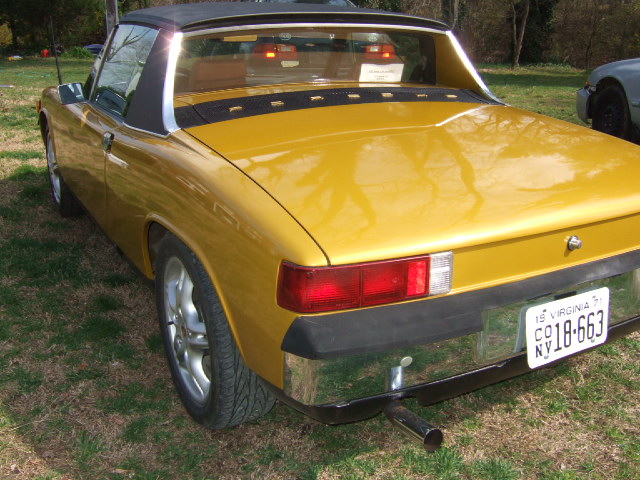

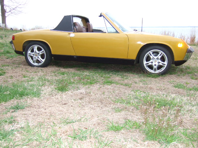

post May 27 2011, 05:25 PM
Posts: 1,460
Joined: 30-April 09
From: Rescue, Virginia
Member No.: 10,318

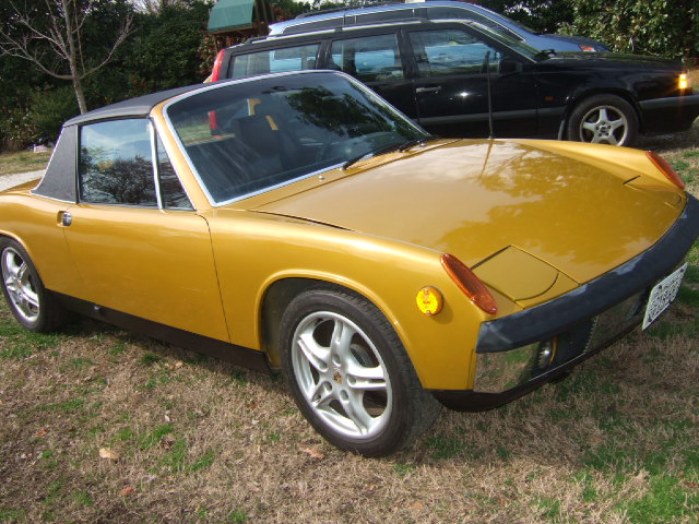

It'll be a nice project if you like projects and will grow on you....as will the addiction to 914World forums--not a bad habit all in all....
Don't go for another color before really appreciating the gold metallic--like the underside of the hood shows...
Here's a couple of pics of how mine ended up...
John
skaufmann
post May 27 2011, 05:33 PM
Blissfully Ignorant
Posts: 103
Joined: 26-May 11
Member No.: 13,123
John - she's beautiful. With as original as most, if not all, this car seems to be, I wouldn't dare change the factory color.
Thanks for the photos. It's hard to find good examples of the metallic gold.
