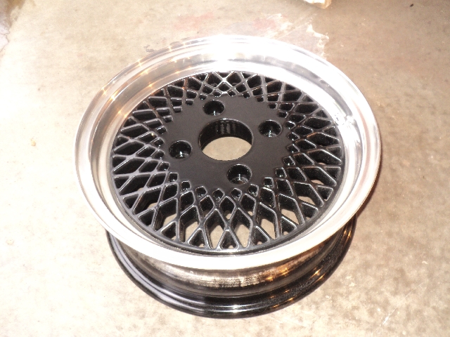

Wow, Wore off in shipping? (IMG:style_emoticons/default/WTF.gif) I just had these wheels powder coated last week. The powder guy had some blow through onto the polished lip. I had to use a hard buffing wheel with black diamond to get it off! (IMG:style_emoticons/default/dry.gif) A couple places I had to sand off and re-polish the wheels (IMG:style_emoticons/default/headbang.gif) So your discription does not match what I had to do to my wheels at all.
Now, You can paint over the powder. You will have to sand blast or sand with like 180 grit for the paint to get enough tooth to hang on to the powder.
One other thing. One of the 928 guys blasted and powder coated his intake, bolted it to the car and destroyed his engine with the grit that was lodged in the intake. Intake parts need special care.

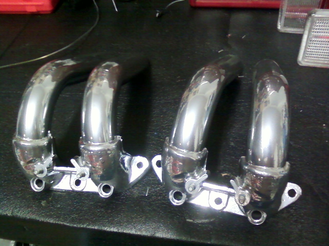

My name Barry, and i powdercoated pat"s plenums. I asked pat to send it back and i would prep and recoat it free of charge. I did not recieve a reply back. I stand by my workmanship as a "hobbyist powdercoater" I have been coating for over 3 years and have done many small jobs for porsche friends and forum members only. Its my hobby that i enjoy and want to continue doing so. I cant for the life of me figure out how it became scratched or worn off in shipping by paper. Anyway, pat if your reading this please give me the opportunity to make it right. Ill even sandblast it with my media which is glass beads and not sand, to keep it from pitting, to remove the powder. Its a bitch, but ill take care of it.

Attached ImageBefore shipping
