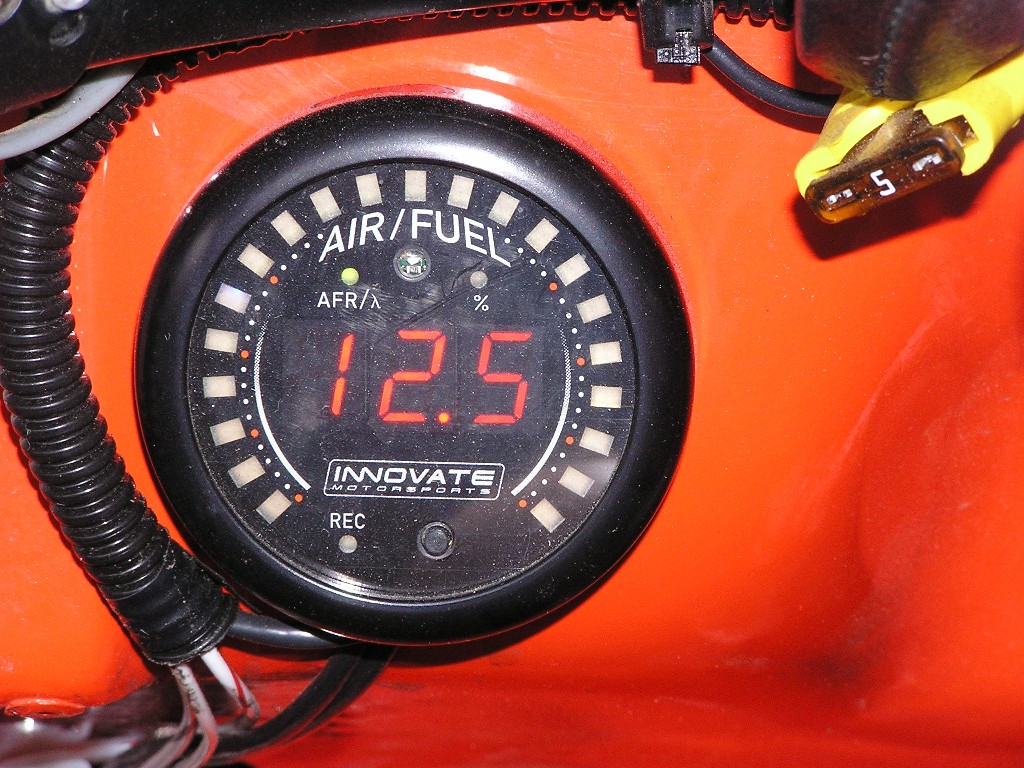

I've used an LM-1 to adjust MPS units to fit the motor
also if you planned on tweeking resistors, or fuel pressure, the LM-1 would give you a good picture of which way and how far you were going.....

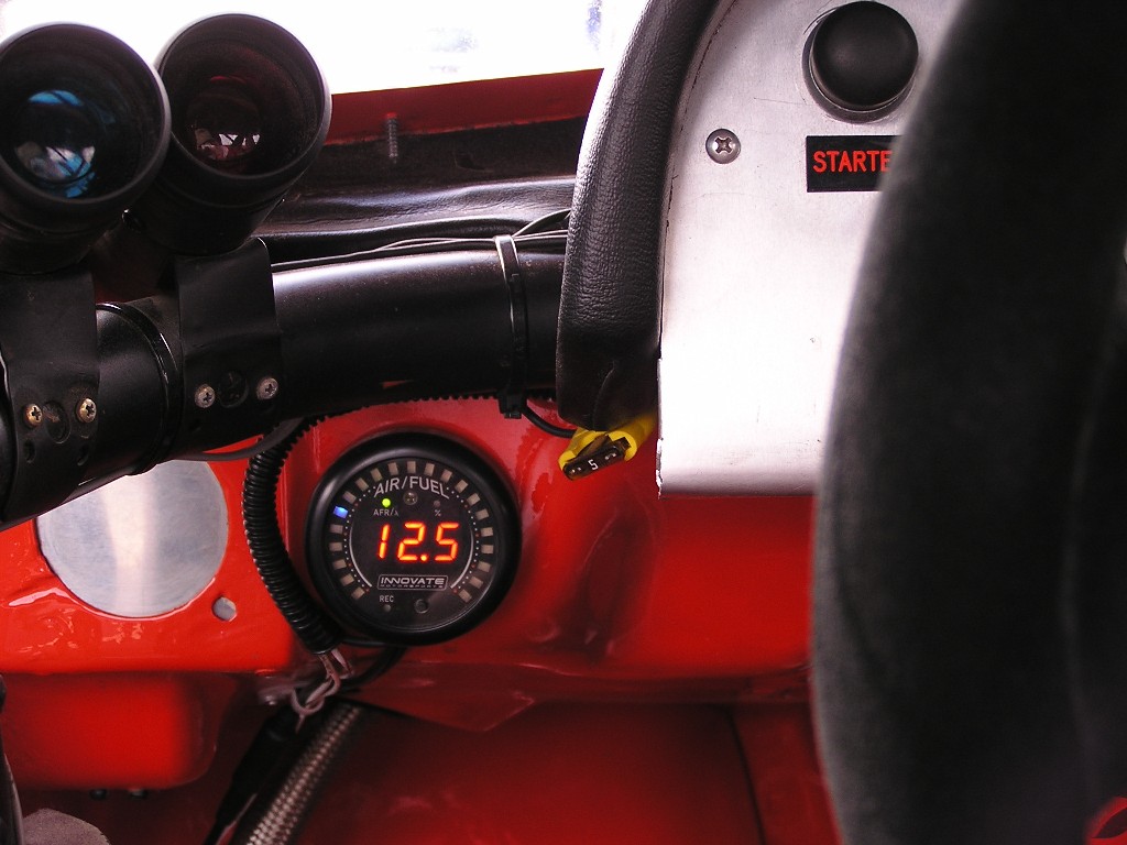

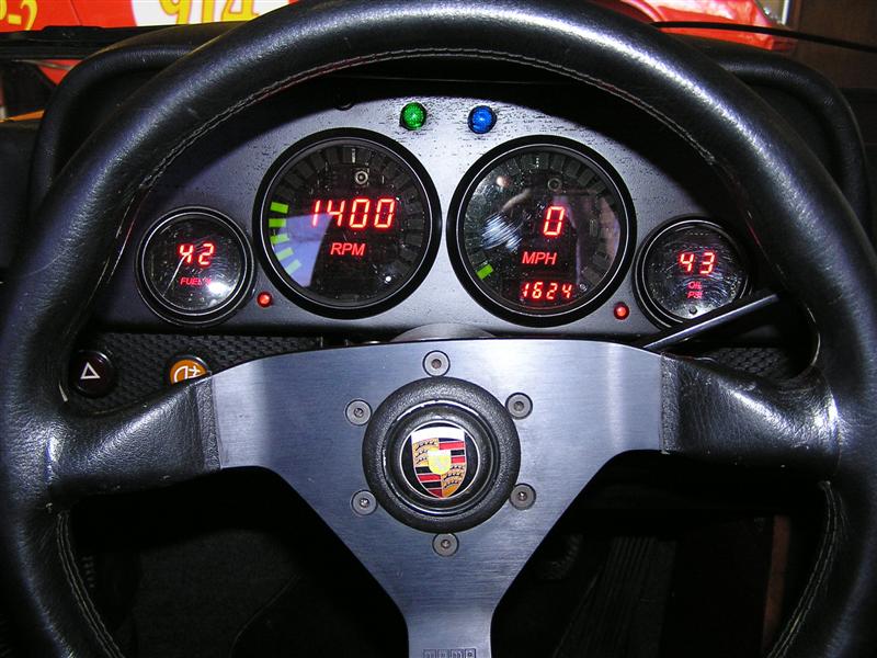

brant
post Jul 5 2011, 10:59 PM
Posts: 12,167
From: Colorado
Member No.: 47
nordskog makes some good stuff
and their customer-tech service is top notch
I have a bunch of their stuff in one car:
also.. Innovate makes a great AFR
I've run it for years now...
