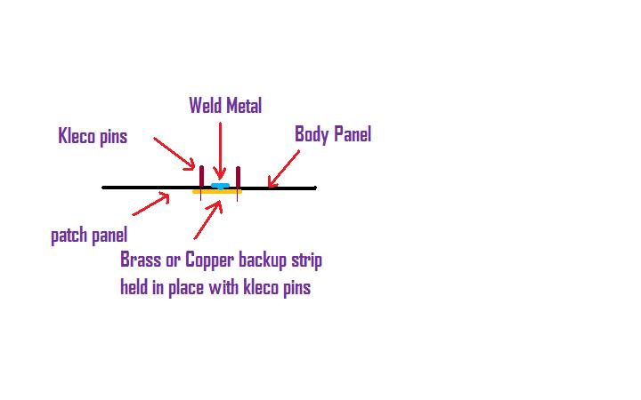

(IMG:style_emoticons/default/welder.gif) When welding holes specially in something like a trunk lid you can take a piece of copper tubing and hammer it flat. Either fasten it to the underside of the lid with cleco fasteners, sheet metal screws or clamps. The weld metal won't stick to the copper and the copper will act as a heat sink and also stiffen up the lid to reduce the possability of warping the lid. (IMG:style_emoticons/default/welder.gif)

I would use a magnetic clamp over Klecos so that there would not be extra holes to fill. Copper works great. I got a short length Of copper pipe from the off cut bin at Ace for pennies and cut off bits of it as needed.

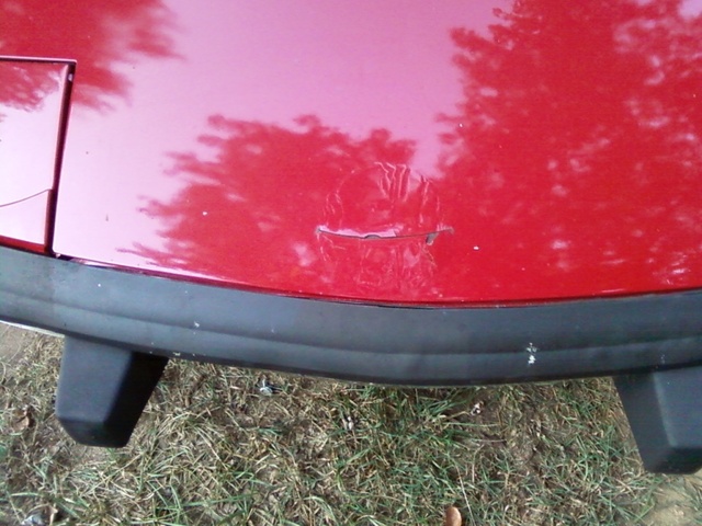

Here is the reason for doing this, a large bubble in the paint on the front.
(IMG:http://www.914world.com/bbs2/uploads_offsite/i921.photobucket.com-11654-1315007515.1.jpg)
I call that the hood emblem

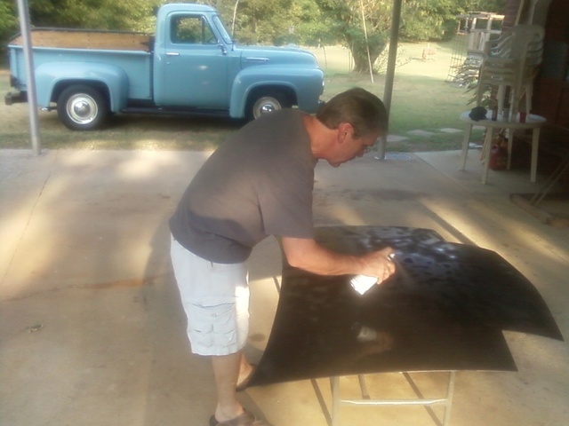

My dad sanding on the front lid.
(IMG:http://www.914world.com/bbs2/uploads_offsite/i921.photobucket.com-11654-1315007516.3.jpg)

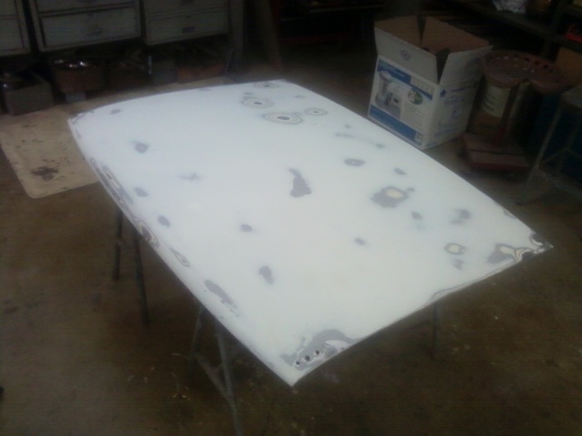

and spraying the primer.
(IMG:http://www.914world.com/bbs2/uploads_offsite/i921.photobucket.com-11654-1315007516.4.jpg)
