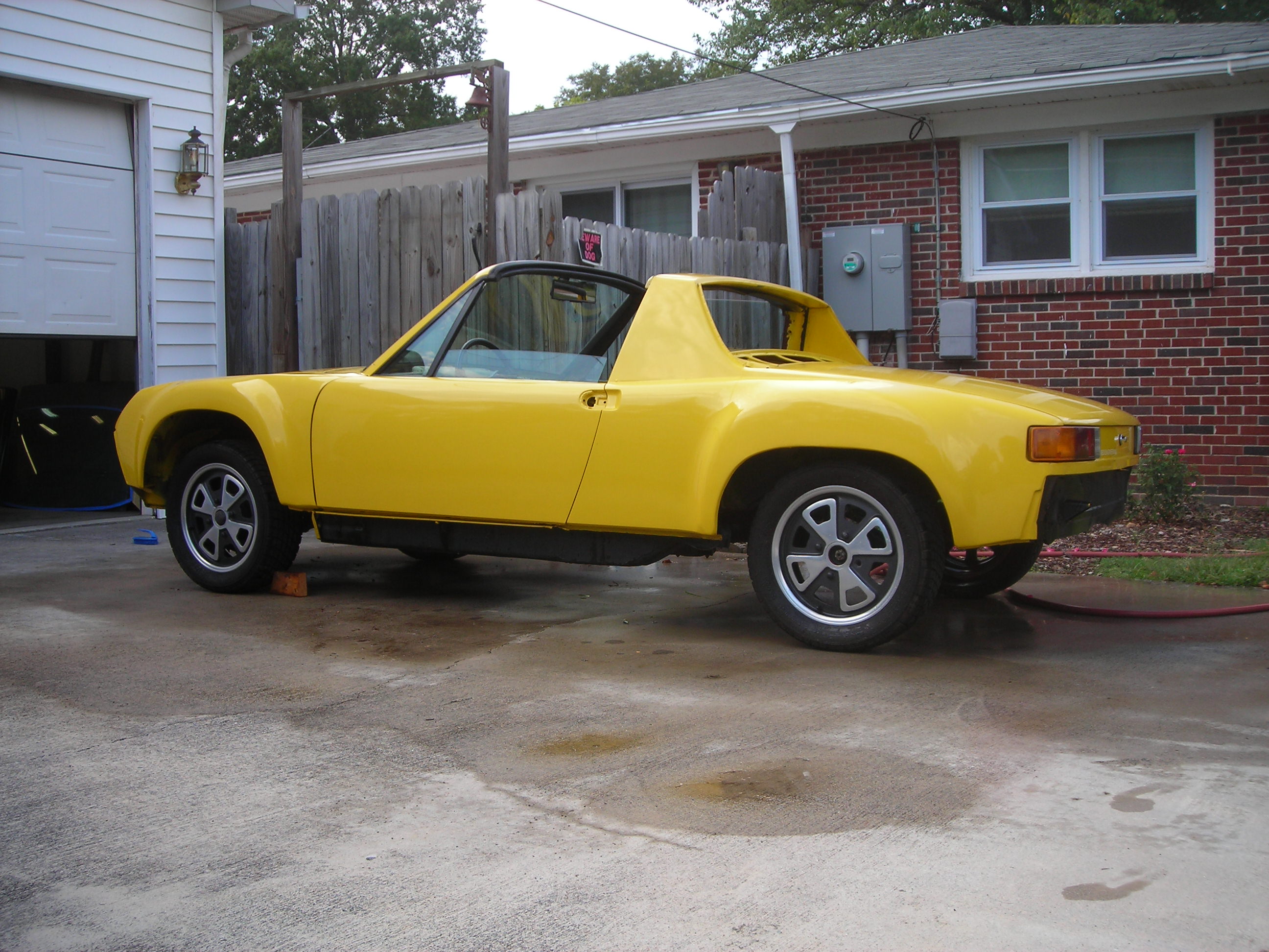

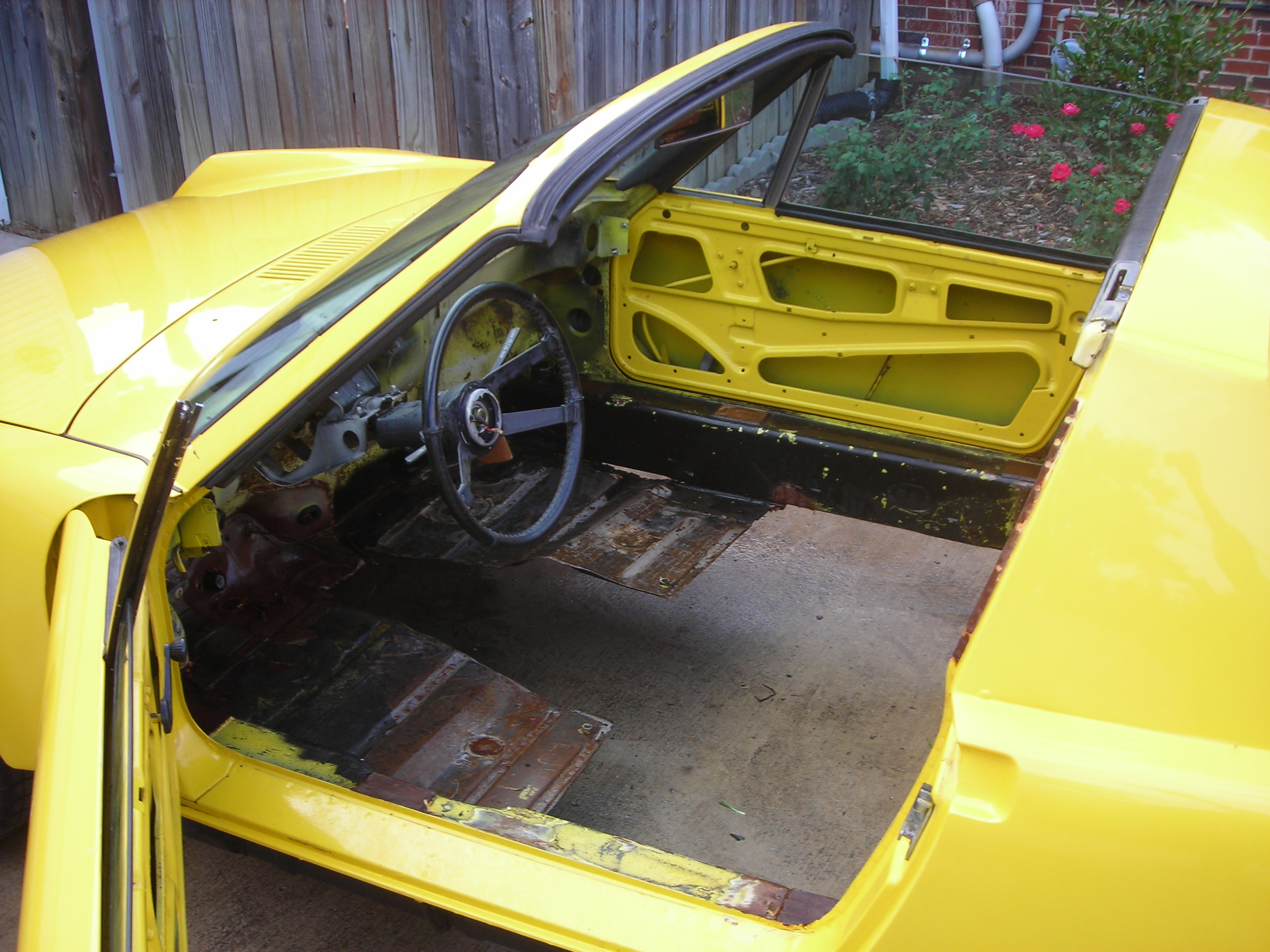

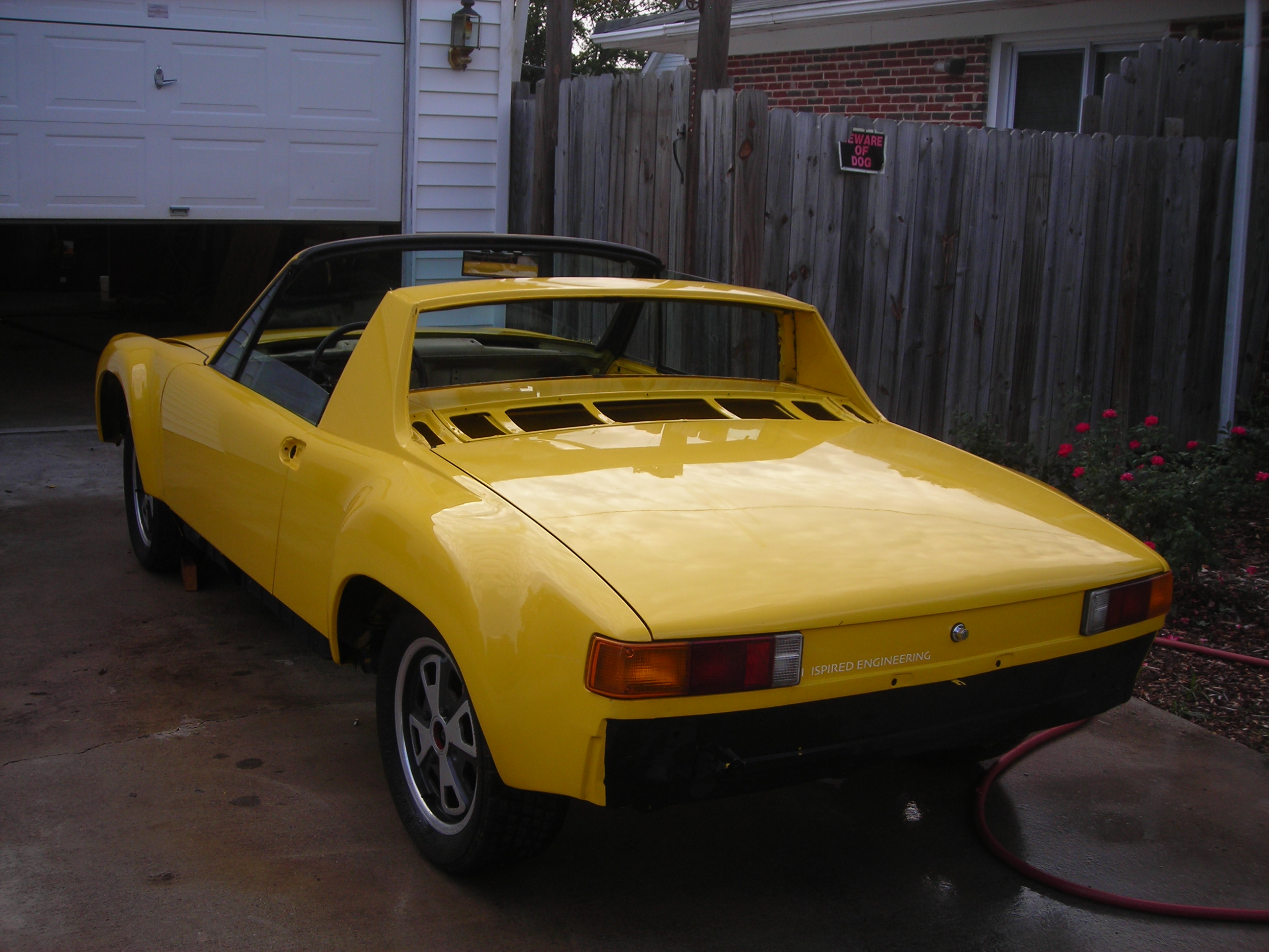

I just got back from Denver where I drug home the new project. Its a 72 chassis with steel flares already installed. Its yellow with nice paint. Not perfect but its good driver paint. My plan is to use the car as is for the time being. I like the color and the wife is happy with it. I have a complete 3.3 Suby swap with a 2.5RS 5spd transmission. I want to get all the mechanicals sorted on the car, build all the chassis stiffening and get the wiring right, then in a couple of years pull it back apart and do a thorough paint job on the chassis.
I found a place down in Mississippi that can back, de-rust, and then e-coat a car so I would like to give them a shot to preserve the chassis for years. Anyway here are a few pics. BTW I didn't pay but a small bit of change and some beer for this car. Attached Image Attached ImageAttached ImageAttached Image

I found some more parts while looking at it today. It has five lug rear hubs, already drilled, Bilstein rear shocks, sway bars front and brackets in the rear, and turbo tie rods. I need to check and see, I think I have some 911 studs in my stash somewhere.
Debating how I want to do the front five lug. I can drill out the front hubs, knock the rotors off the hubs and do a floating rotor conversion, or I could try to machine by own set of aluminum front hubs like the ones Brad used to make. Or I could build my own custom struts housing and use a more modern bearing setup.

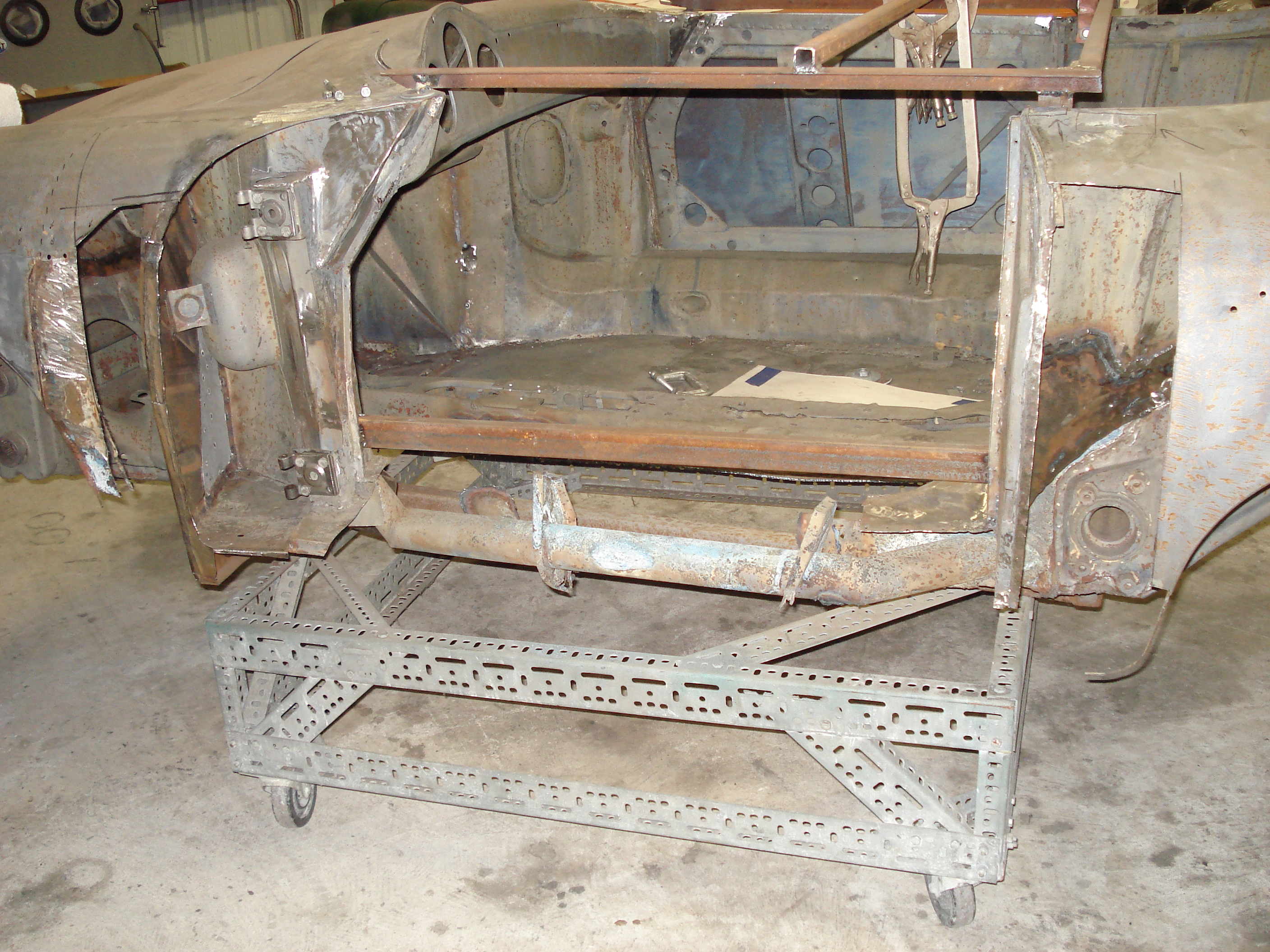

My goal is to remove them and weld the rockers back up. I don't need them and they get in the way of some of my reinforcements.
There is no rear floor pan section and no tunnel. I am probably going to build my own tunnel over replacement floor pans. I want a taller more narrow tunnel. I never liked how you are not centered on the wheels or pedals in a 914. SO I want to move the seats over closer to the middle of the car. Plus I want a taller center tunnel that will add more stiffness to the chassis. Another benefit is it gets the cable shifter up closer to the steering wheel. May even do a center tunnel mounted e-brake.

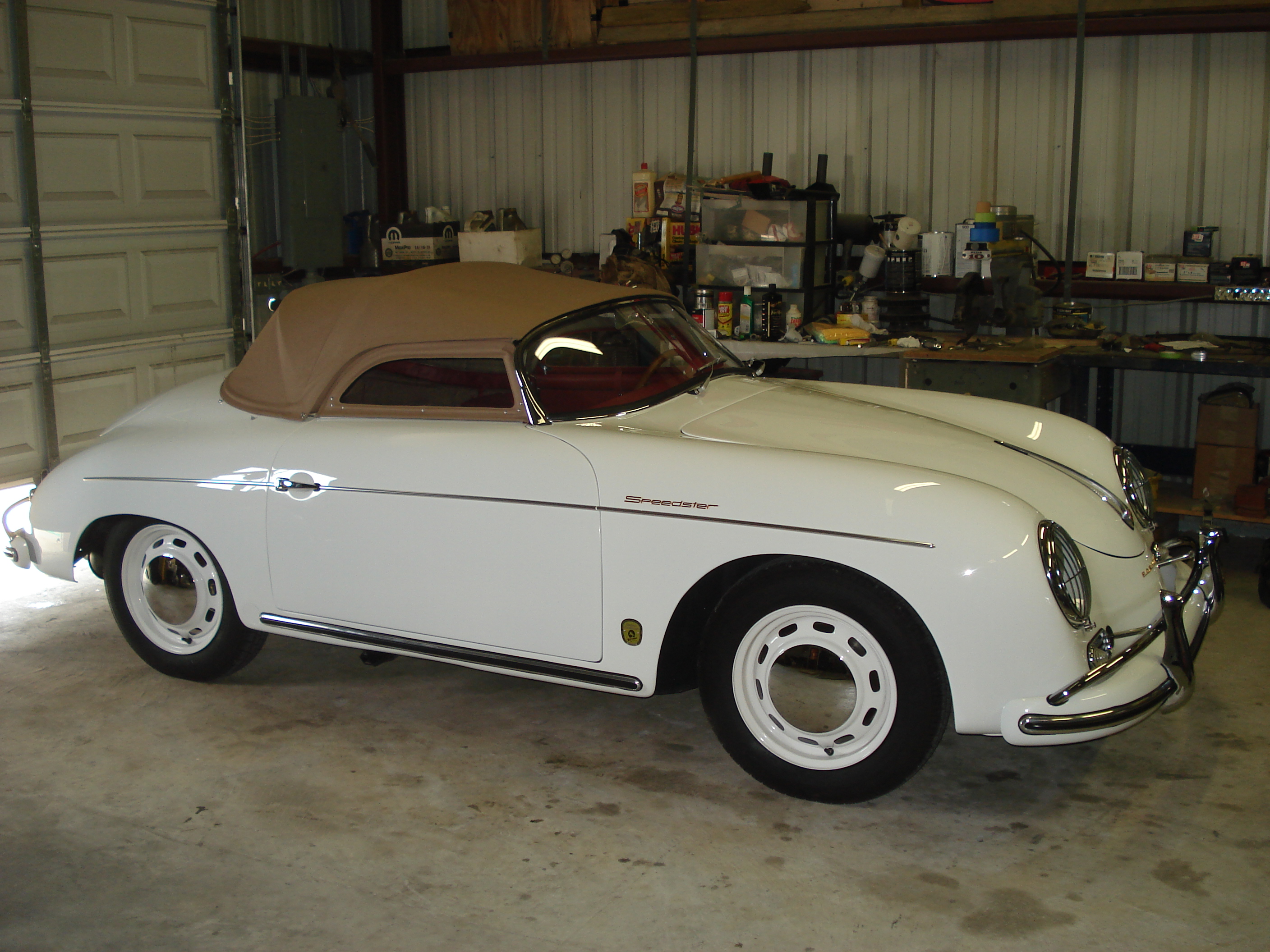

I have used them twice now for the dipping and E-coating. One 1957 Porsche 356 speedster and one 1957 Austin Healey 100-6. Very pleased with the E-coating. These cars should last a long time with the E-coat.

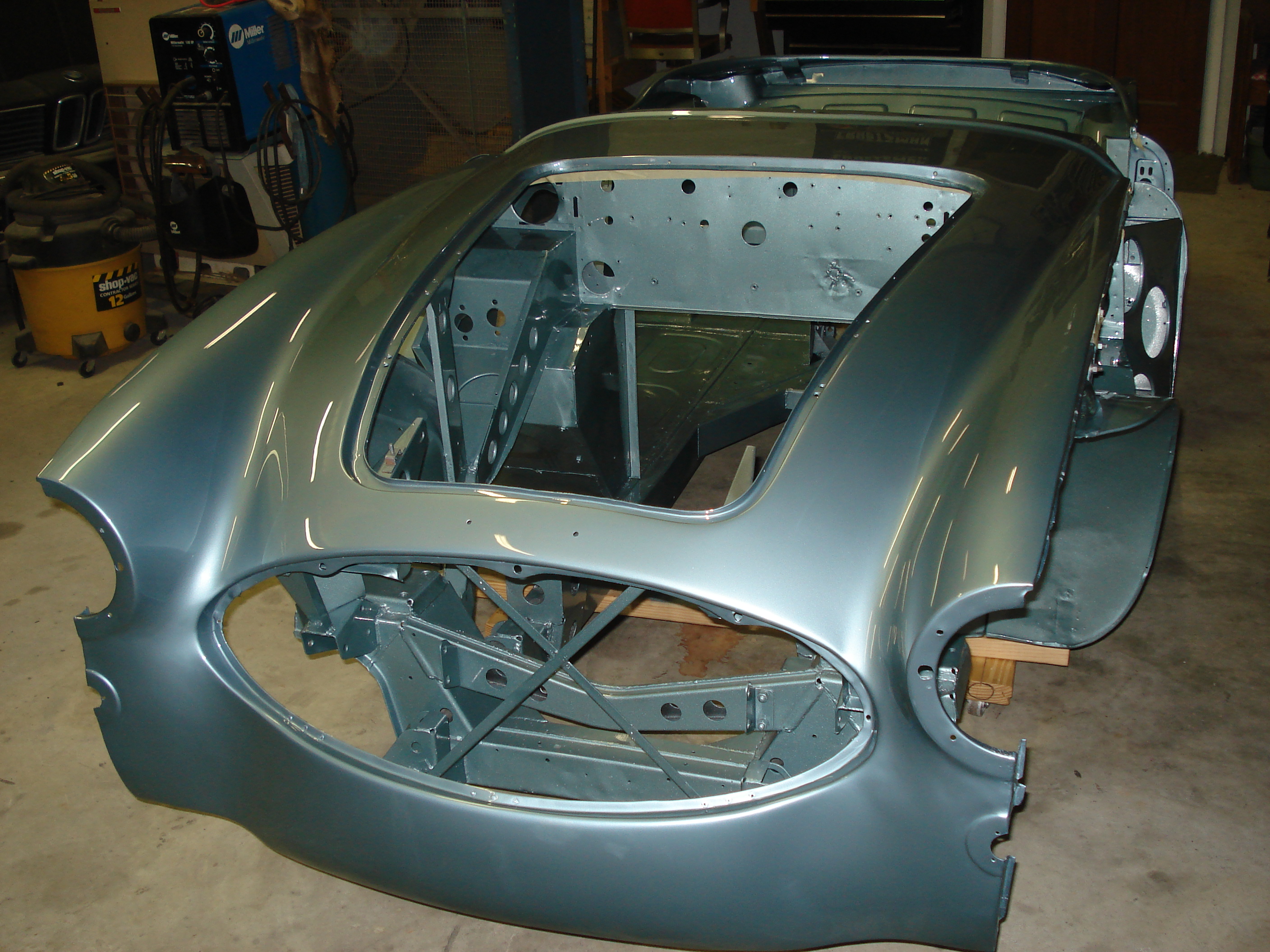

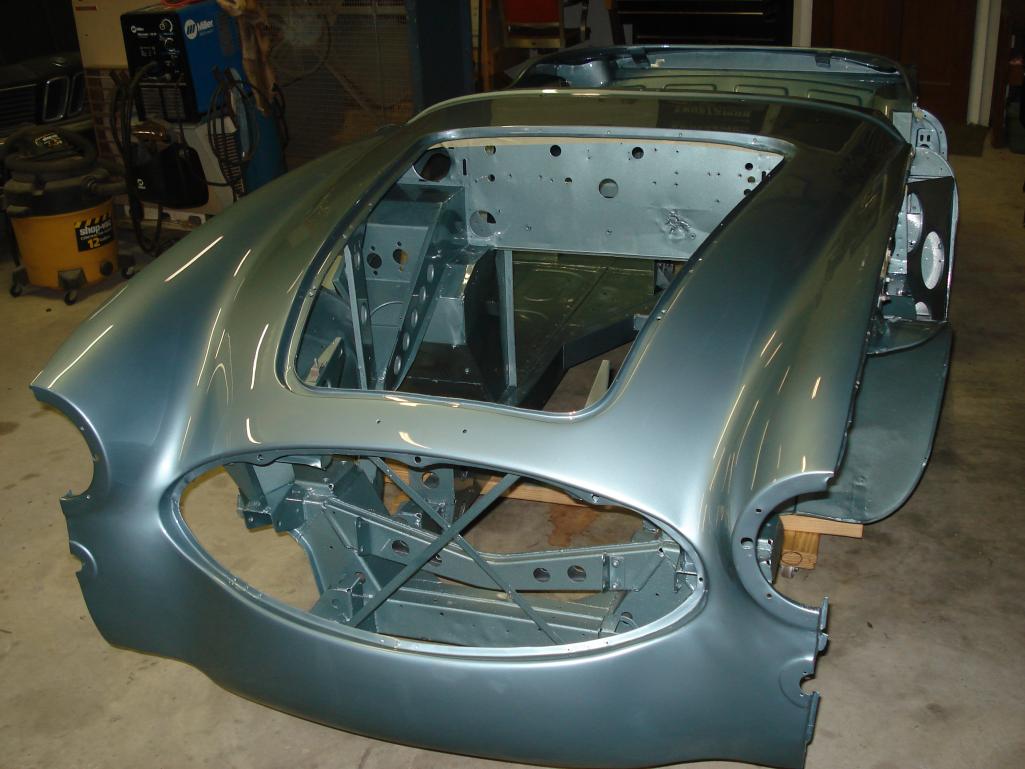

It was more like a month to a month and a half total. The E-coating is done off site so they are only allowed to bring a couple cars at a time for the e-coat process. Once the car is dipped and rinsed it will be in line for the next opening. If you are lucky they won't have many ahead of you when you are ready.
We are only 4 hours away so we had the luxury of dipping the car and picking it up, doing the rust repairs , and returning the car a few months later for re-dipping and final E-coating. This way everything is sealed in continuous E-coating after repairs.
Heres the Austin Healey after e-coating

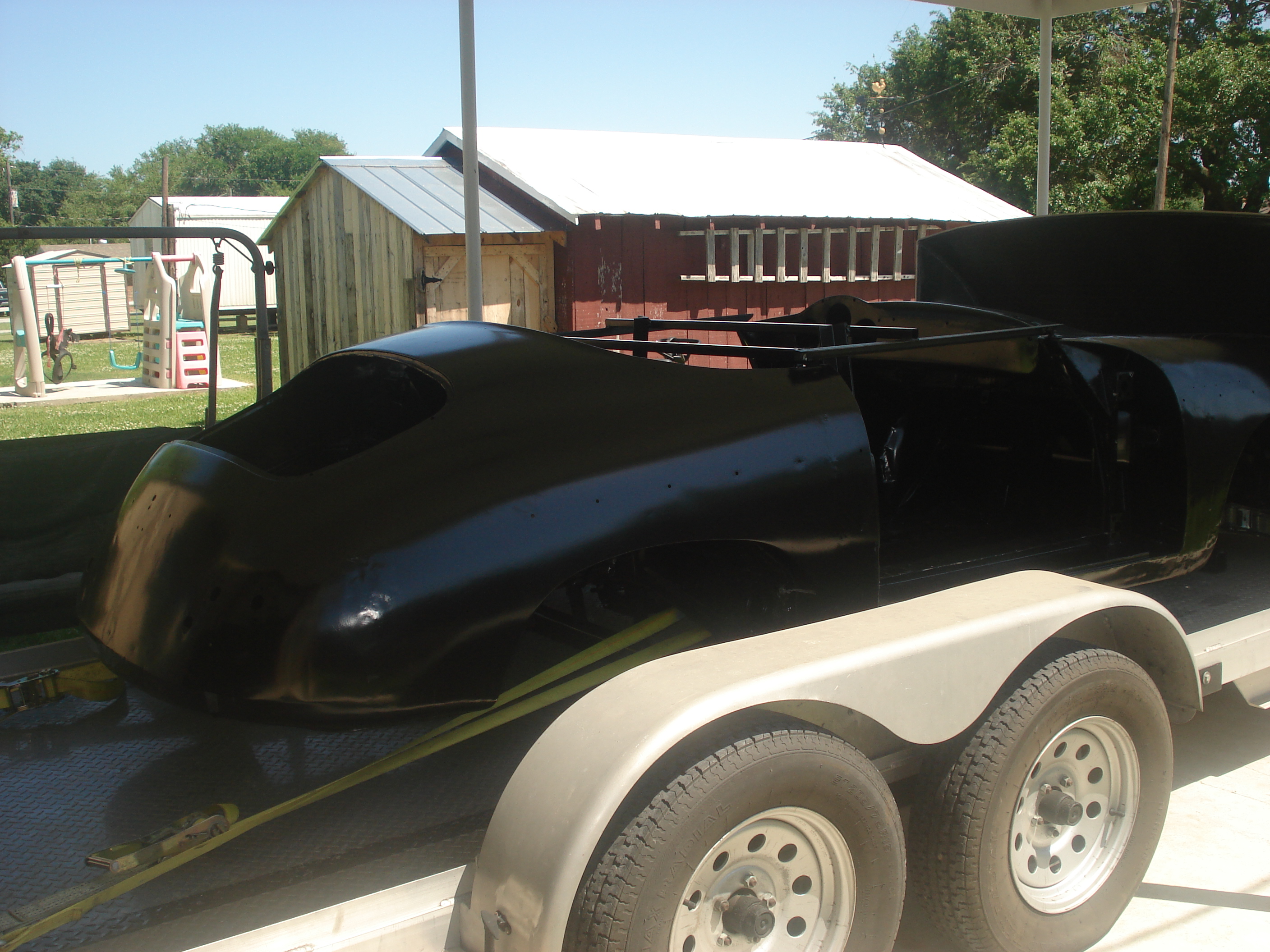

Heres the speedster prior to e-coating but after the first dip during some of the metal replacement.
zambezi
post Sep 20 2011, 12:58 PM
Posts: 711
Joined: 14-April 08
From: Lafayette, LA
Member No.: 8,920

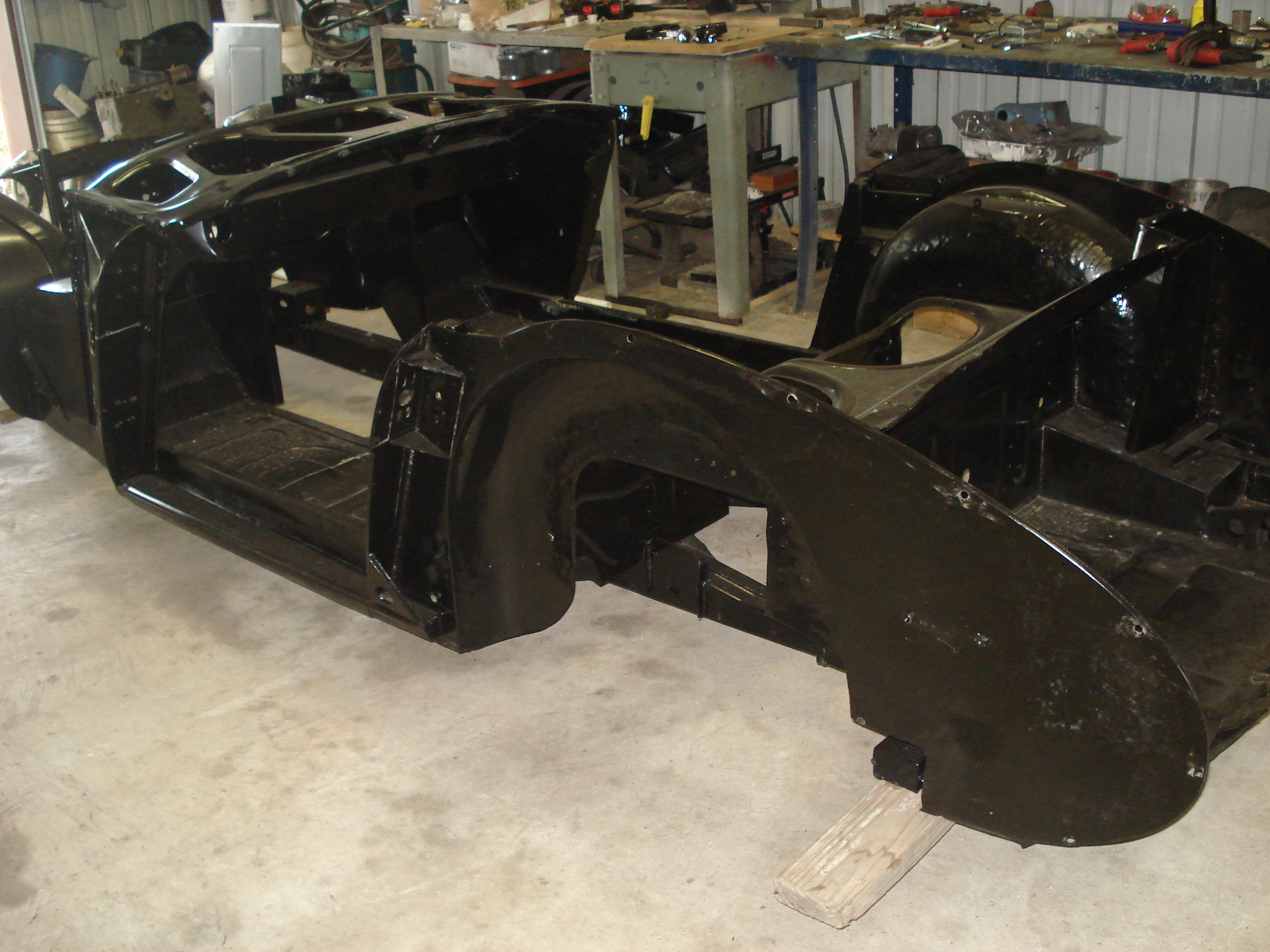

Heres the speedster after E-coating.
zambezi
post Sep 20 2011, 01:00 PM
Posts: 711
Joined: 14-April 08
From: Lafayette, LA
Member No.: 8,920
And of course the final product once put back together.
