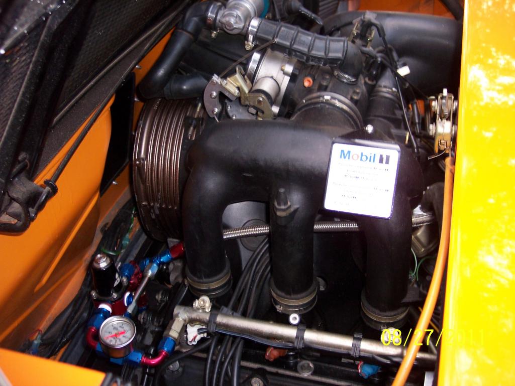

I got mine from Jegs, IIRC.
I think it was only 20.00 bucks or something.
Pretty much all odf the units out there have a 1/8'' NPT fitting to mount them.
I just plumbed mine right into the fuel inlet to make it permanent.
Ron

As already said, almost any pressure gauge will do. I used a water heater pressure gauge + 1/4" NPT hose nipple + 12" of 3/16" fuel hose. This will stay on the fuel rail test nipple with a hose clamp. Zip tied the gauge to the engine deck lid cable release housing. Got me through FI rehabilitation, establishing best fuel pressure and diagnosing an intermittent fuel pump failure. Took it off after I thought everything was kosher. Somehow, most likely because I'd read the Cap'n warn someone else against it, I didn't loose the test nipple plug screw.
