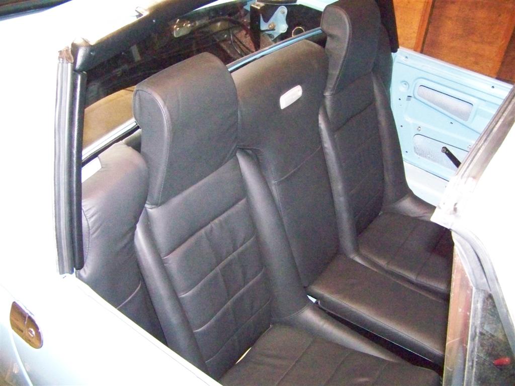

The interior has been redone in black leather.
I the dash and all the targa and widow trim were also redone.
I don't remember the name of the wheels. Raydel or something
like that. They fit the wells nicely without spacers and they are
period correct for the car.

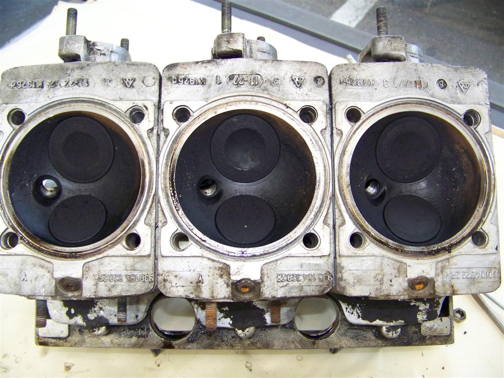

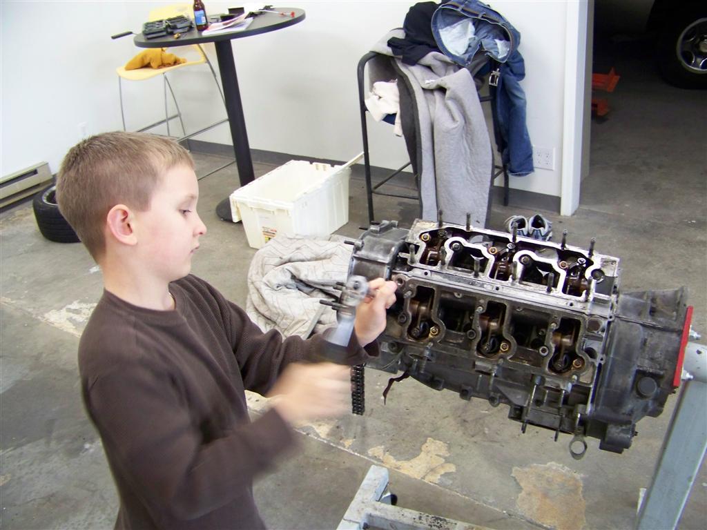

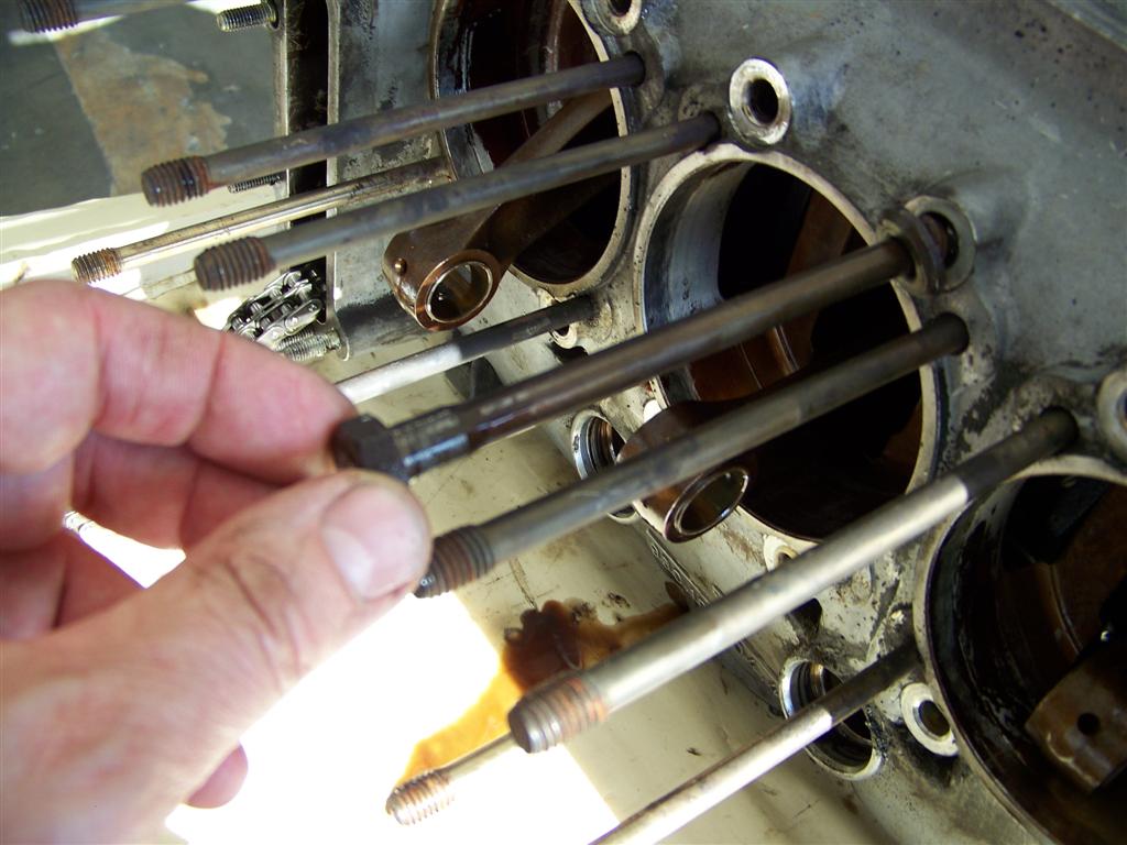

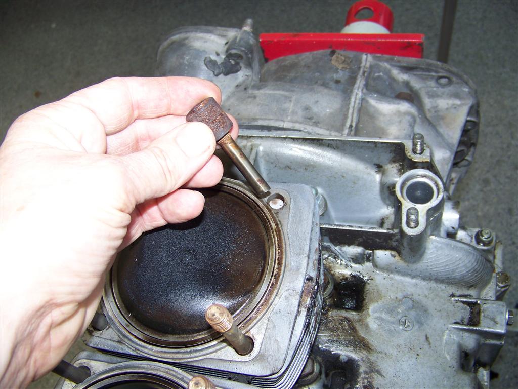

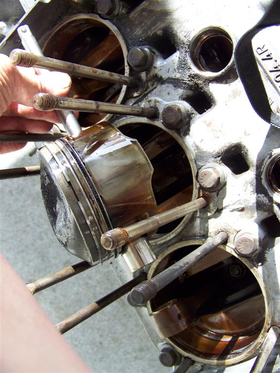

It's catch up time on my thread. Here's my assistant (grandson)
unbolting the heads.
Here's a view of the valves. Doesn't look bad to me.
One of the studs had broken off.

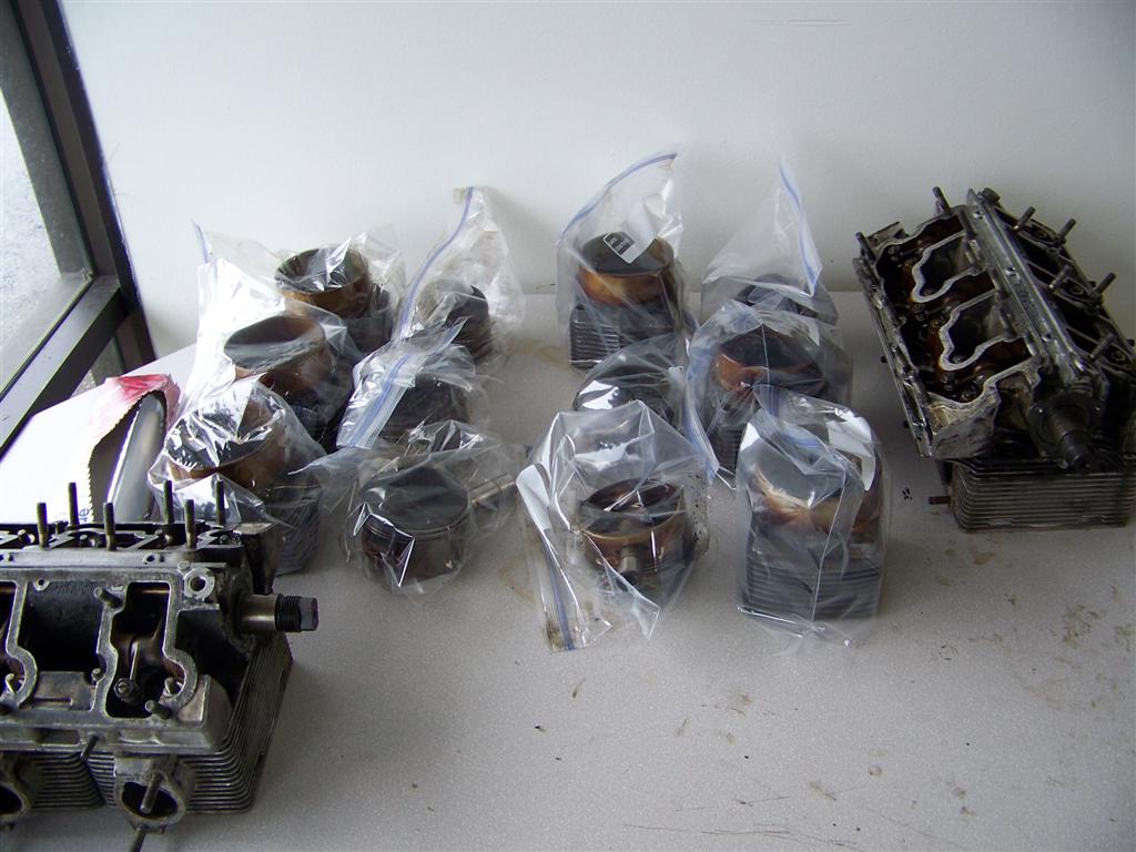

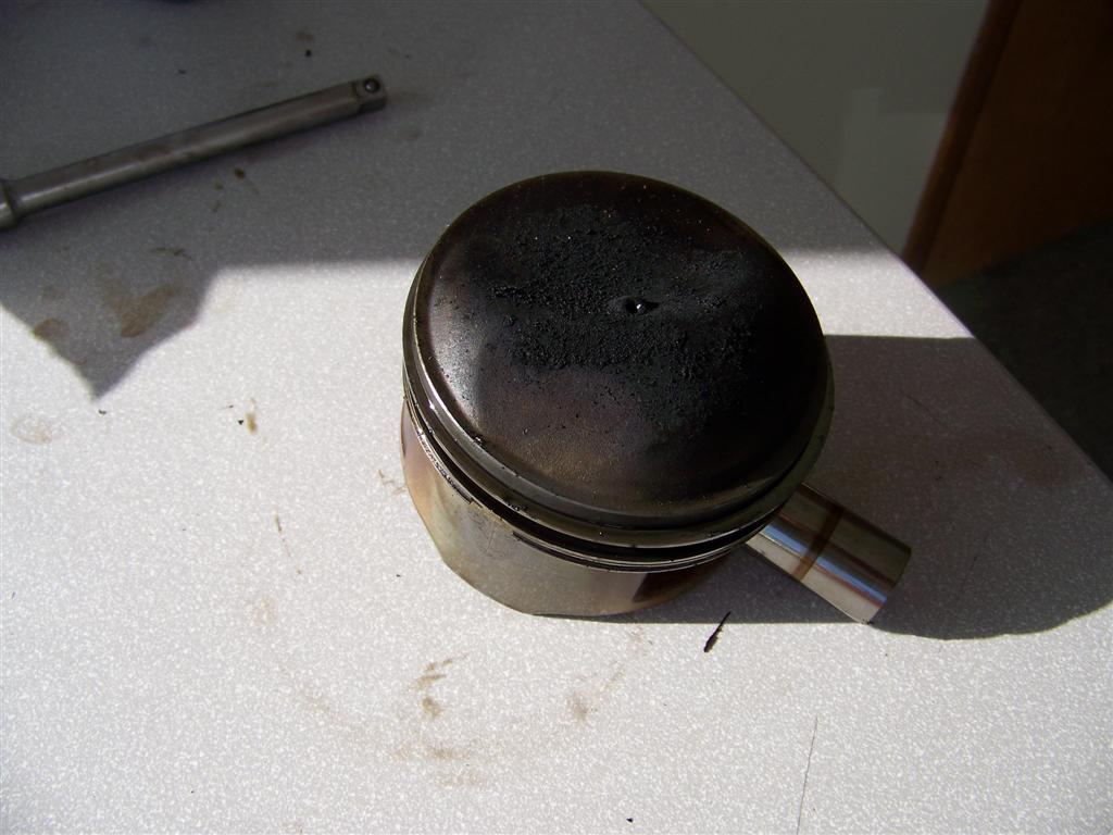

Next the pistons came out
I plan on replacing the CIS pistons

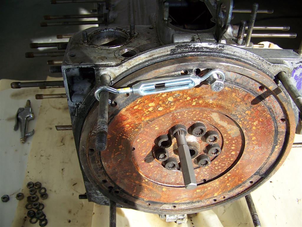

I rigged up a way to hold the flywheel in place while I unbolted it

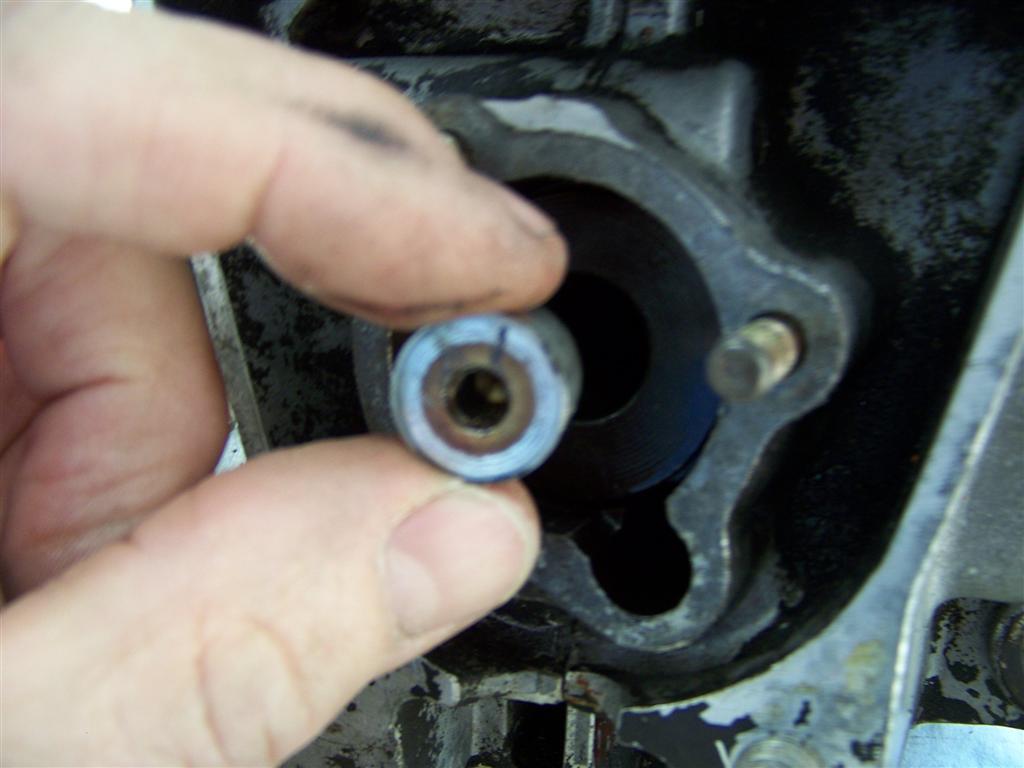

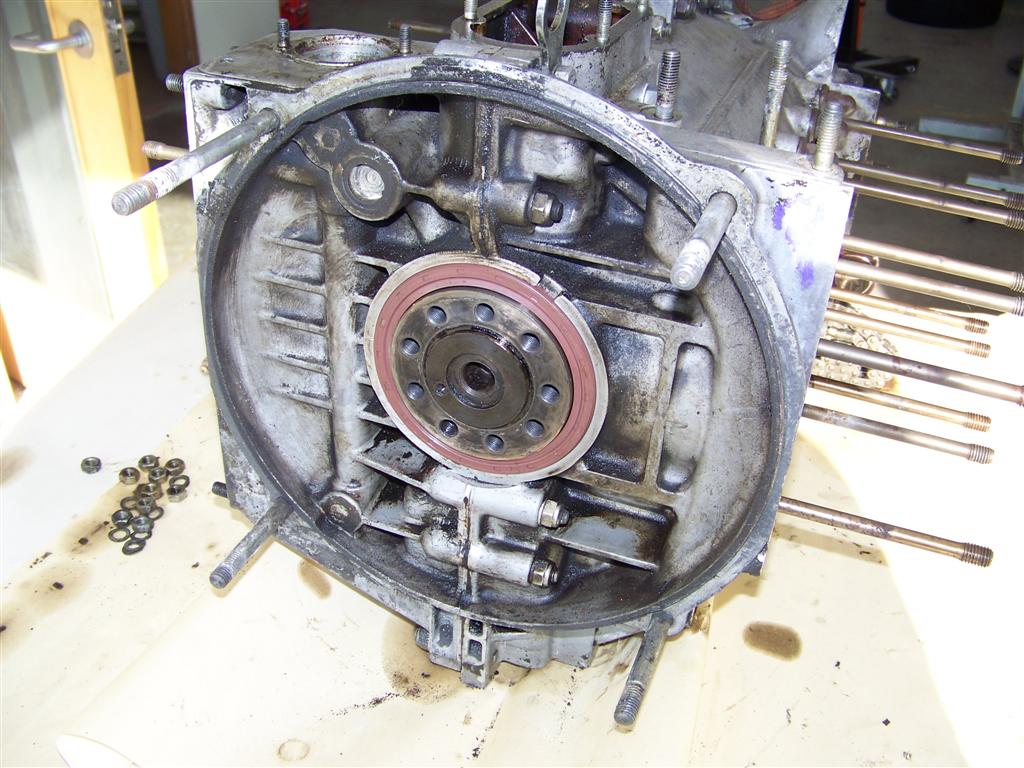

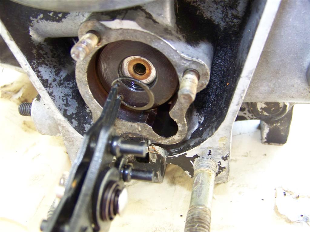

The back of the case
This clip that came out of the front of the engine
and the part that the clip held in place (whatever it is?)
Now I need to figure out what to do next.

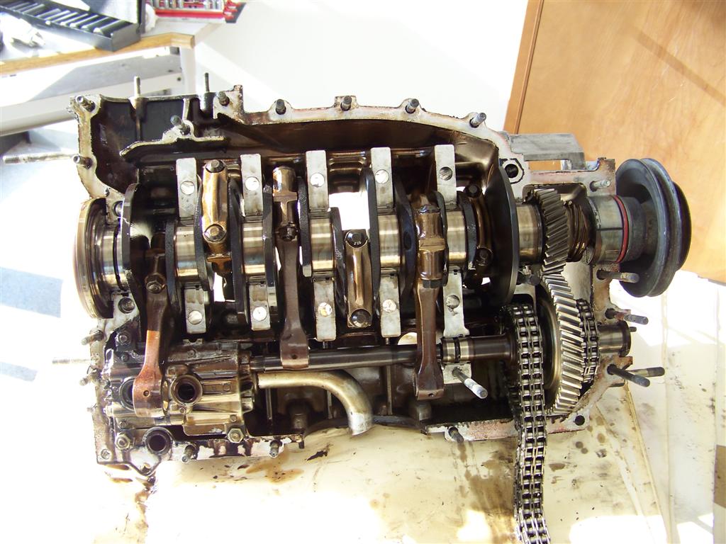

All the bolts holding the case together were found
And thae case opened up

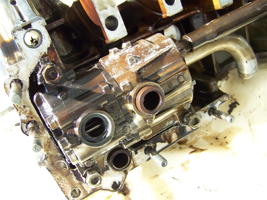

Then the oil pump was removed

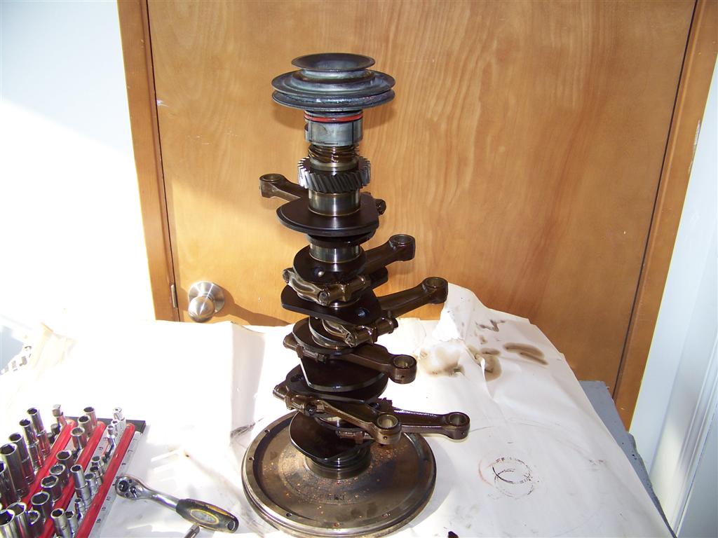

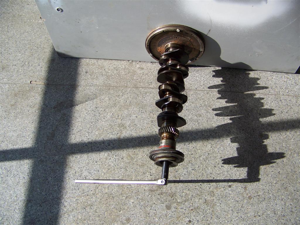

Today I worked on the crankshaft. First I bolted the flywheel on
so it would stand up

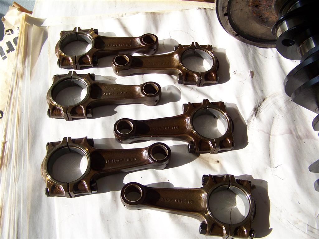

Then I unbolted the rods
Then I screwed the flywheel to a table and turned it on the side.
That way I could break the pully bolt loose. I tried doing it while it
was in the engine, but couldn't get the leverage. This way I could
step on the breaker bar. Made it easy.

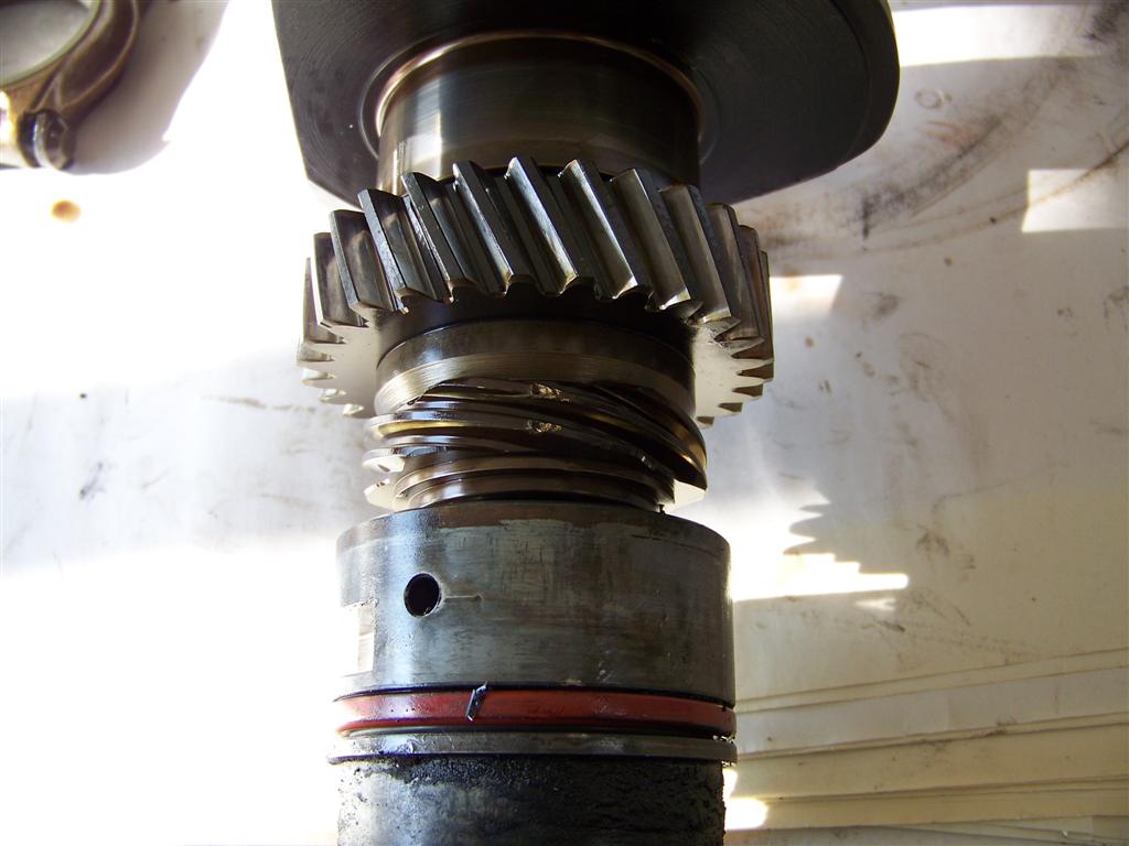

I see some damage on the gear where the distributor meets the
crank. I need to find the box that has the distributor and see what
it looks like.
Looks like its time to do some more homework. I don't know if I
should tear down the heads or leave that to the machine shop. Any-
body have a great recommendation for who should do the machine
work?
