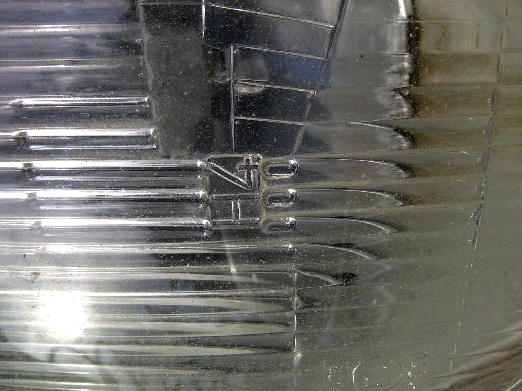

I must have the old style as I don't see H4 stamped on it and the gizmo on the inside looks like it is made of metal as best I can see. It has 2D1 stamped on the glass.
I wonder how much better this would be as compared to what I currently have and I would venture to guess I have to get the glass part of the H4 to go along with the bulbs as they go in from the back??
http://busdepot.com/details.jsp?partnumber=78155

Yes - you're going to need H4 headlights.
The good news is - they'll almost always come with at least one bulb set - but you must read the fine print. Some places try to lowball the price and sell them with no bulb - and then when you complain, use weasel-speak like "we couldn't know if you wanted a 6V or a 12V application..." Just read the ads really carefully before concluding you're getting a deal. They should clearly state whether you are or are not getting bulbs.
If your headlight has 3 bumps in the exterior glass, it is an almost certainty it's a sealed-beam -- they're for the automatic headlight adjusting machines to index. Hx lights use other means to aim, and have no external bumps.
Before jumping headlong into the H4 abysss, you might try something like a pair of Silverstar. They're not expensive and they are a hugs improvement over original.
