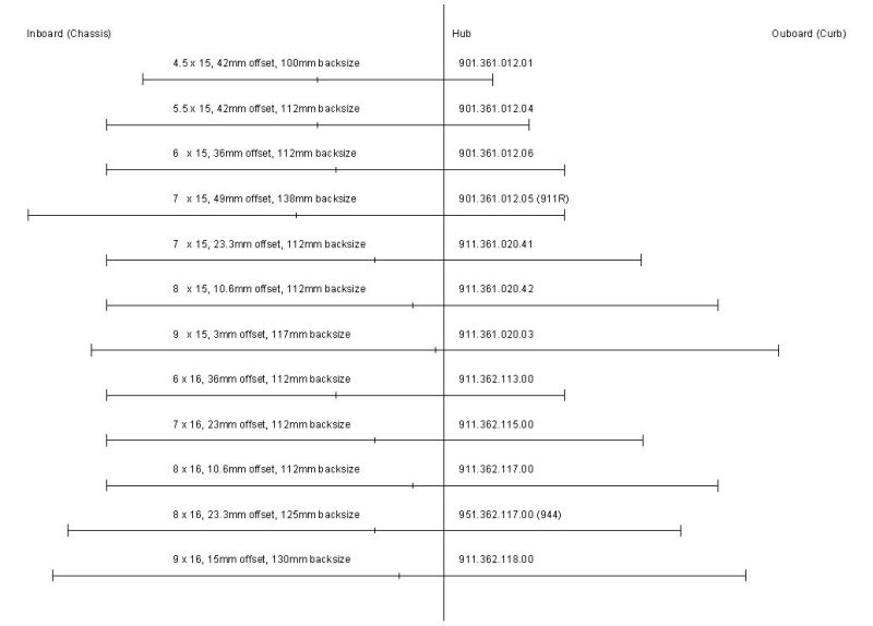

My Six with flares runs 16x8 951 wheels on the rear, and they fit perfectly without spacers.
your right they fit but are inboard and most like em out closer to the fender.
here is The Chart;

So am I correct in saying that both fit but the 911 offset fits a bit better since it's closer to the fender lip?
sixnotfour
post Feb 25 2012, 01:58 PM
Posts: 11,184
Joined: 12-September 04
Member No.: 2,744
QUOTE(jmill @ Feb 25 2012, 11:24 AM) *
Yes, has a deeper front lip look also,,
