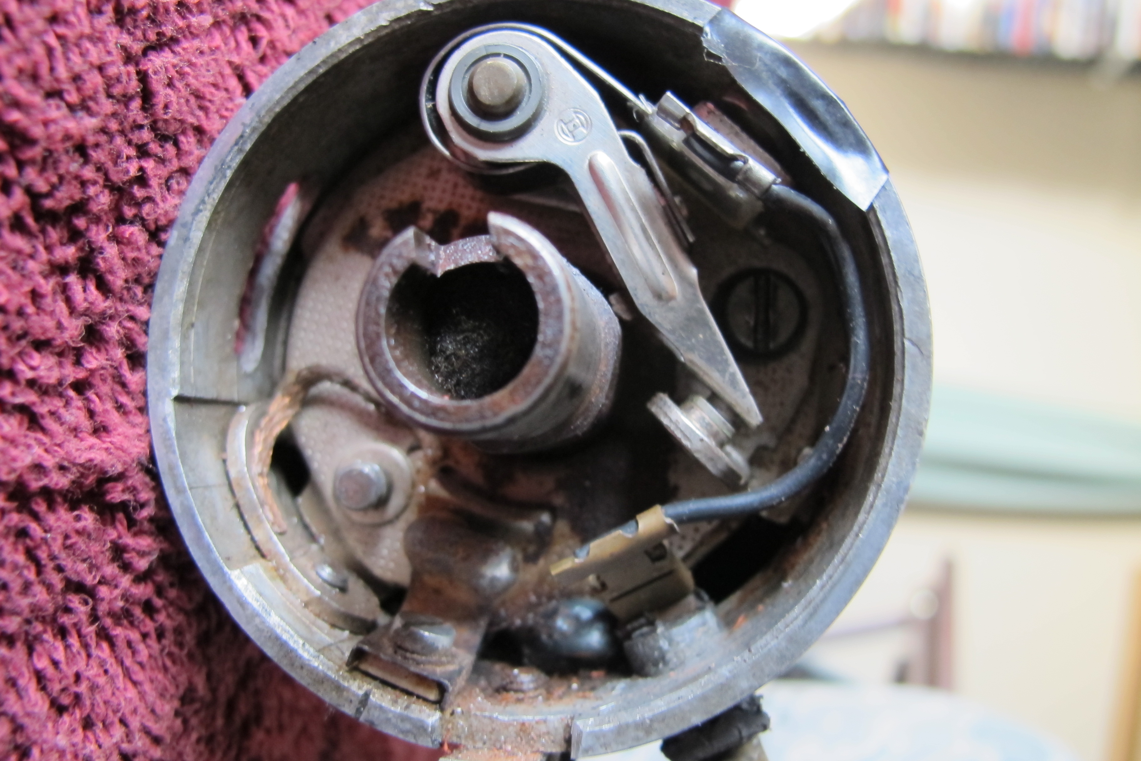

Pics of my Dizzy

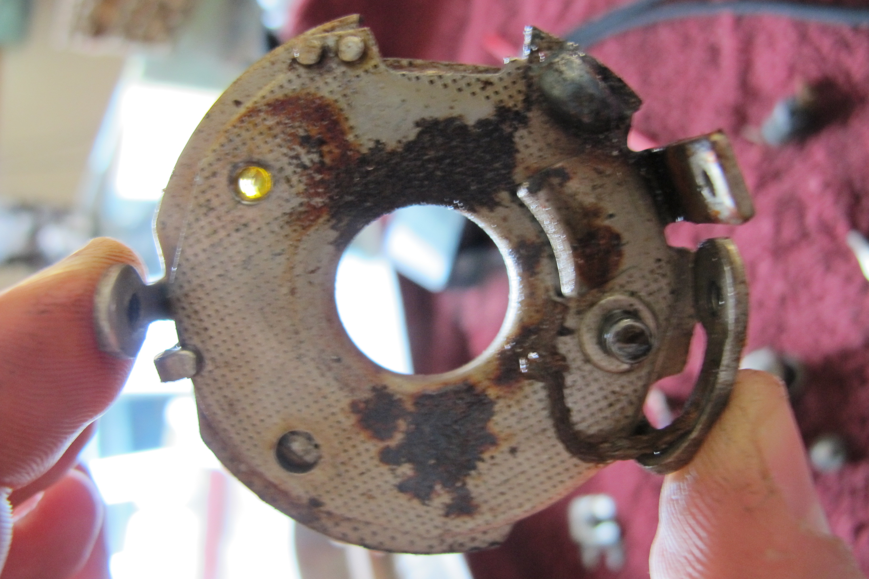

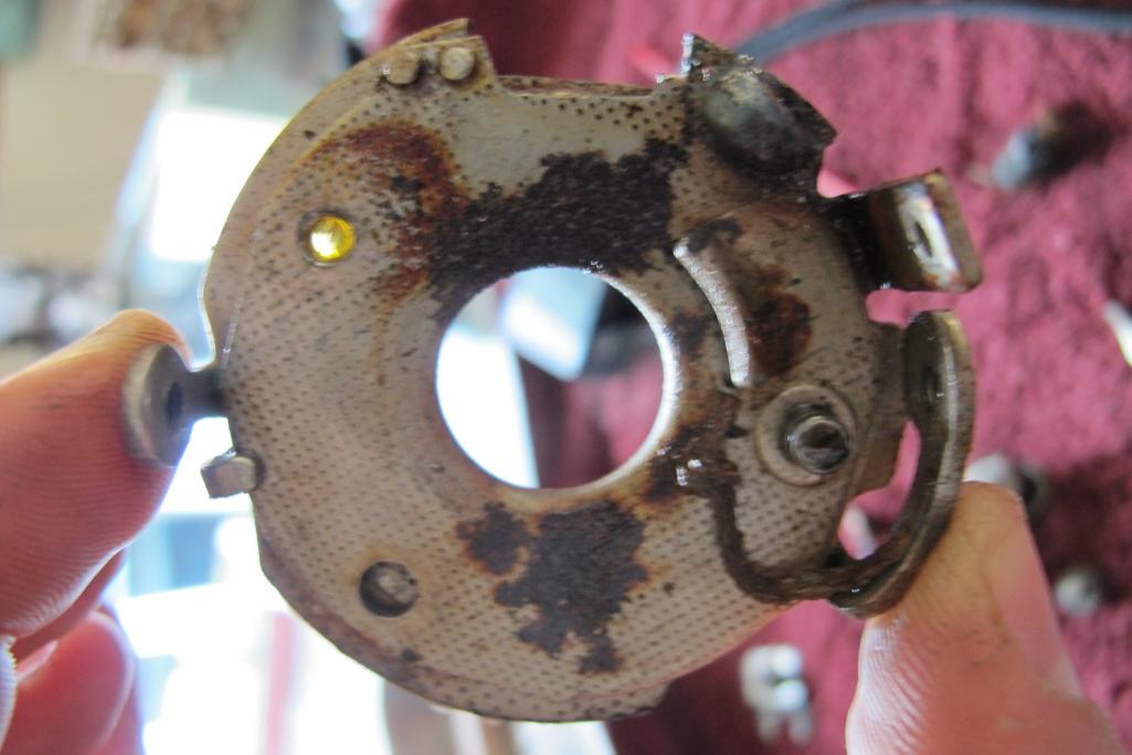

jcambo7
post Mar 23 2012, 11:48 AM
Posts: 1,702
Joined: 24-December 08
From: Graham, WA
Member No.: 9,867
More

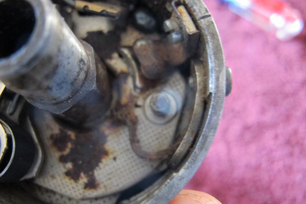

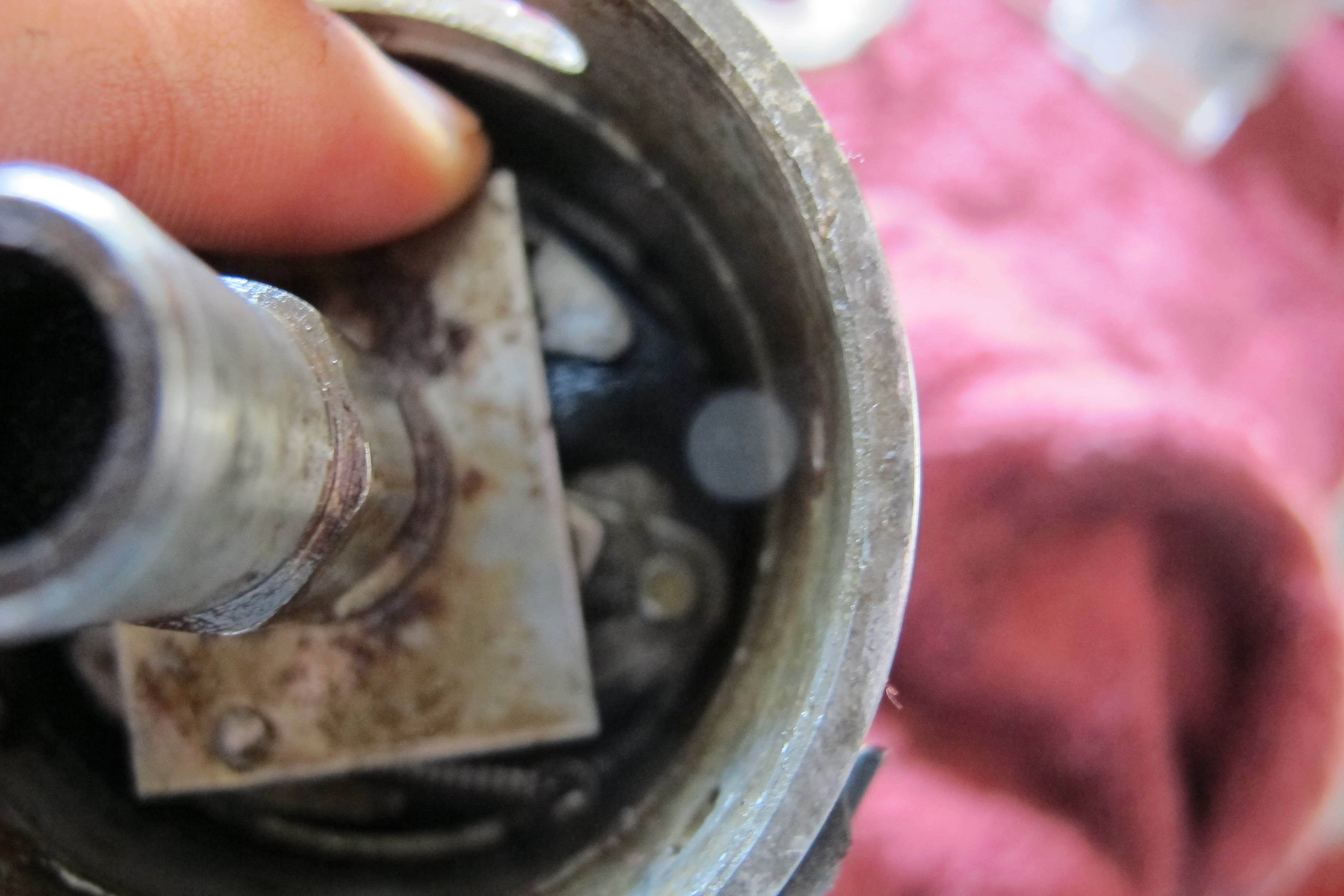

So I used some carb cleaner and than sprayed some PB blaster in it and the amount of movement I got when I turned the rotor was about the same. It seemed to spring back a little faster though.
underthetire
post Mar 23 2012, 01:09 PM
Posts: 5,062
Joined: 7-October 08
From: Brentwood
Member No.: 9,623
Spray it down the center. Maybe take a pick and remove the felt so it can soak in faster. That felt is where you put light oil. Like sewing machine oil. It's not the actual weights that usually stick, it's the two shafts, the top one kinda moves on the lower one that engages the drive.
jcambo7
post Mar 23 2012, 01:27 PM
Posts: 1,702
From: Graham, WA
Member No.: 9,867
QUOTE(underthetire @ Mar 23 2012, 02:09 PM) *
Where is this felt at? I was trying to take the two shafts apart with no luck.
