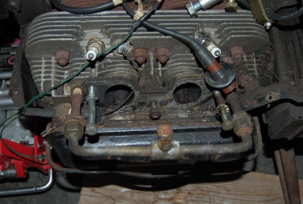

What the heck are these things sticking out of the heads...they were not on any of the 5 other 914's I've had????

PS them things sticking out are the air injector ports, remove them if smog legal to do so. you then plug the hole with a bolt. use plenty of penatrating oil on them, it might be needed.

It looks like the PO plugged them with the plumbing attached in the pic.
