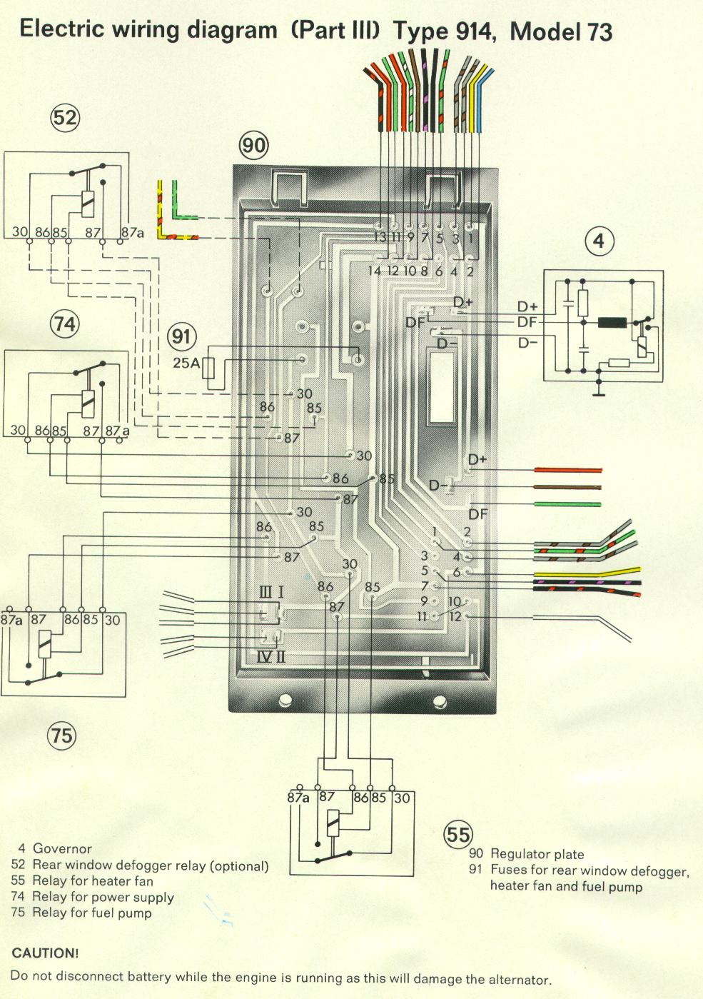

I actually have some time this morning, and am going to try to diagnose my fuel pump issues.
Got a multi-meter, got some help to turn the key, and got a local VW store I can get a new pump or relay from.
So, which relay on the panel in the engine bay is for the fuel pump? I have a SirAndy Jumper in there (see his classic article).
Also, my multi-meter has ranges. Which setting should I use to test for power to the fuel pump?
Thanks in advance.

KG6DXN beat me to it. The Haynes manual shows the same configuration through 1973. I didn't see pictures for 74-76.
To check for voltage, set you multimeter to a scale that will read 12 volts DC, say 0-50 depending on the meter.
This also assumes that a PO didn't "improve" the wiring, my FP was jury rigged off another relay.

With your multimeter on 50 volt scale, check pin 30 on the fuel pump relay for 12 volts. Should be there all the time. If not, your fuse may be bad. Second one from front. If that is good, check for 12 volts at pin 85 of the fuel pump relay with the key to on. If no power, your power relay ( second from front) may be bad or connections bad. If you have that and the ground is good, the relay should operate and provide 12 volts to pin 87 of the fuel pump relay ( same electrically as pin 13 of the 14 pin connector. If you have power here, your fuel pump is bad or has bad connections between pin 13 and the fuel pump.
Yes - have 12V there.
QUOTE(Tom @ Jun 9 2012, 12:04 PM) *
No power there. I swapped the power relay, with no change. So either I have a handful of bad relays (which I don't think that I do) or the problem is elsewhere.
Now where should I look?
Thanks again - this is very helpful.

I have had these relay problems before and found out the relays are OK but not making good contact with the female side on the relay board. Try taking a sharp knife and GENTLY pry the male prongs apart very slightly. This helps make good contact in the female sockets.
If you have no power at pin 85 with the key switch to on, your fuel pump relay will not work.

Not getting power to the pump at all. I ran my meter on it, no dice. I am also not getting power to the correct pin on the fuel pump relay.
So I am not sure where to go next. Ideas?
I spread the male pins on the relays to see if that helped, but no dice.
I was looking at SirAndy's fuel pump article, See here: http://www.914world.com/specs/SirAndyCarbFuelPumpRelay.php
If you look at his "Last Resort" method all the way at the end of the article, it says to run a jumper to that pin on T4b. I don't get power here with the key on either.
I am not sure that this is related, but it seems too odd.
Could there be an issue with my ignition switch or something by my fuse panel?
