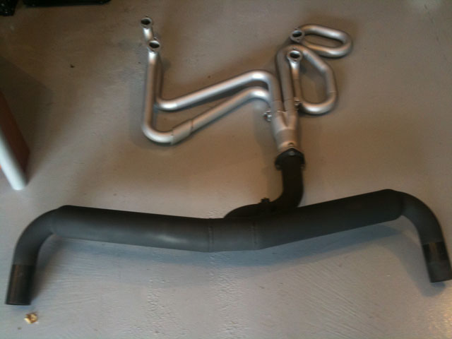

I would go either Triad or Tangerine. I've never heard the Tangerine personally, but I have no doubts about the quality. Triad systems have a GREAT sound and quality. I use to live about 45 minutes from Dave's shop and have bought two mufflers from him for different cars. I get lots of compliments on the exhaust note.
Triad
And a pic from a classified add here.
(IMG:http://www.914world.com/bbs2/uploads/post-7669-1335115392.jpg)

INteresting. That looks like Eurorace pipes to the collector, and then Triad from the collector back. Did Triad sell the entire system?
I had a Eurorace, but I could never get it to seal at the collector. Went back to SSI exchangers so I could seal my exhaust and also defog my windshield on the humid evenings and mornings we tend to have.
