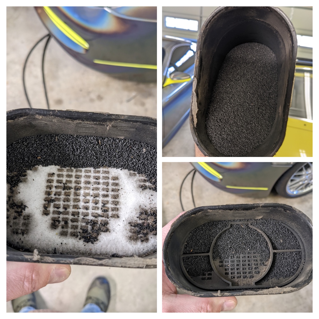

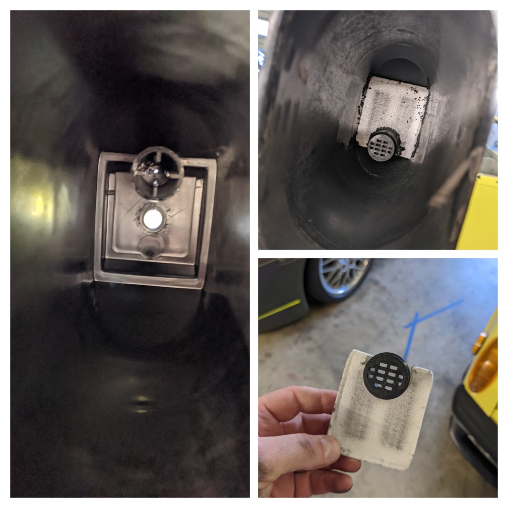

Van B
post Feb 8 2022, 01:47 PM
Post #39
Posts: 1,621
Joined: 20-October 21
From: WR, GA
Member No.: 26,011
Well, I pried open my canister today. And as suspected, it was filled with very small pellets that were getting sucked into the airbox, after the air filter! You can see that they were so small they worked their way past everything.
I need to find some fuel resistant foam for the small port. The foam plug that was in there was disintegrated. I tried to take it out to measure it, but it went full Avengers endgame as soon as I touched it lol.
wonkipop
post Feb 8 2022, 03:39 PM
Post #40
Posts: 5,480
Joined: 6-May 20
From: north antarctica
Member No.: 24,231
thanks for the look inside.
so what you are saying is where its turned to smaller dust sized particles its been getting past the air filter?
i've got a new air filter on mine and i will keep an eye on it now.
