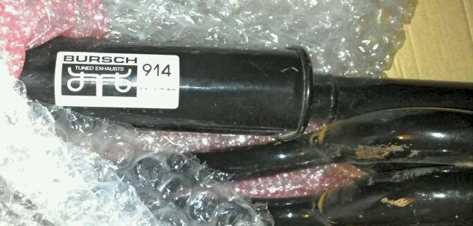

I have a brand new Bursch Muffler, I can't remember which model it's for.
1.7 or 2.0.
Does anyone here know how I can check it for GGW if someone knows where I should check once I remove the bubblewrap and "Microsoft TAPE"!

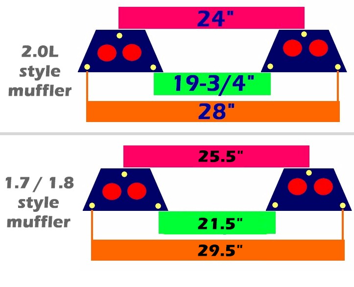

Different dimensions as shown in this graphic found in another thread:

The bolt pattern on the mounting flanges are different. Similar but different. The 1.7/1.8 flanges are higher up on the muffler. What engine do you you might save some bucks by replacing Just the muffler at a shop. You might need to remove the muffler for them to do it right

Well, answers that question.
If you look closely, the big white sticker says "73-74 2.0L"
Not for Catalytic Re-Conversions...
So, no go on a 1.7 Bursch...

engine displacement is less a factor than your heat exchangers with the exhaust options. verify whether you have 1.7/1.8, 2.0, or the 75' version hes before you purchase.
