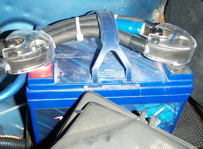

I think you should go with the GM alternator. I run a GM style Powermaster 180 Amp unit. There is no advantage to keeping the stock VR unless you intend to concourse the car.
Biggest upgrade for the buck is up sizing all wires. I run a #2 charge wire and have upgraded all grounds. I bet your stereo wiring is bigger than most of the stock 914 wiring. Add extra grounds, bigger wire. Add a ground from the alternator to the battery.
If your amplifier has a 20 amp fuse, that means it can take spikes of current up to 20 amps. The factory alternator charge wire is a #8. This is barely adequate for 20 amps of DC current. The car battery acts like a buffer, not allowing all that current into the battery at one time to recharge. This is mostly due to internal resistance. Your amplifier need instant current flow. Here is the advantage of a charging capcitor. The cap will charge and discharge instantly to help out.
Most people do not realize that DC current takes a bigger conductor than AC current. Because of this, most will quote AC amperage charts. The world realized this and chose Tesla's AC power over Edison's DC power. Edison needed a 4" diameter conductor to push DC down a single block of homes. Tesla only needed a 1/4" conductor for the same distance with AC power.
When I was manager at a car stereo shop (and master installer), we would use #8 amplifier wires at a minimum. We also upgraded the ground from battery to chassis and battery to engine block. This worked well for night time headlight dimming problems.
The wiring and chassis on your 914 is old, rusty and corroded after 40 years. The wiring has reached its life span. The unit body is now grounded through rusty metal and spot welds. Start with upgrading your wiring first.

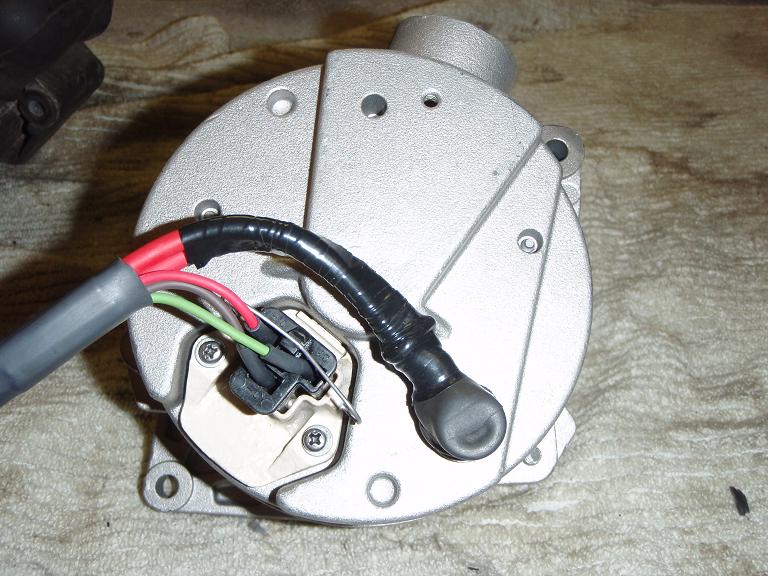

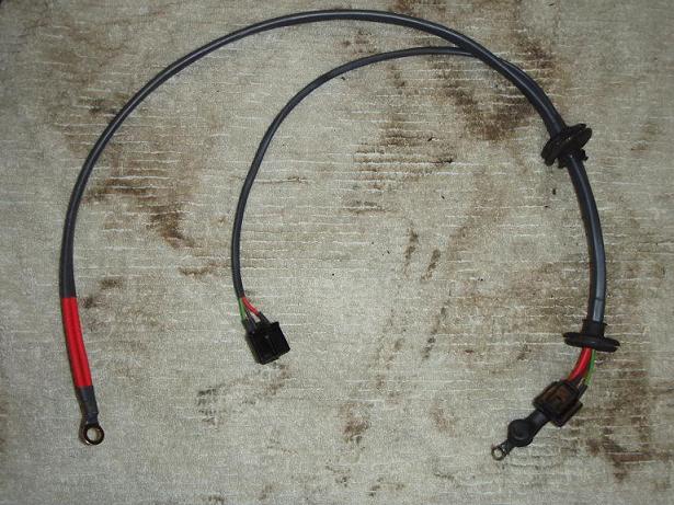

As far as an easy swap, the 75 amp alternator from a VW bus fits right in, I have pics in my Blog with side by side pictures. That gives you an instant 25 amps, or bring it to your alternator guy, I had the 75 amp rewound to 120amp
Hasnt blown anything up yet

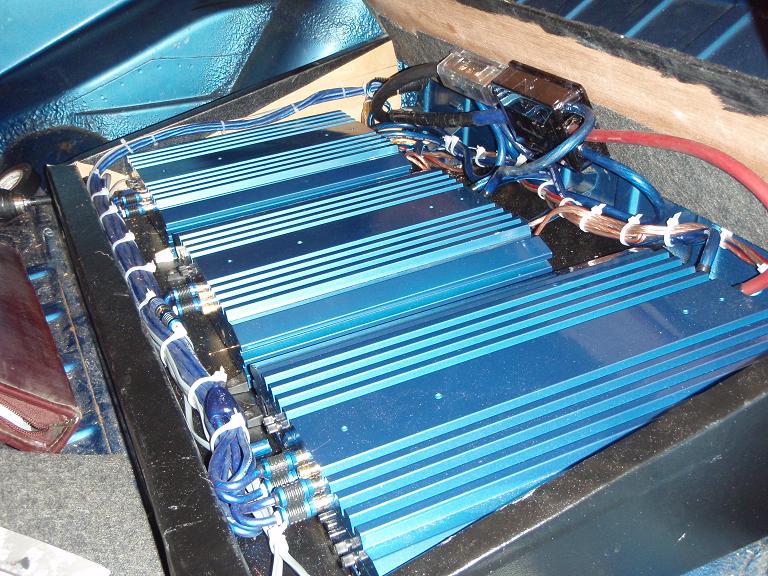

The stereo bumps, i mean it really really pushes in on your chest (IMG:style_emoticons/default/biggrin.gif)
And the wiring was all upgraded. Everything is brand new, from the custom Jeff Bowlsby harness with 2 runs of 8g wire, then the o gauge power and ground. then I added ground wires from the alternator bolt to multiple ground points in the engine bay.
Yes the wiring can handle it. None of my added electronics are using stock leads. I run power and ground from the battery all the way up to the Desmazes Delayeator.
