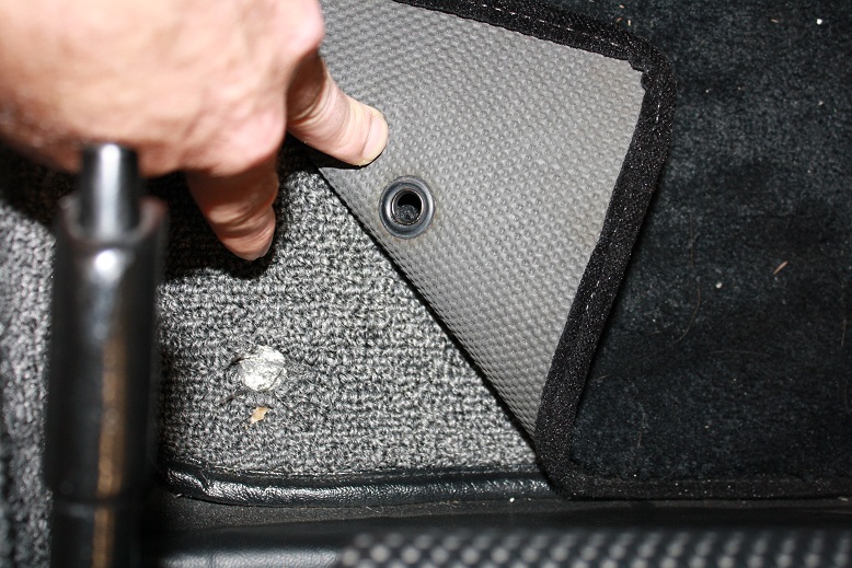

So I have some nice looking floor mats. They sit on top of my carpeting. Only one small problem; after a while of driving they begin to bunch up on the accelerator pedal and keep my idle up. (IMG:style_emoticons/default/mad.gif) (See first / top pic)
I keep having to reach down under the front of my seat and pull them back.
They have grommets for keepers but they don't line up with the stock pegs. (See middle pic) I was hoping to utilize the stock pegs. I have seen aftermarket generic clips (see Last / bottom pic). I was hoping to utilize the stock pegs...
I was hoping that someone else has solved this problem and could make recommendations so as to avoid a trial and error experience for myself.
Thanks in advance for the assistance.
Pete (IMG:style_emoticons/default/smile.gif)

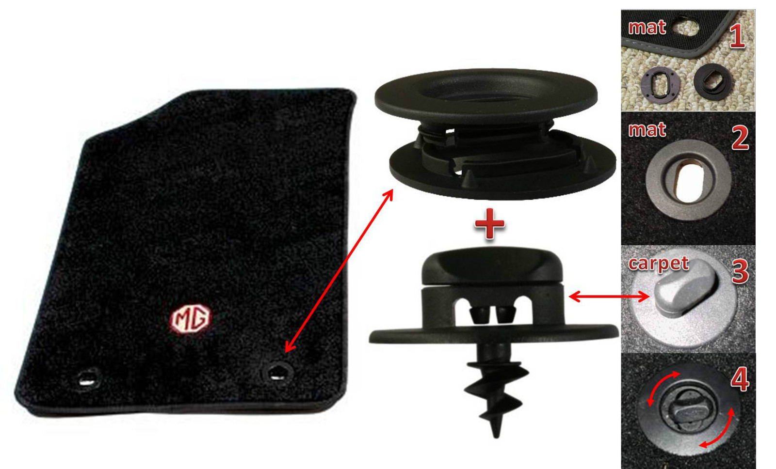

Check JC Whitney. They used to have the oddball offerings similar to this. Also, some OEMs used to make extended carpet pins that also rotated 360° (don't know why) and had the modern hook type pin. You may have to call a auto carpet retailer to see wgat they know. Lastly, hit a pick'n'pull or similar and see what the donor cars of different makes have...

The extending post type is something that I have seen before that I thought might work. I can't remember where however (IMG:style_emoticons/default/confused24.gif) rrrrr. Last resort is a U-pic-a-part.

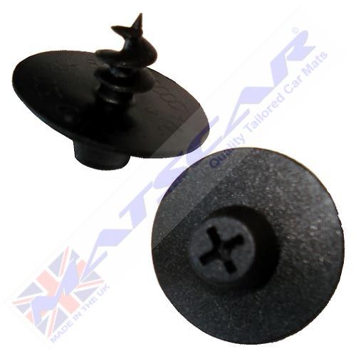

found a newby ebay seller from Greece with a good looking product.
http://www.ebay.com/itm/Car-mat-fixing-cli...ies&vxp=mtr
pnewman
post Sep 12 2012, 10:51 PM
Posts: 371
Joined: 15-February 05
From: Lincolnshire, IL
Member No.: 3,606
I am considering a carpet screw specialty rivot. super simple.

I do think however that the "pin screws" shown (the little specialty grommets with philips heads and plastic screw shanks below) would only screw into the carpet and rubber beneath and not through the metal floor. ...I think.

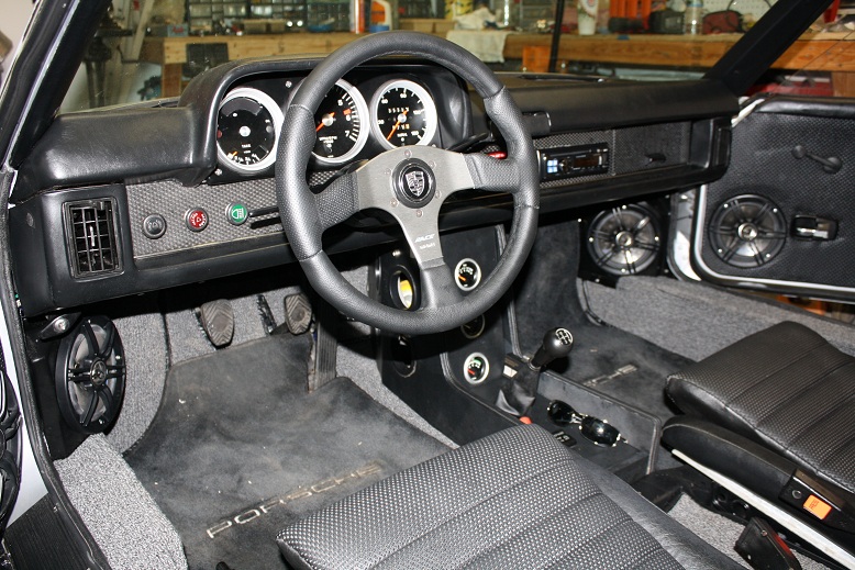

Finished / Installed.
I did almost exactly that...
Bought raw mild steel wire rod.
Bent
cut
welded the loop closed.
spot welded the wire together to reinforce it.
media blasted it.
Primed and painted
Heat shrinked the end that I would occasionally step on that also came into contact with the other metal (grommet) so as to minimize electrolisis.
Used a stainless steel truss screw to secure it to the seat cross member.
Pics to come.
Works absolutely perfect! Plus no holes in the carpet or the floor!

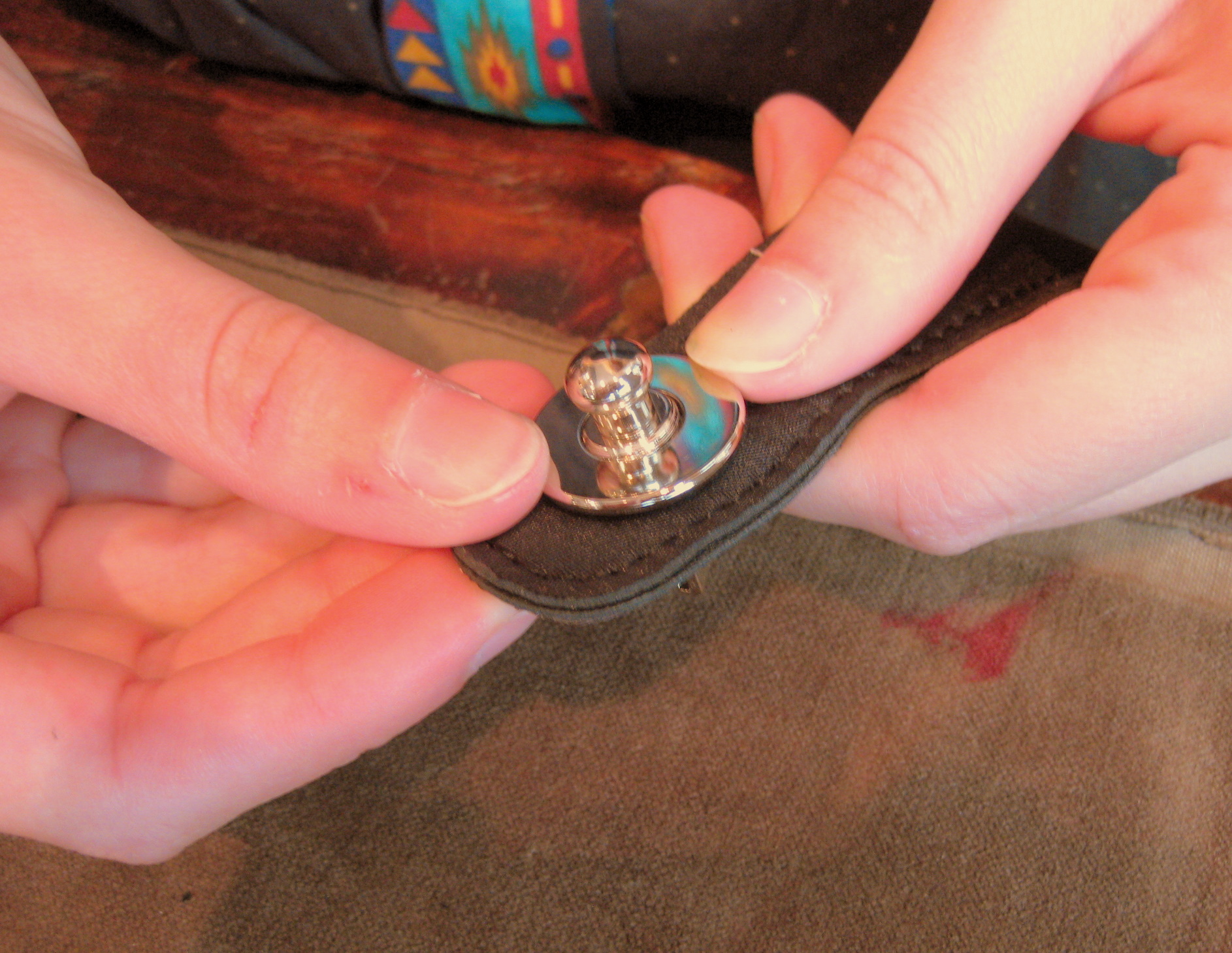

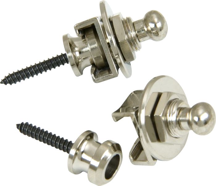

I have an idea from the music industry. Strap lock. Hard to describe but it would work perfectly with our existing floor posts. I'll try to get a picture.

That would be a very nice finish and they are available in a multitude of finishes at that. Black Chrome would work. It would seem that they would have to be installed through the floor for my specific application however. Found some pics.
Let me know if this is what you were referring to.
