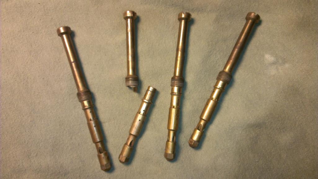

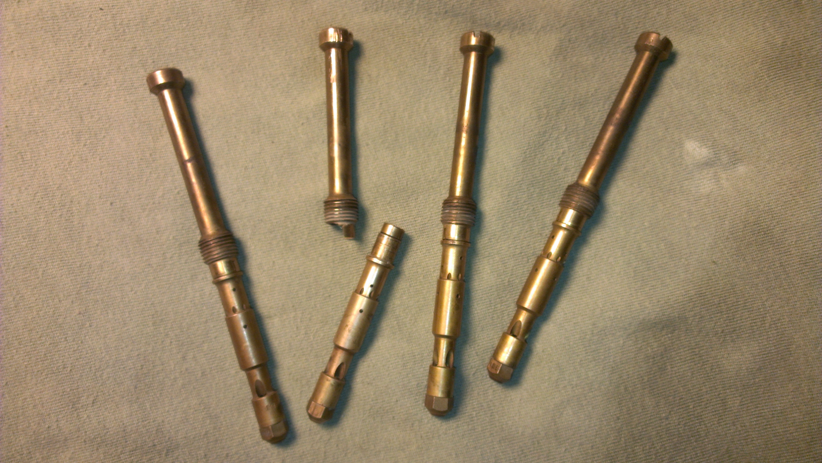

In the process o trying to get the car to run smooth I have removed the jets from my Webers.
If I understand this properly there are three pieces: tube holder, jet, and cap.
As I removed them, one jet had come out of its tube holder and was sitting in the carb. A little coaxing and pressing and I was able to remove the jet fine. I thought I would squeeze the tabs on the holder a little so it would hold the jet better; but in doing so a tab broke off. metal seems very brittle.
Tube can hold jet ok but I think I need a new tube...are these available?
If the jet was not pressed tight into the tube; would it affect performance?

Also what is the best way to clean these?
I can see light through the little holes in the tube. And just a little light through the bottom slanted holes. Not too much light on the bottom and one jet...very little.
Varnished? Can I clean these or just buy new ones? ...are they costly?

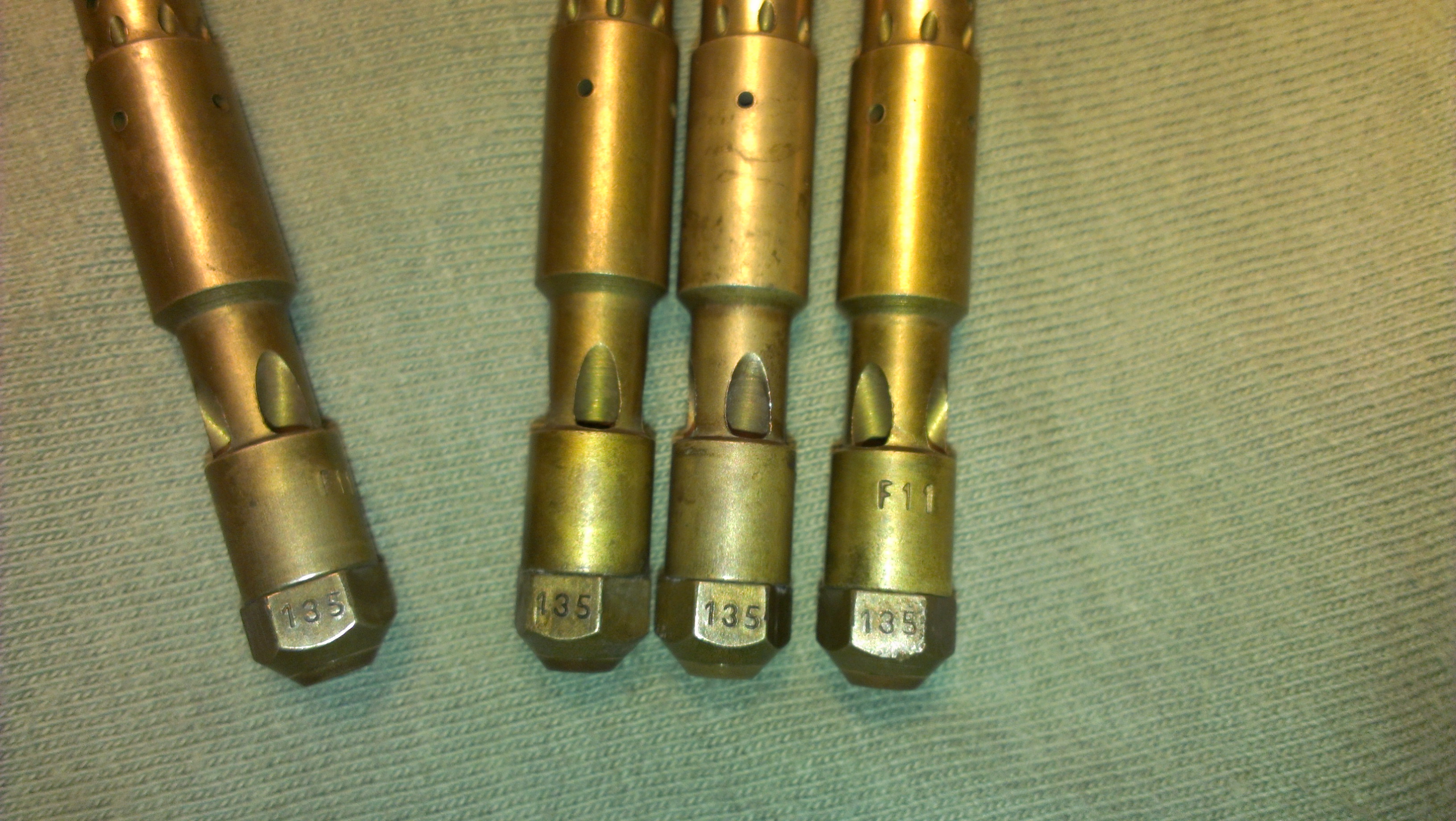

So when you guys are tuning carbs...which piece is changed?
Is the jet #11 ? or #135?
Just curious...last guy who tuned it says he changed the jets.

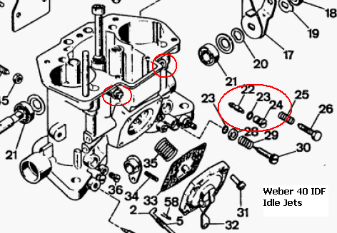

Those are your main jets listed as 135, but if you are having problems with idling then you need to pull your idle jets
(IMG:http://www.914world.com/bbs2/uploads_offsite/www.chircoestore.com-10399-1350325800.1.jpg)
which are behind flat head screws below
(IMG:http://www.914world.com/bbs2/uploads_offsite/www.mydune-buggy.com-10399-1350325800.2.gif)
they would clog and the engine would have a hard time idling and running below 3000rpm.
I would just blow them out like blowing air through a straw

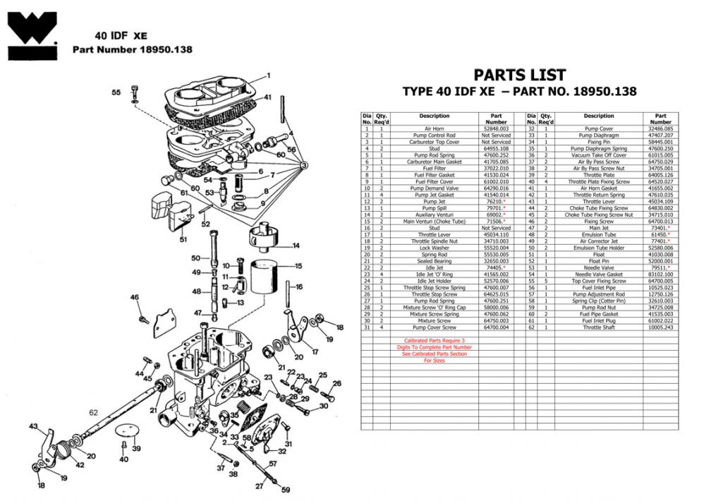

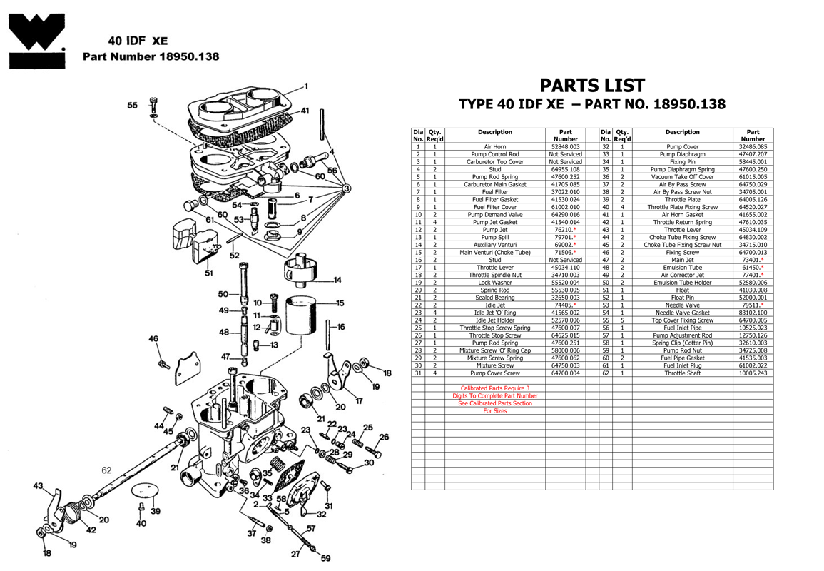

Check and clean the accelerator pump components as well (items 10~13 0n the diagram, 2 per carb).
Another item, assure the floats (51) are adjusted properly. You'll need to remove the carb tops to access them.

As to which jet sizes folks run, again, don't do anything until you have a baseline reading with the configuration you currently have. You may already be jetted for the optimum A/F ratio. Each engine is different and there isn't a single magic bullet configuration to follow.

item #23 (small o-ring that seals the idle jet holder) is VERY important. inspect them for for cracks and they may even be missing. i'd just replace them and be done with it. contact AIR COOLED ENGINEERING (801-747-3341) for the broken main stack holder and i imagine the o-rings are in stock.
