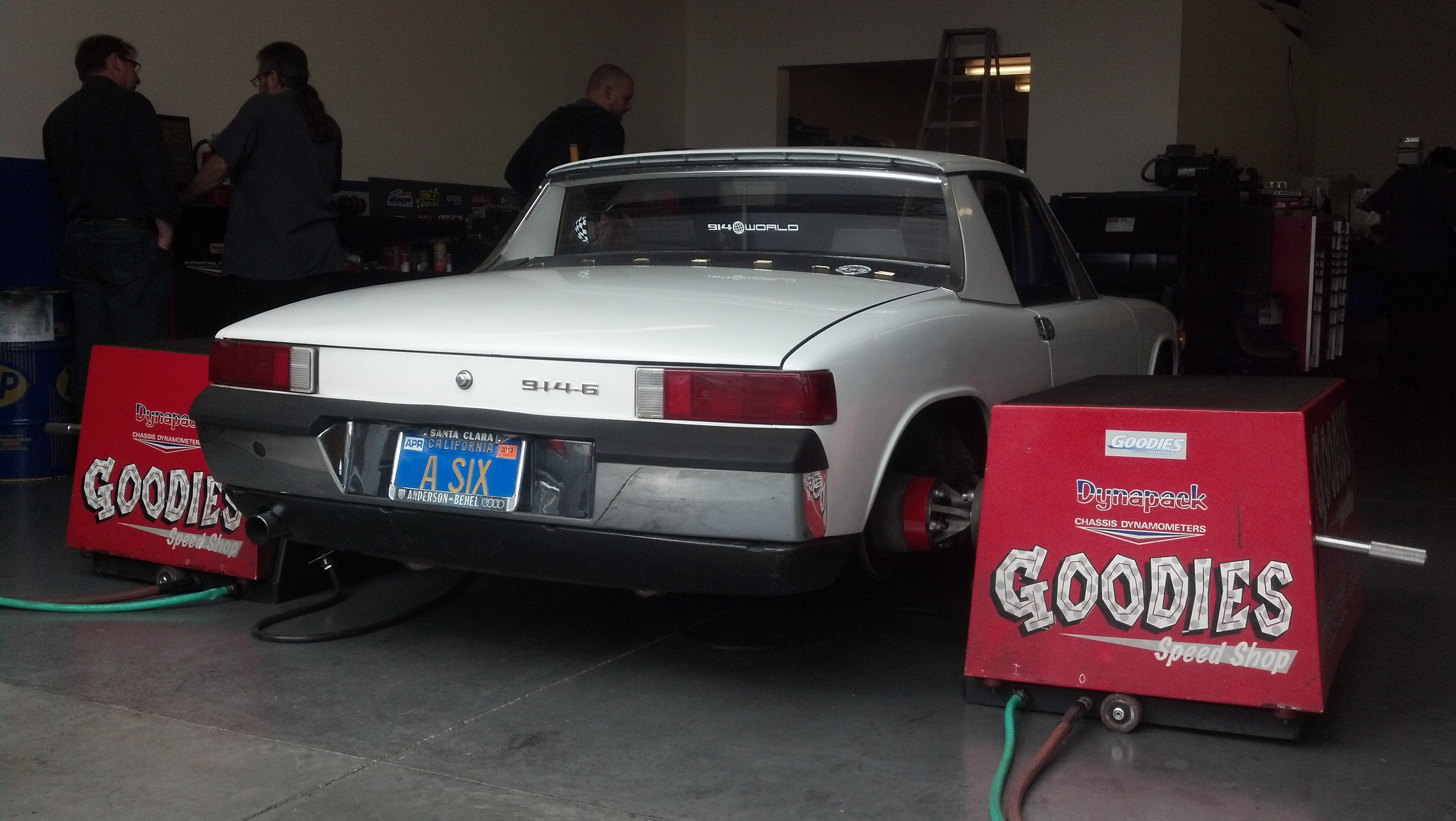

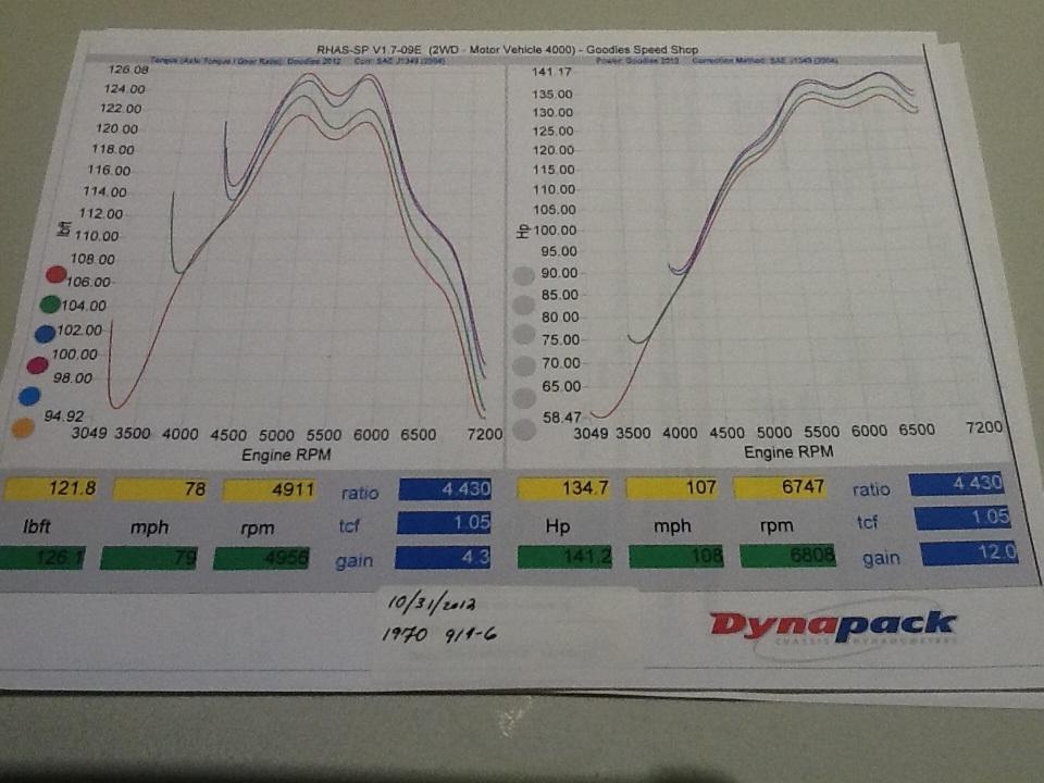

Today I had there afternoon off and went to a local shop to get a dyno run on my car to see what it actually produces rather than me guessing on what it produced. The local shop was running a special of 3 pulls for $85.00. The shop actually did 4 pulls and we awesome with me and my car. They are used to seeing high HP muscle cars etc but didn't pick on my car too much for being so low in HP. They did the pulls in 4th gear. The shop uses a dynapack dyno that bolts to the hubs which I like as there is no need for tied down points. Overall I am happy with the results as the engine is now 40 years old without a rebuild yet. It is a 2.4 liter 911S engine with MFI and produced 141.2 at the wheels.
What would cause the power to drop consistently between 6000 and 6500 Rpm? It drops and come back on again.

did they run an Air fuel ratio while on the dyno?
I'm guessing your AF ratio might be contributing to the power curve your asking about

While not real common with the S pumps, there's always a chance the 3D cam is worn. Also, you could have an issue with the pump/throttle plate correlation. That's the first thing to go soft in an MFI engine, and the easiest thing for an inexperienced tech to mess up, especially without the proper tool set. While the redline is 7300 RPM, the max power output on a 2.4 S is at 6500 RPM. You can expect a bit of a drop off between those numbers.

Here are some dyno graphs from various 911 Carreras . That upper RPM dip on your early engine is not there on the later engines ...... so it may seem to be timing or caburation issue?
http://www.911chips.com/dyno.html

worn 3d cams would still change the air fuel ratio
you need to make the runs with A/F measurements

Put a af sniffer in the tail pipe and don't ask for best guesses. 99% it's af problems probably caused by metering controls that have gotten old. It could be only vibration of some connectors that just need replugging to get recleaned on their contact surfaces. When power falls off and comes back it's usually a worn throttle position or cam sensor on later stuff or fuel supply. If it gets comlicated also check the 12 v power supply that it stays up at higher rpms. My shadetree experience says manifold size, valve size etc doesn't cause dips in power. That is caused by sensor feedback or metering glitches. Fuel pressure, timing and so on.
I would do one pull in 3rd to see if a shorter interval doesn't show the dip. If it doesn't then suspect fuel supply or still maybe vibration.

I asked all those questions to see what if anything was done to the motor, NOT as a diagnosis in and of itself. Many mods can throw the COMBO out of balance ........ intake system changes can affect intake resonance which CAN manifest in power dips or spikes. Obviously there are other things that can cause this but one should start by getting the most information of the base platform first.
