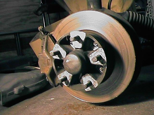

when you look at the front hub it'll be painfully obvious if you have aluminum or steel hubs....
first picture stock hub re-drilled:

QUOTE(Mueller @ Jun 18 2004, 09:06 AM)
This is exactly what it looks like except for the sorry shape the braking surface is in!! (IMG:style_emoticons/default/biggrin.gif)
I guess I've got redrilled rotors. Anyone know a machine shop in San Diego that will redrill rotors?
