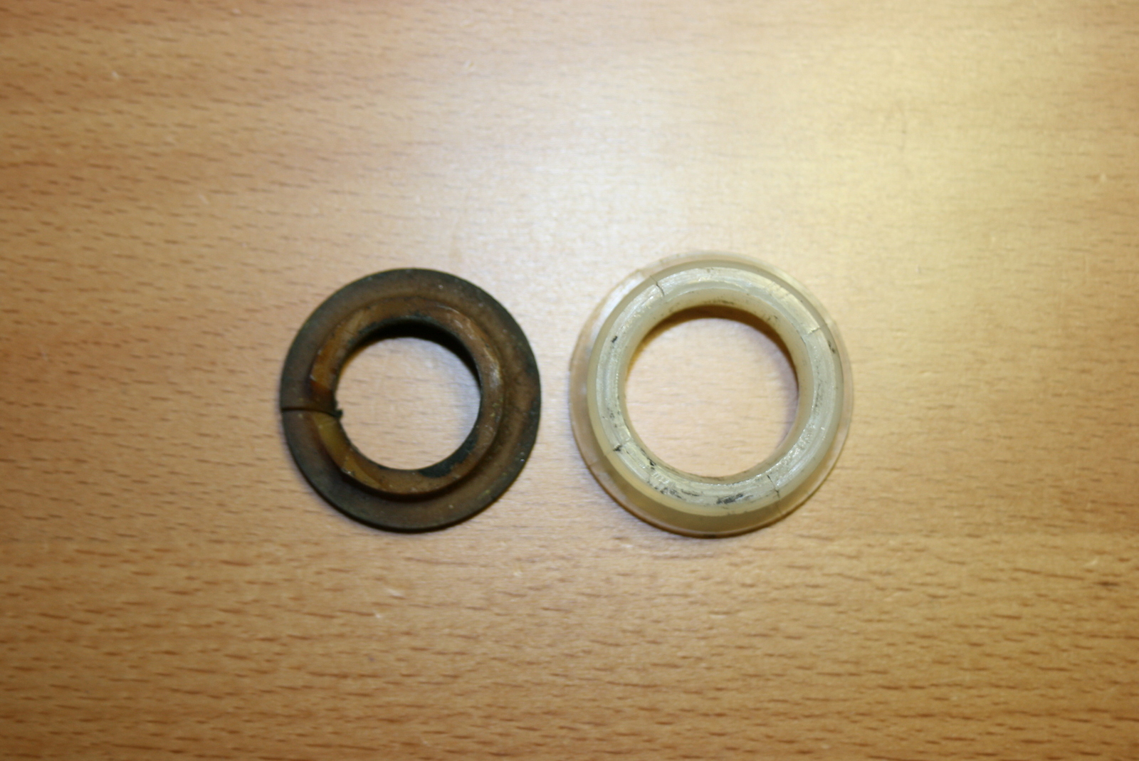

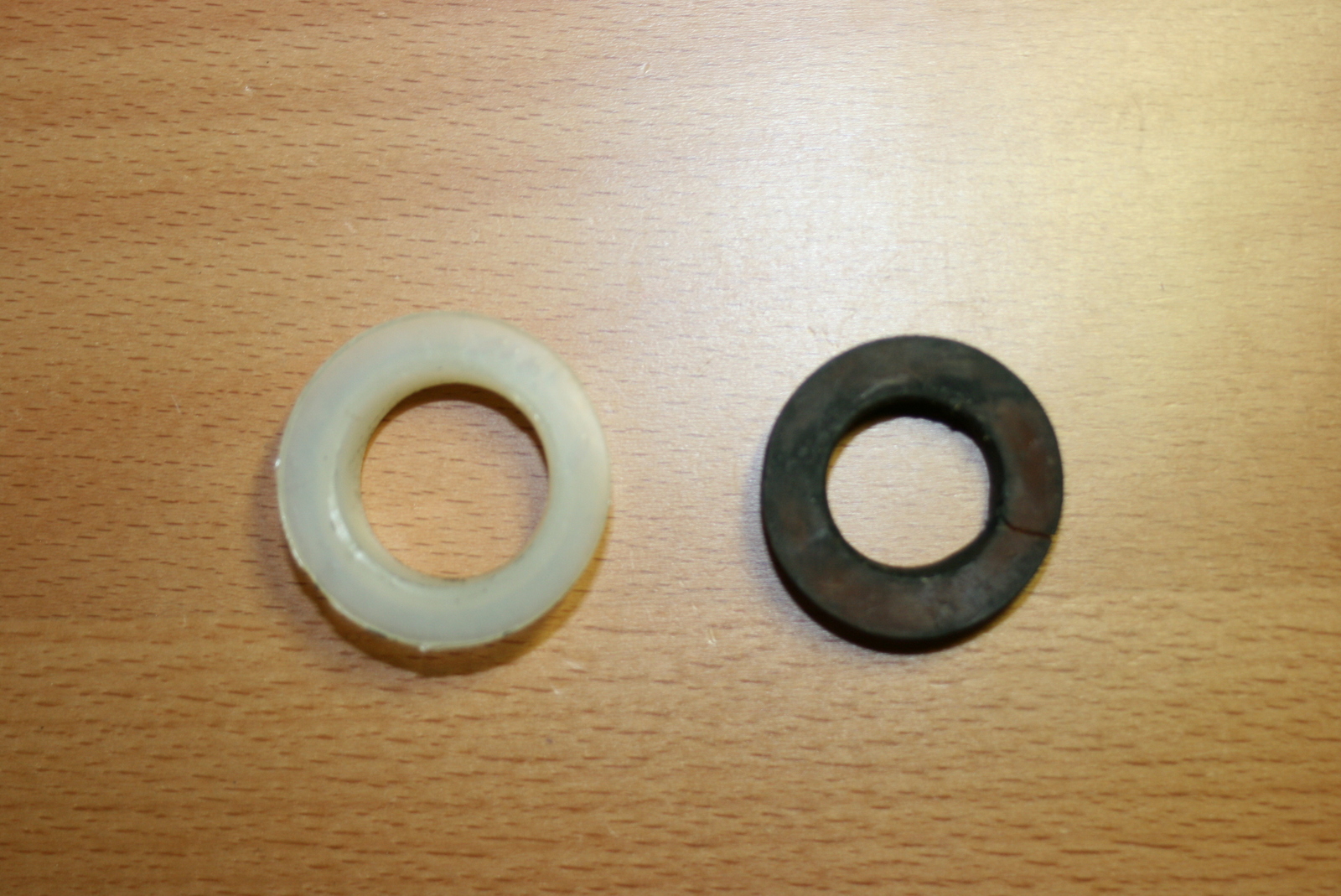

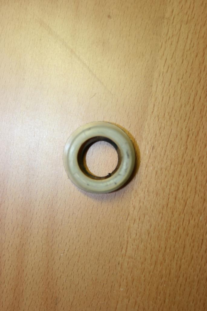

Went to replace my firewall shift bushing today ('74) with the AA "replacement" R91442422400 O.E.M. SHIFT SLEEVE / AKA FIREWALL BUSHING
Funny thing is, the two pieces seem to be much different sizes - the new replacement being bigger
The last pic show best how the ID of the original bushing is about 3/16" smaller than the replacement (original 13/16" ID, replacement 1" ID).
AA's site lists 4 different looking parts for with the same part number.
Pelican lists 3 variants of the 914424224: -00 M260 (OEM for the 1.7L, 3 req'd per car), -02 M737 (Hamburg Rear Shift Rod Bushing) and -03 M260 (OEM 2.0L Firewall Shift Bushing).
Bird Board Shift Bushings
Looks like I need the -03 M260 and that I have an -00 M260??

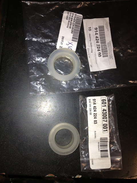

Here are the tailshift (914 424 224 00) and sideshift (914 424 224 03) firewall bushings. I think you need the 03. If you haven't already ordered it from Pelican PM me a shipping address and I will send you the one in this pic.

sfrenck
post Dec 23 2012, 08:03 AM
Posts: 492
Joined: 28-February 10
From: Wilmington, DE
Member No.: 11,411
QUOTE(shuie @ Dec 23 2012, 08:22 AM) *
Thanks for the offer Shuie (IMG:style_emoticons/default/biggrin.gif) ... but I placed the order last night (IMG:style_emoticons/default/sad.gif)
