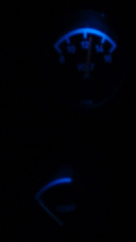

Just thought I'd post some pix of an experiment I did with some 10,000 MCD Blue LEDs. I got them on ebay from a guy in Hong Kong. No problem w/ shipping. You are looking at a temp gauge and a voltage gauge. There are 3 leds per gauge.
Just use a 330 ohm(*1/2 watt) resistor per ea. easy to get, easy to solder. Use shrink tubing to keep them from shorting.
*These LEDS use 423mW @ 12v...3 of them use 1.3w... The stock bulbs use 2w so there is no need to worry about the fuses.

Here is another picture...They are plenty bright enough. I plan to do the whole dash in blue. I purchased 100 leds for the project. I also got 100 10,000 mcd RED leds for signal/marker lights.
