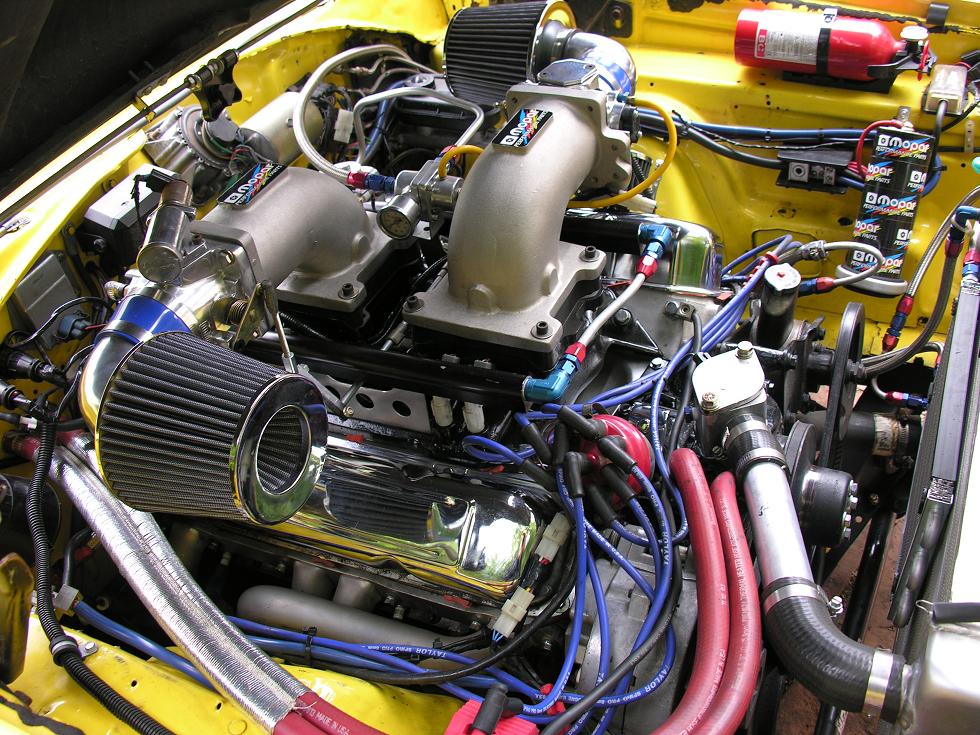

I have run aluminum soft drawn (specific for fuel) on many cars without any problems. I have a mandrel bender and they make very nice lines. The are designed for A/N fittings and is available from Summit Racing.
Using hard aluminum or copper is bad. It will crack.

Summit and Jegs only sell the soft drawn. A piping wholesaler will sell hard tube. If it is in a coil, it usually is soft drawn.
Here is some on the fuel rail of my Big Block Mopar.
