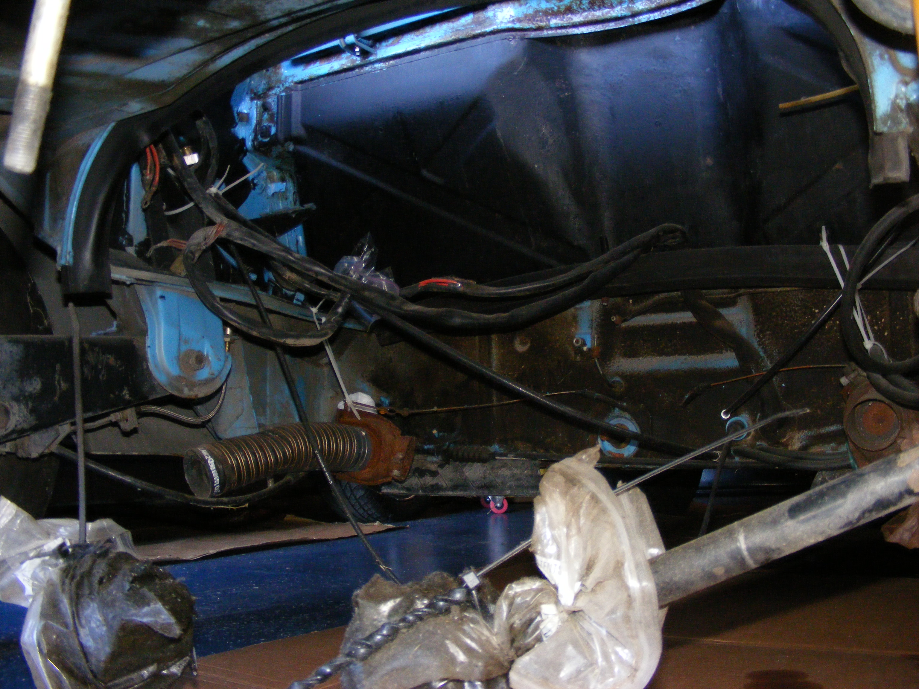

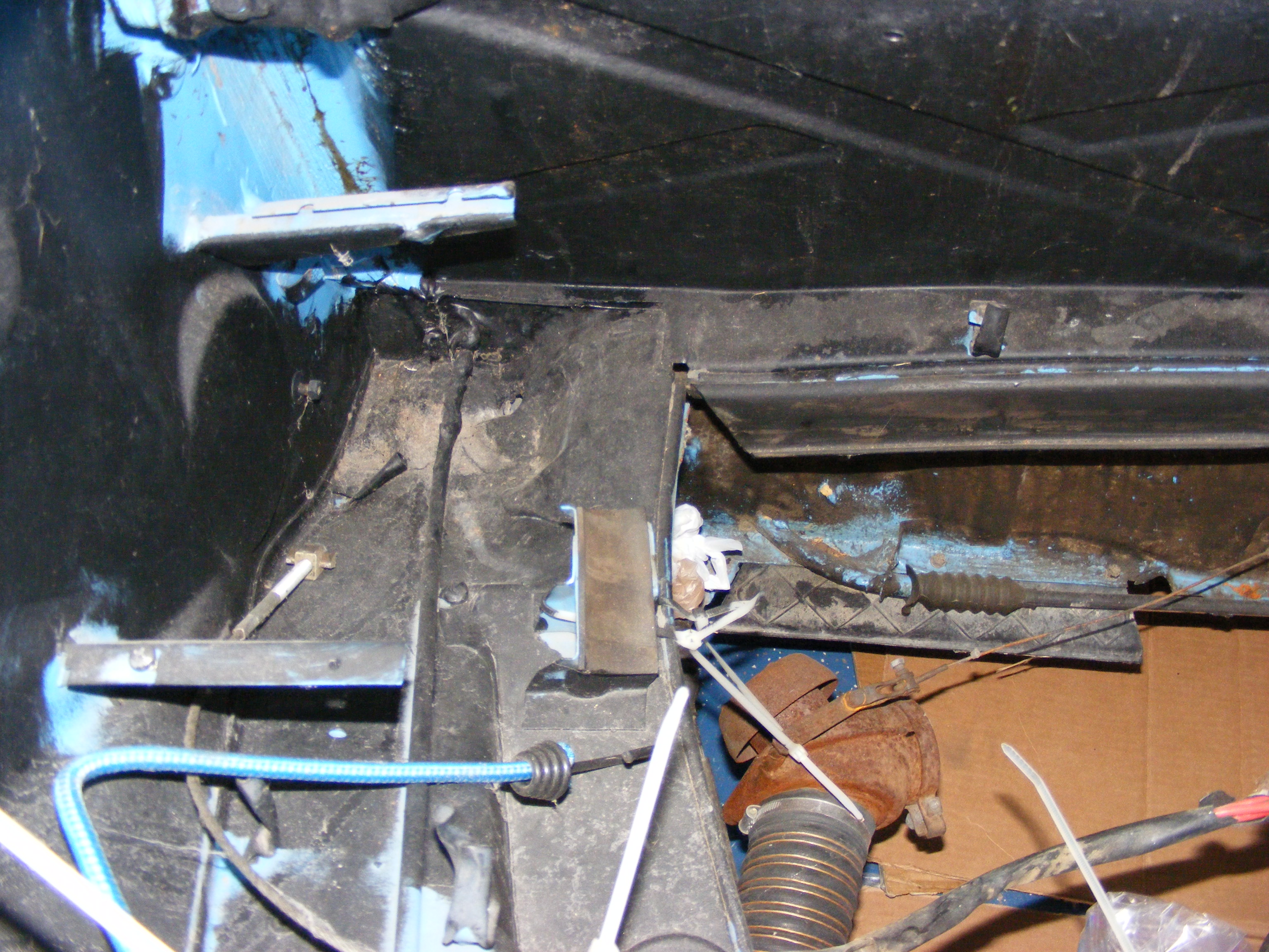

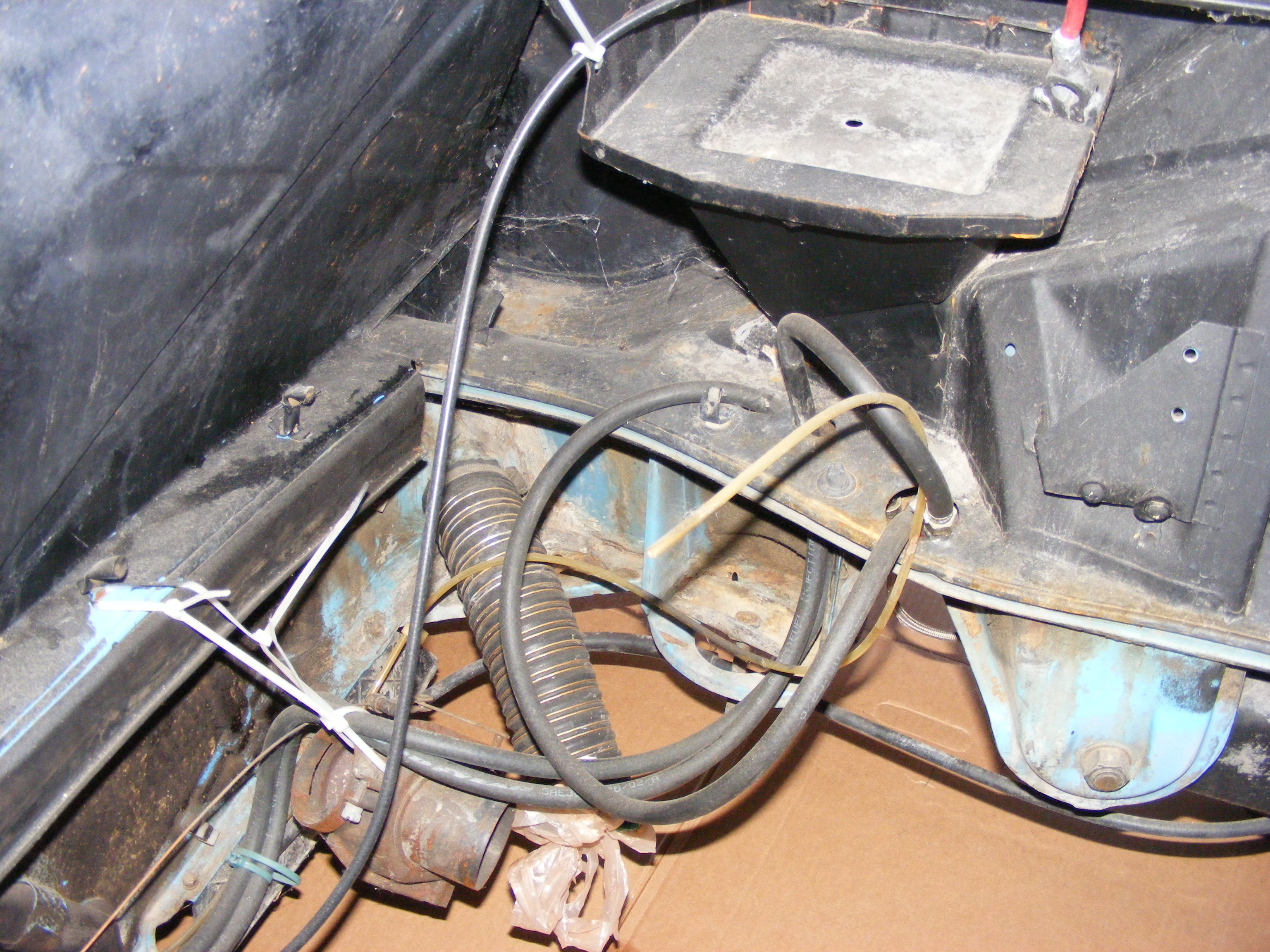

Looks like the hell hole has been worked on (IMG:style_emoticons/default/dry.gif) Possibly on both sides
I take that back. What I thought was weld looks like it might be a cobweb. But what's going on with the firewall in that corner? It looks a bit beat up

Good eye, its just cob webs, put my hand on it and looked it over. Nothing there its all perfect and solid. Maybe whatever was used to paint has a discoloration. Its good. What you think about rear trunk Scott? Are you ready to paint this thing soon? Same color!

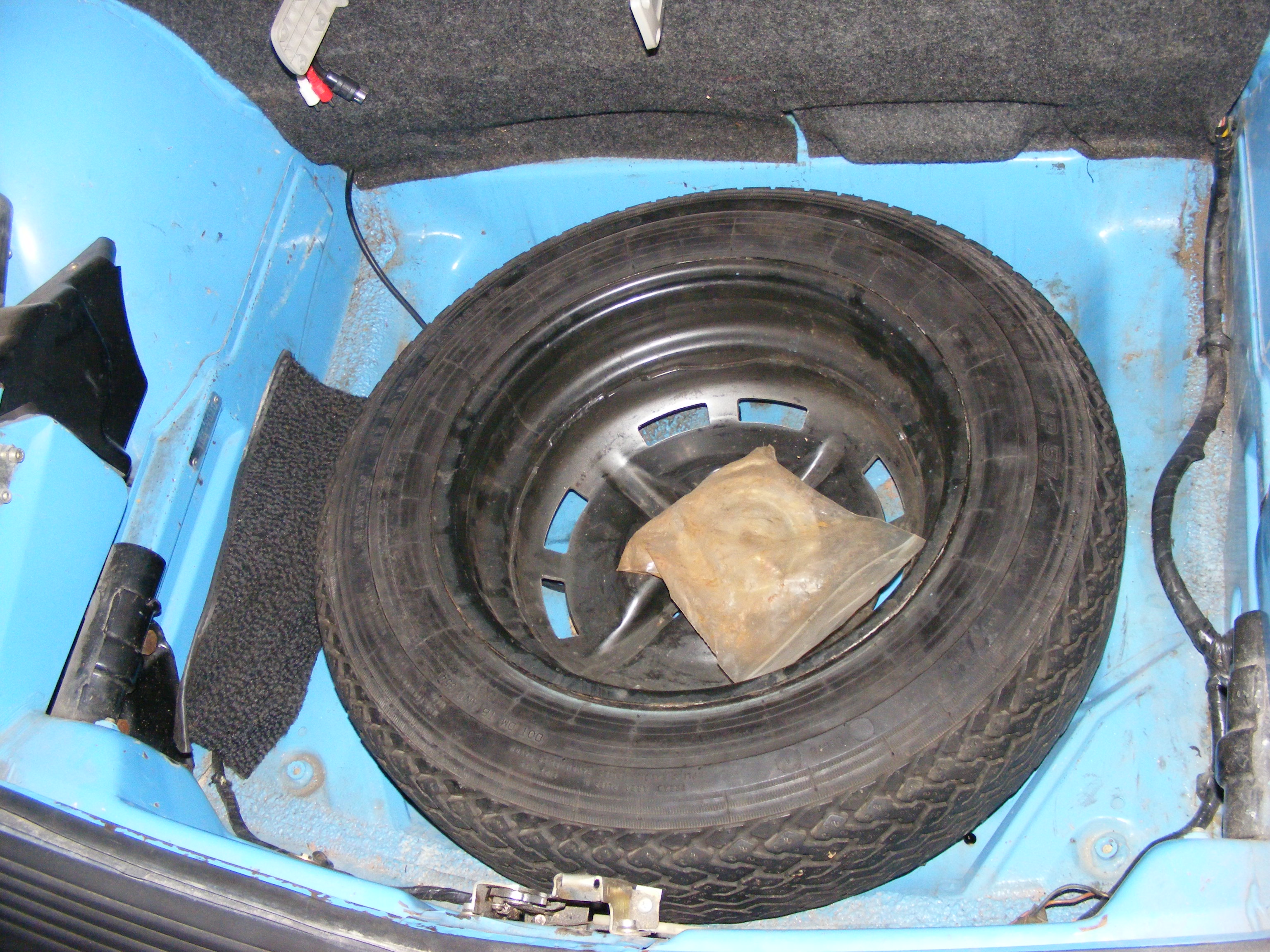

That spare looks like a no/little use factory OE Dunlop SP57, which might be salable to the CW crowd for concours only use, maybe to help offset your resto costs Chris.
(IMG:http://www.914world.com/bbs2/uploads/post-9880-1358612869_thumb.jpg)
Nobody should rely on it as a spare - let alone drive for real on it (maybe on & off the trailer to the concours field).
Clean it & list it with a link from an O&H forum topic to the parts ad.
That area where Scotty circles the firewall in red is worth looking further too, since the OE heat/sound pads made with sisal would hold any moisture that got into the engine bay & "help" the tinworm.
It was worse on the early 914s with the flat bottomed rain trays, which would warp in the heat & then let a waterfall pour onto & behind the pads. My firewall suffered that fate all alone the engine ledge/wall juncture. (IMG:style_emoticons/default/dry.gif)

The firewall is fine, just cob webs and illusion when taking picture.

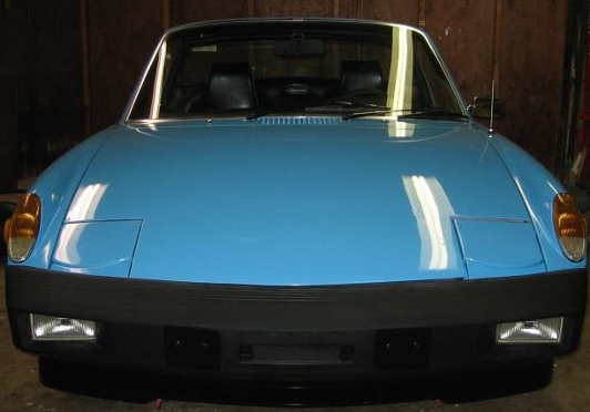

Hey Chris, just FYI & not to muddy the blue waters, but there was also a 70-72 Adriatic Blue which was a bit darker than the Laguna Blue on your 75 (& a lot darker than the 73-74 Olympic Blue) - if it's the lightness of the blue which concerns you?
It would still be a Porsche & 914 blue (non-metallic), if not the original. You can back track on the links below to see the other 914 colors on pix of actual cars.
70-72 Adriatic Blue:
http://p914.com/p914_paint_L50E_70.htm
(IMG:http://www.914world.com/bbs2/uploads_offsite/p914.com-10181-1358793170.1.jpg)
Your 75-76 Laguna Blue:
http://p914.com/p914_paint_L50C_75.htm
(IMG:http://www.914world.com/bbs2/uploads_offsite/p914.com-10181-1358793170.2.jpg)
Looking forward to seeing pix of whatever you decide, after Scotty does his thing!
