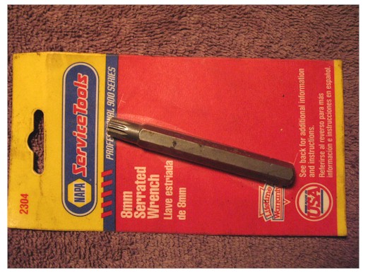

jimkelly
post Jan 24 2013, 05:15 PM
Delaware USA
Posts: 4,969
Joined: 5-August 04
From: Delaware, USA
Member No.: 2,460
pic of napa 12 point
and i squirt some wd40 (tube on can) into each 12 point head to clean them out - make sure 12 point is all the way in (aka: balls deep)
