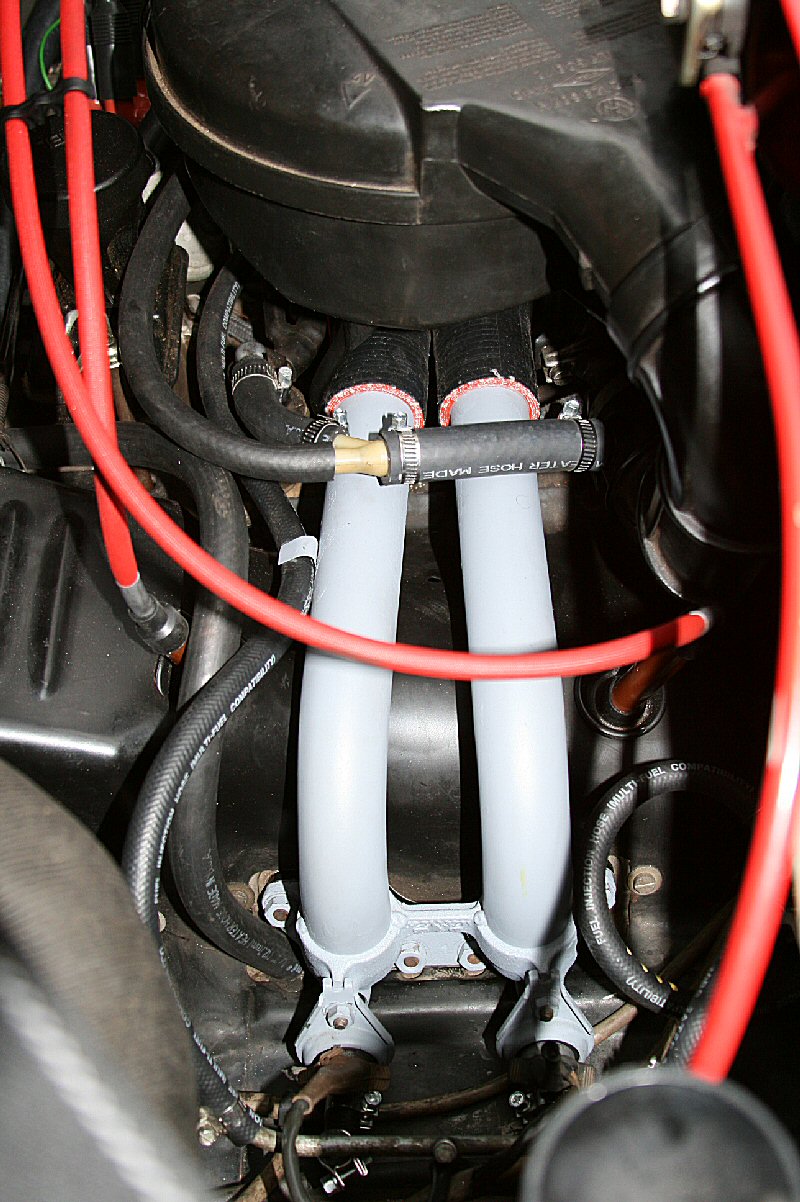

If the intake hoses are 40 years old, they probably need changing. Don't forget the Intake Manifold Gaskets too. Pelican Parts sells both. At least you will eliminate this potential vacuum leak source. Sounds like you are on the hunt. Keep it up, you will eventually find the leak.
While you have the air intakes off, sand and spray paint them. It will really dress up your engine. See picture.

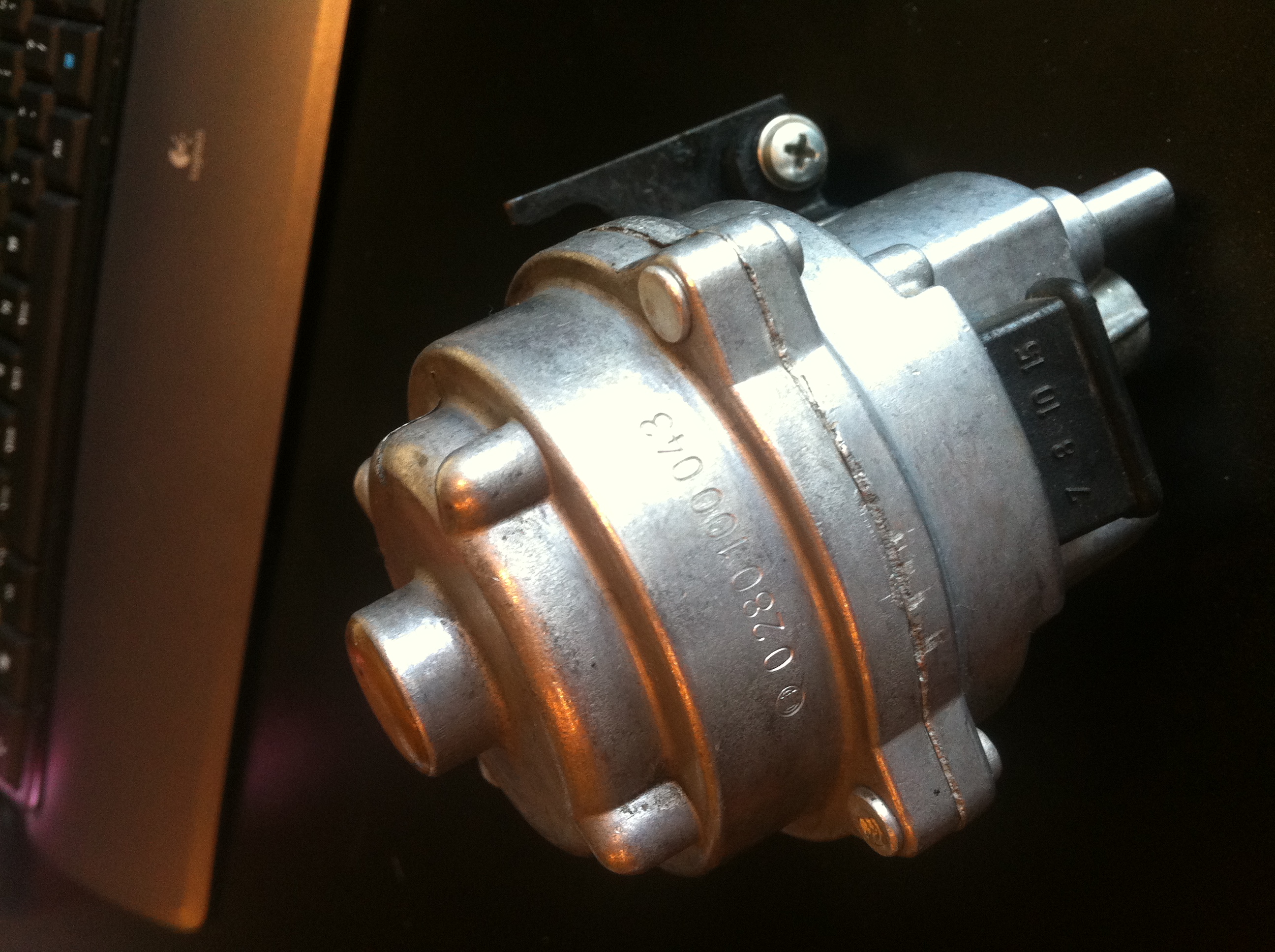

You have a NEW MPS? If so, nice find. If it's a reman then that is another thing. Let's see a pic of the MPS. Also, be sure it is a match to the ECU.

I bought it in Germany at a Volkswagen dealer for 50 Euro. I also found a Bosch tester at a flea market there. I was also told that Volkswagen Classic intends to support the classic car sceen with original Bosch parts. The problem with the remanufactured MPS is probably the adjustment for altitude and density compensation.
