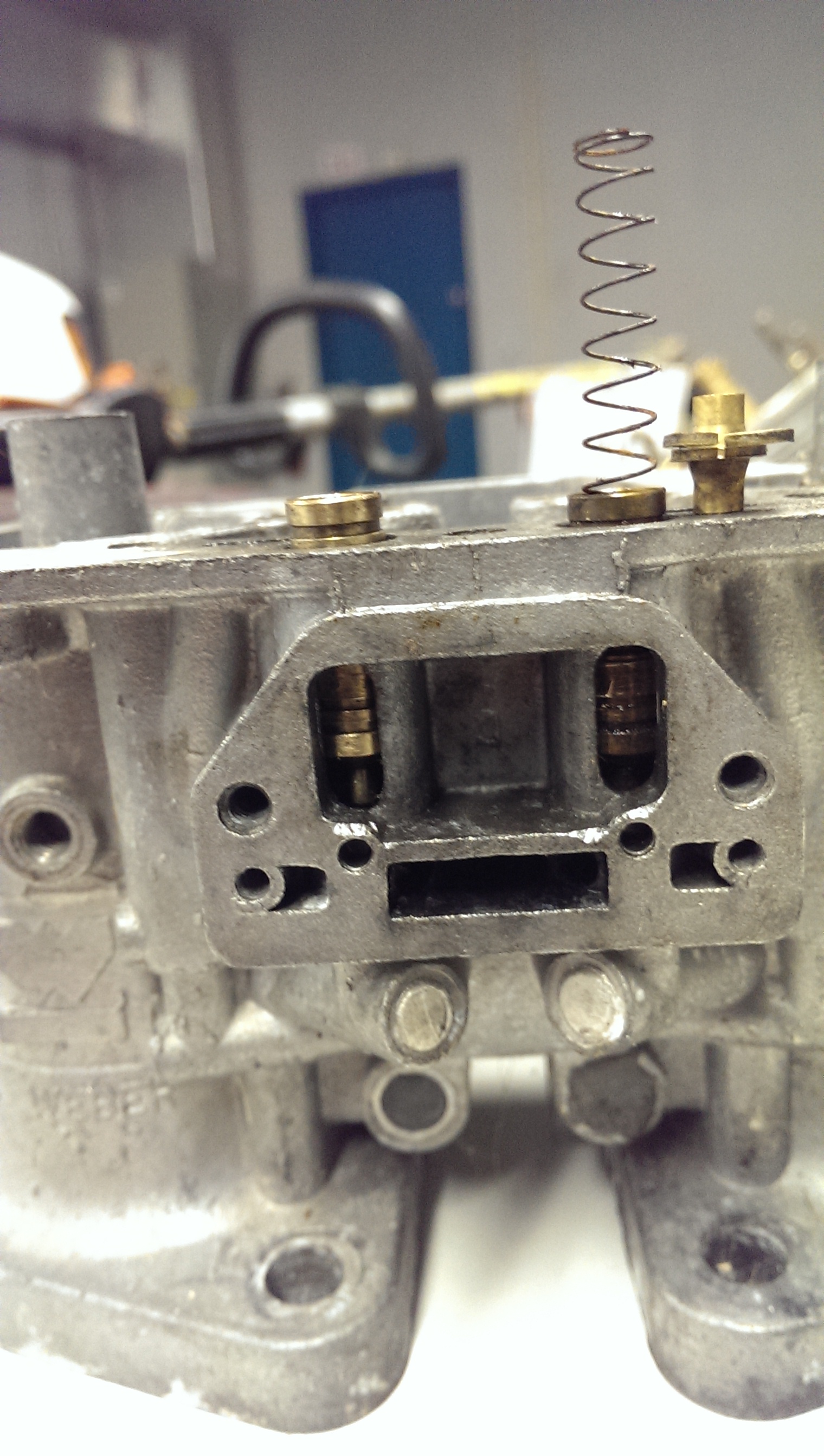

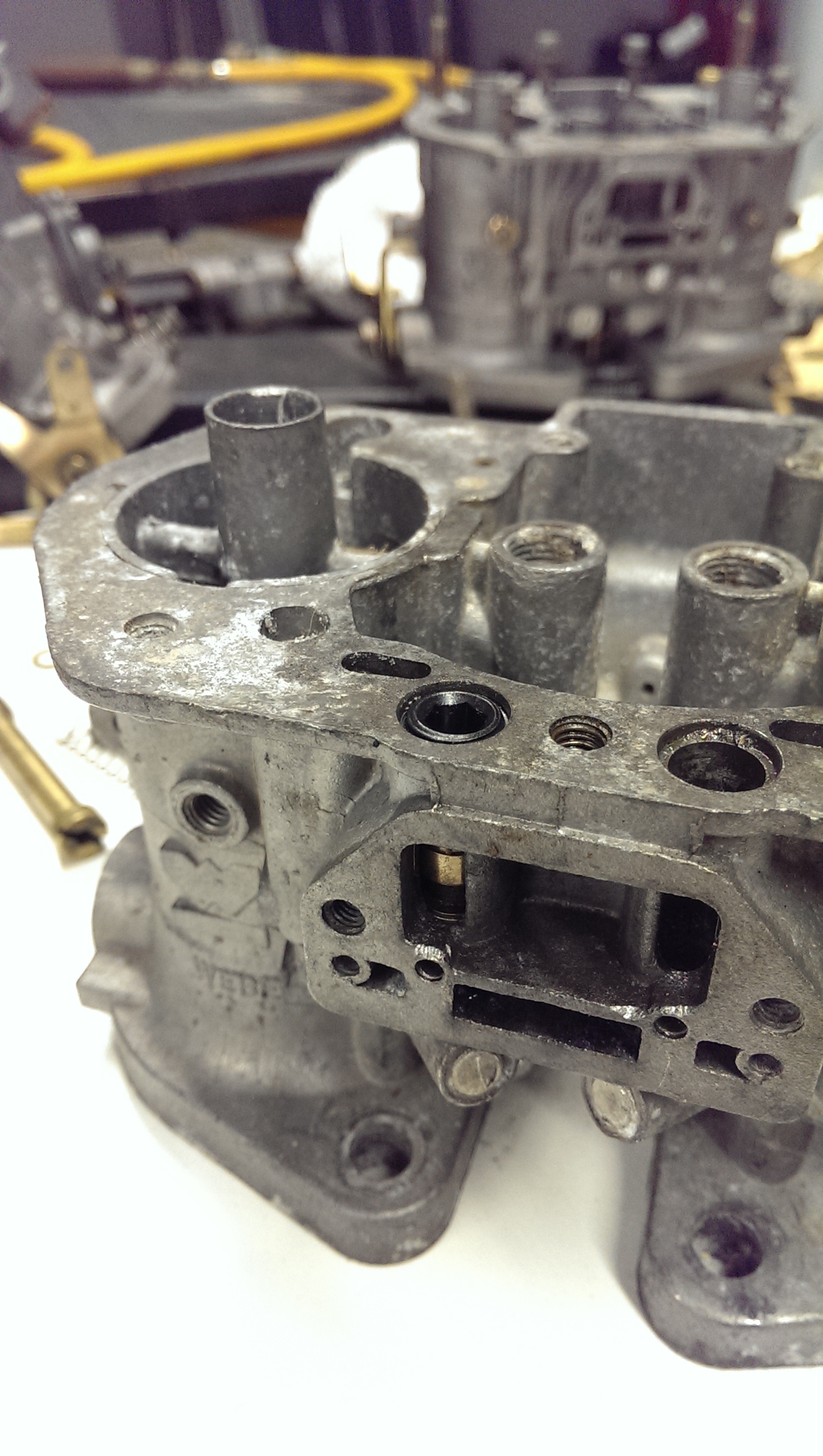

Finishing up where I left off...
Once you have removed the lock washer clip at the top of the enrichment circuit, you can begin to pry up on the enrichment piston bodies. A small screwdriver will suffice, but be careful. Using the body of the carb as a lever is risky and it's easy to break the casting. If it's stuck in there (and it likely will be), you can try to soak the circuit in PB Blaster. If that does not work, a VERY small amount of localized heat may help free up the gummy gasoline that is gluing the piston in it's bore. Of course, be very careful to make sure that any remaining flammable liquids are gone first.
Once removed, clean the pistons and their seats as best as possible.
ThePaintedMan
post Dec 17 2013, 11:59 AM
Posts: 3,887
Joined: 6-September 11
From: St. Petersburg, FL
Member No.: 13,527

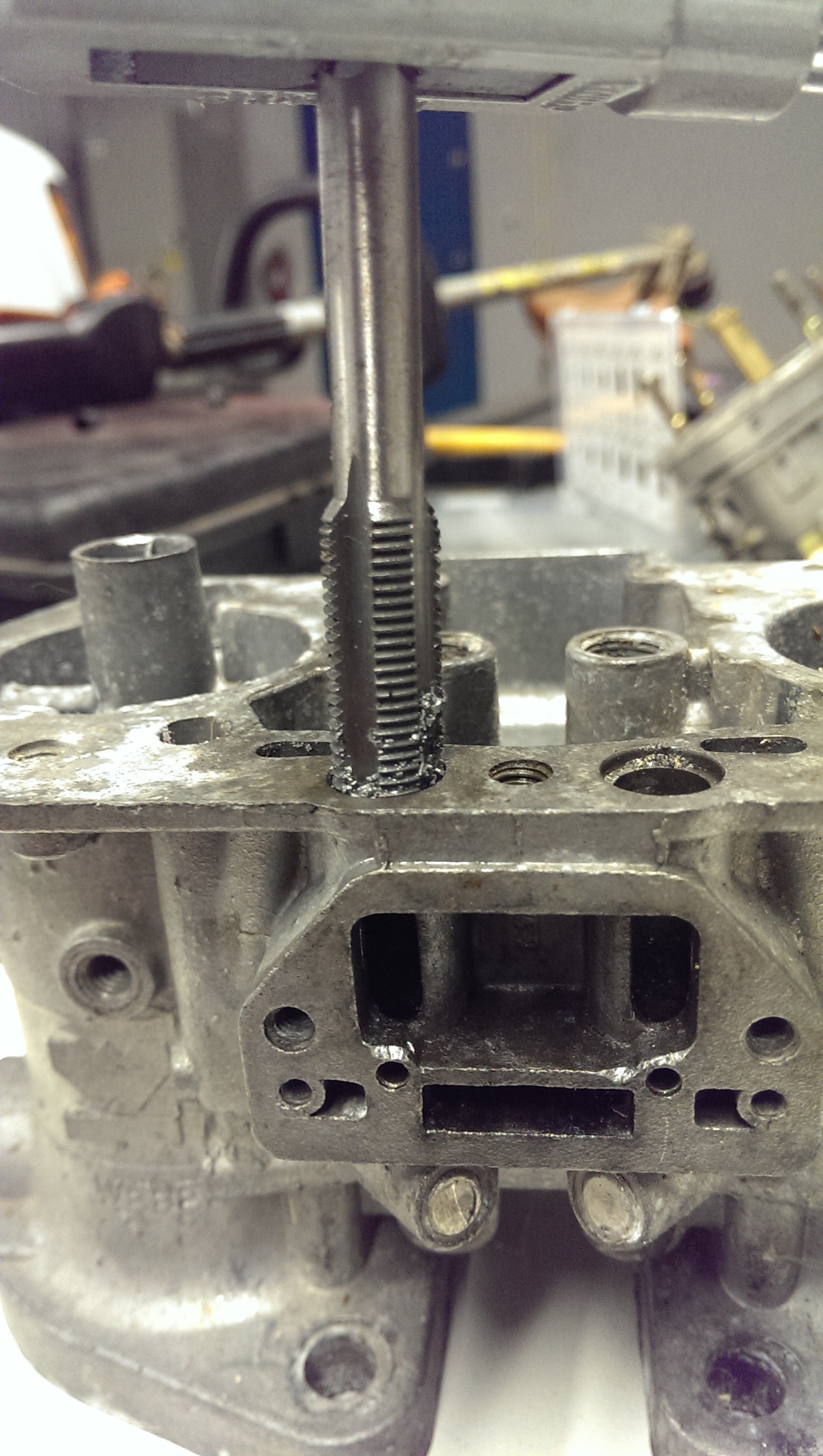

Now you're ready to start tapping. First, plug the bottom of the enrichment orifice to prevent aluminum shavings from falling in. A small piece of paper towel soaked in gear oil works well. This was an old carb body that was cracked, so it is not pictured here.
If available, use a 21/64 drill bit to make it easier for the tap to do it's job. Drill down approximately 3/8 of an inch into the bore. Blow out the bore to remove shavings.
Then, use a sharp 3/8 x 24 fine thread tap, threading approximately 3/8 inch into the bore. A metric tap might work as well, but since these will never need to be removed, I used what was readily available. Go slow and use plenty of cutting oil or gear oil as a substitute. You may wish to stop halfway through to blow out the tap and bore again.

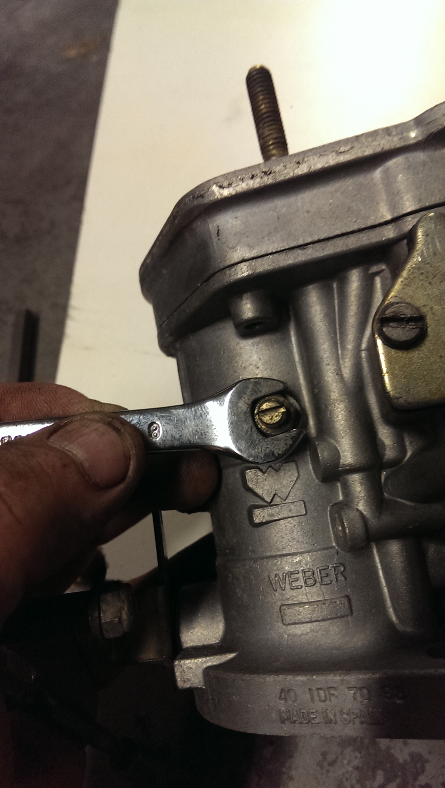

Once both sides are done, remove your packing material from the bore and reinstall the piston. Give it a few light taps to ensure it's seating fully.
Then, install a 3/8 x 24 fine thread grub/set screw. Brass is preferred (thanks Mark Henry) but since these will likely never be removed, steel is also acceptable. Just don't put too much pressure on them.
The set screws should sit below the top of the carb body when properly installed.

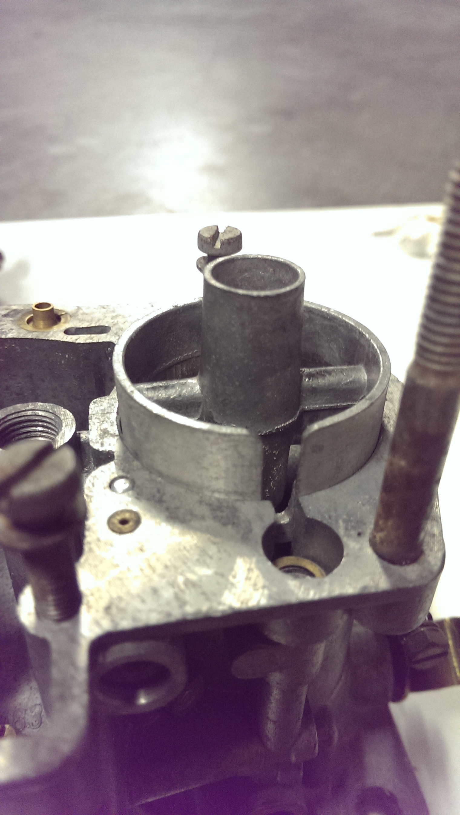

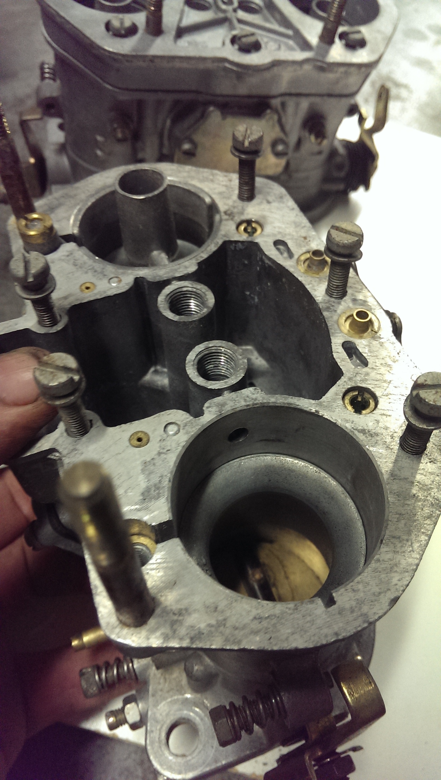

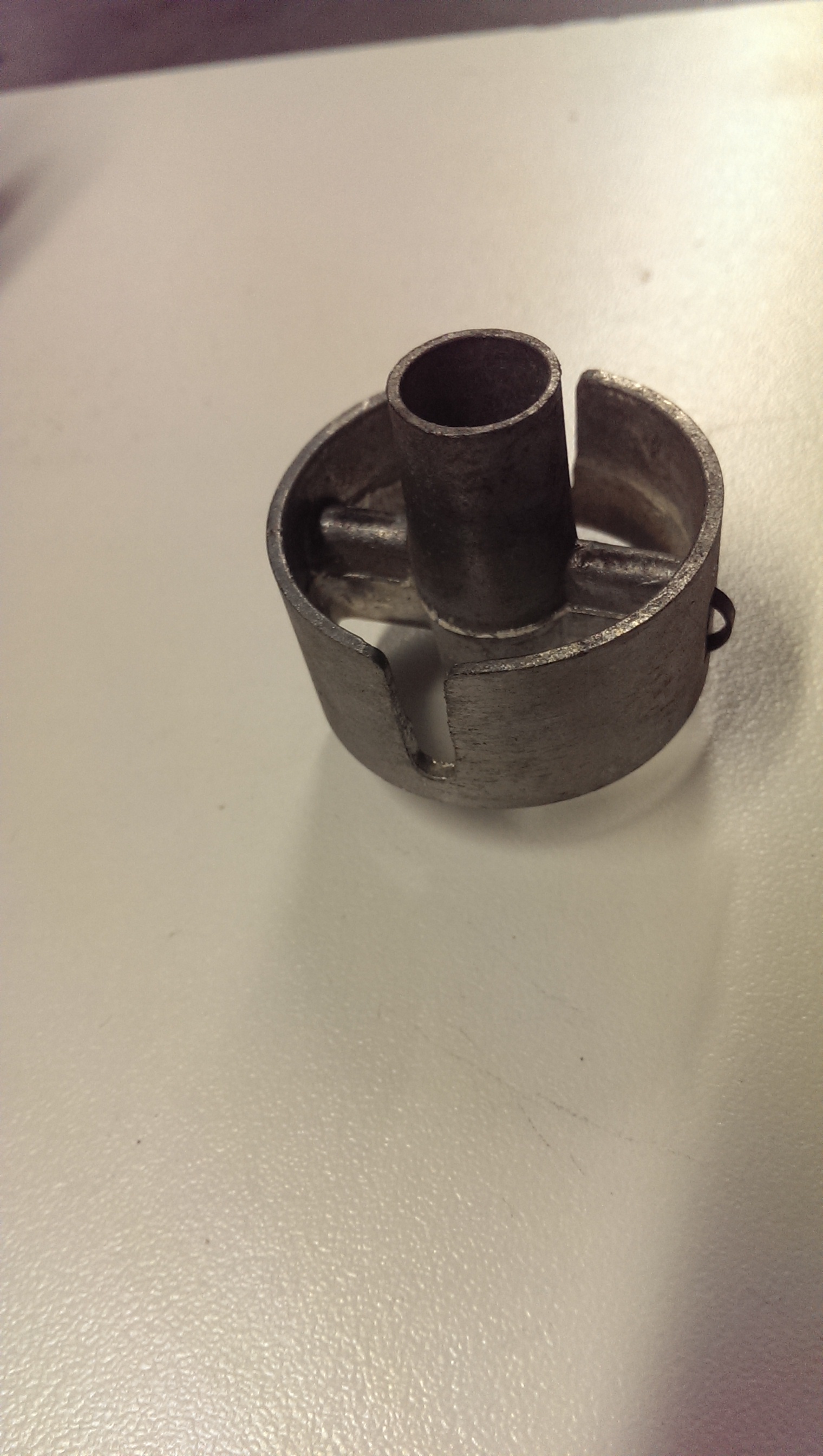

Finally, you should be ready for reassembly. Blow out the carb bodies and bowls well before you start.
First, give the primary venturis/chokes a quick, light sanding on their outer face to remove any gum deposits. Clean them with solvent and install into their respective bores. The numbers should face up.
Install the choke hold down screws on the outside of the carb body with their associated nuts. The venturi will have a small dimple in it which should line up with the screw.
Then install the secondary venturies with the "fat" end of the aerofoil facing up. One side of the venturi will have a retaining spring which should line up with it's small slot in the carb body.
NOTE: If you have the time, you can use a jewelers file and some sandpaper to smooth out any casting imperfections on both the primary and secondary venturis. For most people's uses this will prove unnecessary, but for the racers, every little bit counts. You can see some of the casting remnants below.
