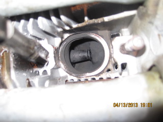

Here's the hole from which the stud pulled out...

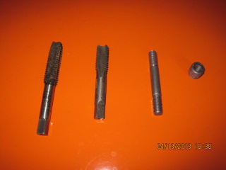

The tools required. Pretty basic- a drill index, a 27/64ths drill bit, ultimately, a 1/2"x13 tap, the same size sawn off to create a bottoming tap, and the EZ Loc.

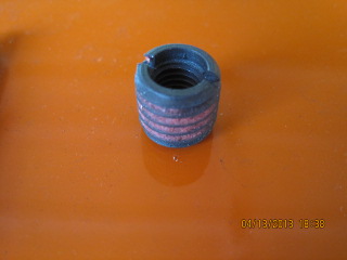

The EZ Loc. Cost about four bucks at Fastenal.

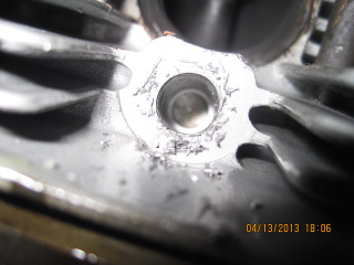

Drilled it out, and tapped it. Then I ran the flat bottomed tap in a bit to make sure there was enough thread to grab...
The EZ Loc screwed right in

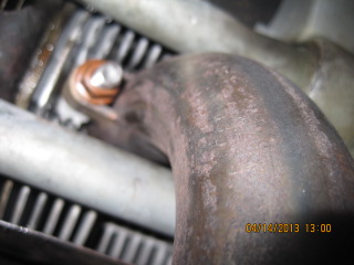

I forgot to take a pic of the stud in the insert. (IMG:style_emoticons/default/wacko.gif) I picked it up at the local Ace hardware. An 8mmx8mm exhaust stud. Cost just over 2 bucks. It had a flat, that would bottom out in the insert, without hitting the head. It was a little longer than the others, but the nut would tighten without any problem. After, reattaching the exchanger went fine.
All went well, the leak is gone.

Is there red locktight on that insert to keep it in place as you tighten or loosen the nut?
Just curious how things stay put.
