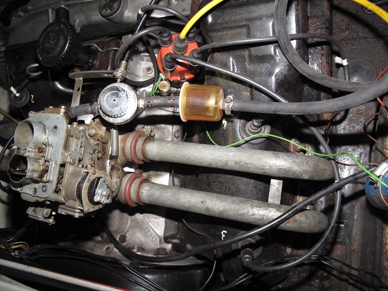

Seems that this year I need to put a little gas into the carb to get the car started initially. I have single Solex carb that no one seems to be able to identify. I'm sure some PO just pulled it off something that was sitting in a junkyard. Once I get car started and it warms up it idles OK but runs rough when you try to drive it. Timing is spot on. Recent (not too many miles ago) tune up with the help of some very knowledgeable 914world brethren. Let’s say it’s a given that there is nothing wrong with the engine. I have an idea of where to go next. I’ve had car for about 7 years. With only what I’ve told you here what’s your opinion?

kg6dxn   If you have to dump gas in it, the throttle pump i...   Apr 28 2013, 09:01 AM
ThePaintedMan   Agree with Mike. If the carb has never been rebuil...   Apr 28 2013, 09:17 AM
angerosa   Yes - I agree. Time for a rebuild. I've had it...   Apr 28 2013, 10:52 AM
rhodyguy   is the one butterfly activated by the what looks l...   Apr 28 2013, 12:00 PM

angerosa   At what point should this cam bracket actuate the ...   Apr 29 2013, 09:01 PM
ThePaintedMan   Assuming it works like every other carb (and physi...   Apr 29 2013, 09:19 PM
angerosa   Assuming it works like every other carb (and phys...   Apr 30 2013, 10:45 AM
ThePaintedMan   So just to confirm... The "at rest" pos...   Apr 30 2013, 10:55 AM
angerosa   So just to confirm... The "at rest" po...   Apr 30 2013, 11:06 AM
kg6dxn   That's a big gap between the cam and pump arm....   Apr 29 2013, 10:18 PM
ThePaintedMan   That's a big gap between the cam and pump arm...   Apr 29 2013, 10:22 PM
angerosa   That's a big gap between the cam and pump ar...   Apr 30 2013, 10:51 AM
angerosa   That's a big gap between the cam and pump arm...   Apr 30 2013, 10:49 AM
kg6dxn   Looks like the arm needs to come way down. Where i...   Apr 29 2013, 10:42 PM
ThePaintedMan   Looks like the arm needs to come way down. Where ...   Apr 29 2013, 10:46 PM
kg6dxn   Looks like the arm needs to come way down. Where...   Apr 29 2013, 11:08 PM

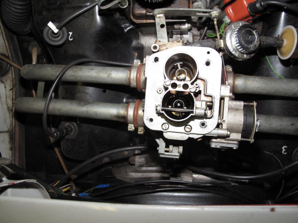

rhodyguy   as he stated, the choke looks to be wired in the p...   Apr 30 2013, 08:46 AM
angerosa   as he stated, the choke looks to be wired in the ...   Apr 30 2013, 10:59 AM
angerosa   Just got off the phone with the carb rebuild kit s...   Apr 30 2013, 03:34 PM
angerosa   So everyone is pointing out this distance that jus...   Apr 30 2013, 08:13 PM
DBCooper   Take off the screws holding in the accelerator pum...   Apr 30 2013, 10:12 PM
ThePaintedMan   Take off the screws holding in the accelerator pu...   May 1 2013, 09:23 AM
angerosa   I will get the accel pump out but can't do it ...   May 1 2013, 11:11 AM
angerosa   latest news. I got the carb kit and what I thought...   May 4 2013, 09:30 AM
angerosa   The story picks up here... So last you knew I was...   May 4 2013, 04:13 PM
kg6dxn   Now you're at the point where you find the ach...   May 4 2013, 04:49 PM
angerosa   Thanks Mike - makes a lot of sense. There is a str...   May 5 2013, 06:33 PM
ThePaintedMan   I agree with what Mike is saying. The longer intak...   May 6 2013, 08:24 AM
