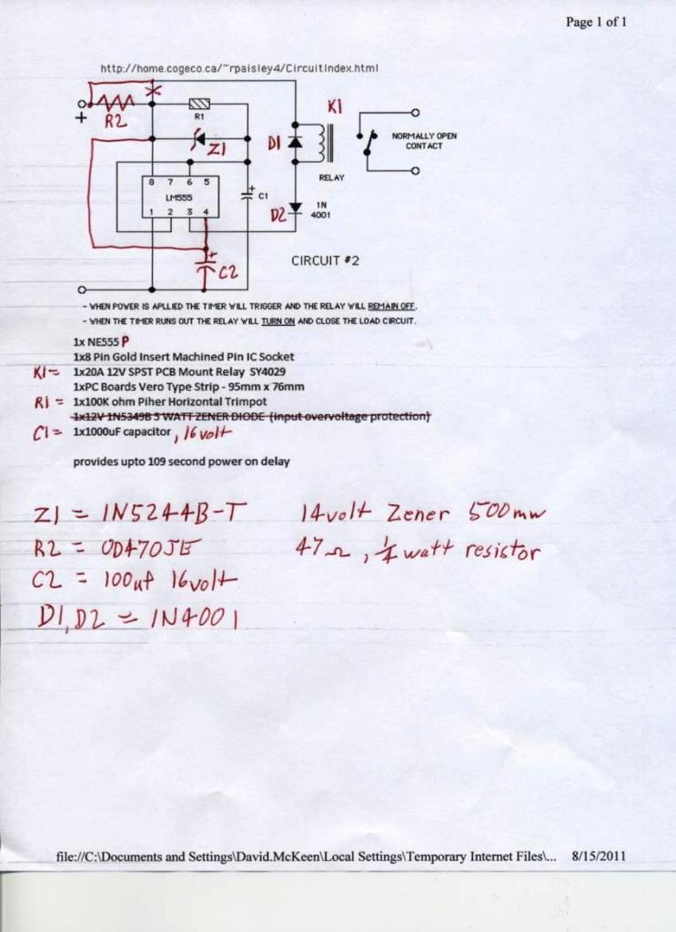

mine would show an error code right after start up. i made a time delay circuit and set it to about 30 seconds after start up. never had the problem again. since then, i have installed the new mtxl and it has been flawless....

no. its not specifically for the lc1. mine was ran off a switched circuit also. one of the guys on the innovate forums designed a time delay circuit and suggested i try it. sure enuff, i built it, installed it, and it worked like a charm.

So am I understanding this correctly- if I put a switch on my current 12v circuit and turn the switch on about 30 seconds after the car is started- this may work? If I understand that correctly- that would be easy enough to try.

EXACTLY! and if it works i will give you the diagram for the time delay. so when you turn the car on, the time delay will turn the lc1 on automaticly. but i would try an ordinary toggle switch for a few days to make sure it solves the problem. i betting it does. fingers crossed....

(IMG:style_emoticons/default/smilie_pokal.gif) Success!!!! The setup works. I am now getting reasonable a/f readings.

thats great!let me look for that diagram and i will post it up. are you good with electronics? do you have a soldering iron? live close to an electronics warehouse? i got all the parts for under 20 dollars and it took a couple of hours to make.

here it is....
(IMG:http://www.914world.com/bbs2/uploads_offsite/i722.photobucket.com-12492-1369879284.1.jpg)
